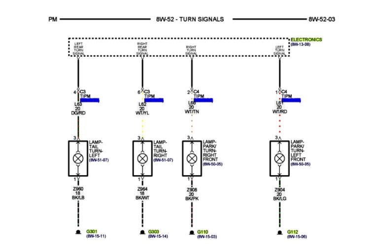

Signal lights and four way in front does work ones in rear do not.
Dec 17, 2017 at 12:03 AM
Check the bulbs to be sure the filaments are not broken.
Check the connector for and damaged pins.
If you have a test light check for power to the socket
Could also be the turn signal switch. I will get a diagram for you.
Dec 17, 2017 at 1:04 AM
Wire diagram. The rear turn signals are powered by the TIPM or totally integrated power module.
