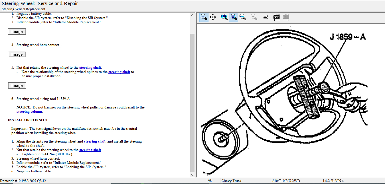

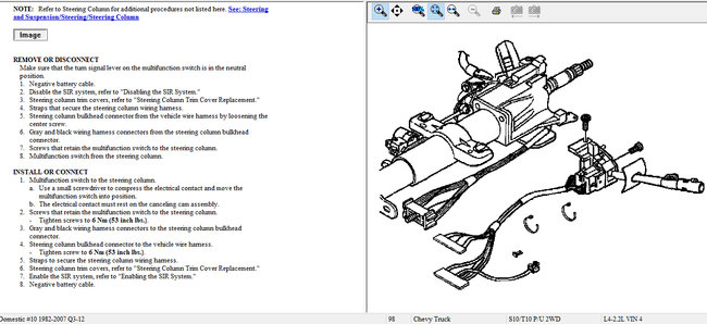

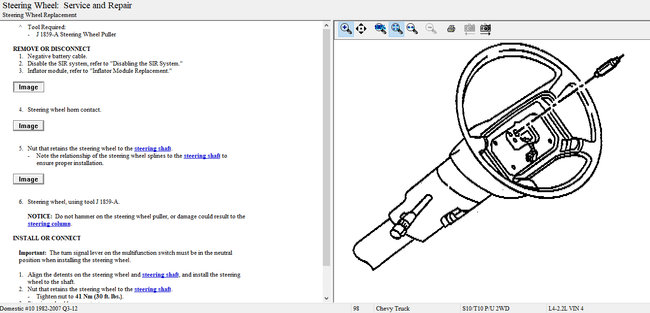

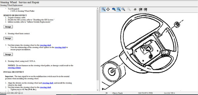

How do I change the signal light lever on the steering column in my truck listed above?
Feb 9, 2021 at 3:15 AM
SEVAG P
  • 405 POSTS
hello,

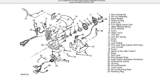

Check the steps below how to replace turn signal switch. first disconnect battery cable. disable air bag system. remove steering wheel. remove knee bolster if necessary. remove bolts and screws and the lower and upper column cover. remove lock cylinder, if necessary, remove wiring harness strap.disconnect steering column electrical connector. disconnect turn signal and multifunction switch gray and black connector. remove turn signal and multifunction switch from the vehicle. check the diagrams below how to remove and reinstall turn signal switch. Check out the diagrams (below). Please let us know if you need anything else to get the problem fixed. thank you.

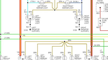

Electrical problem
1995 Chevy S-10 4 cyl Two Wheel Drive Manual

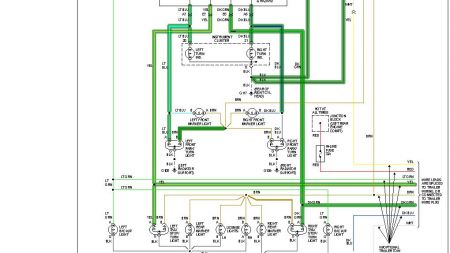

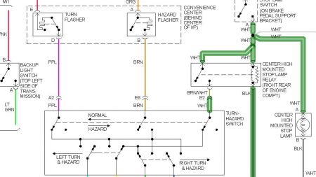

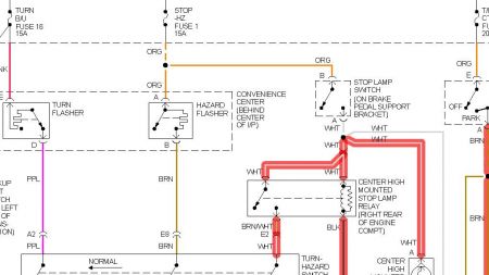

I replaced the signal switch and the turn signals and and back brake lights don't work the high back brake light works i need suggestions on how to run a check on these two systems i checke the ground and relay need help.
Feb 10, 2021 at 1:23 AM (Merged)
  • 75,992 POSTS

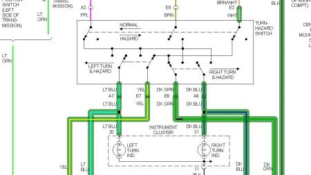

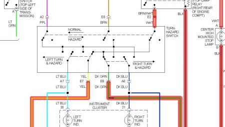

At the turn signal switch connector wires test for power at purple wire while key in On position -you should have battery power. If not replace the trun signal flasher. Also depress the brake pedal and test for power at the switch again -brown and white you should have battery voltage- If the above 2 check outs the turn signal is defective- Double check the turn signal connections- See EWD

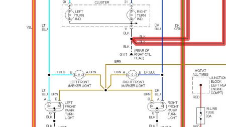

I replaced the turn signal switch now i have no turn signal or back brake lights i checked fuse's i put the old switch back in it does the same i think i have a ground problem the top brake light works i need some idea's on how to check this out any info would be helpful.thanks.
  • 75,992 POSTS
Test the turn and hazard flasher also check ground black wire at rear of right cylinder head. also test the high mount stop relay located at right rear of engine compartment. See below

i replaced signal switch i now have no turn signal and back brake light the high brake light works i checked the ground and relay . i think i have somting that is not connected i have a open con.on left beside next to lt.switch it has purple lt blue lt green grey and black with white stripe wires the lt.blue wire is hot at all times i see no connection.i need help what can i do.
Feb 10, 2021 at 1:24 AM (Merged)
BLACKOP555
  • 10,386 POSTS
try a new switch, it sounds like it hasnt been hooked up properly or the switch is bad, go back and retrace. if you post back ill try to find you a wiring diagram for it.

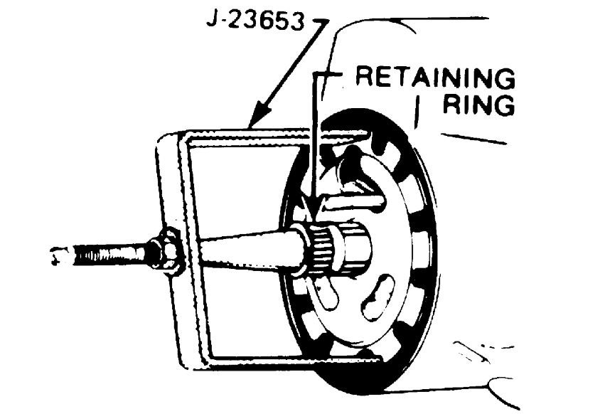

Good evening,
I attached the procedure below for you with a picture for you to view.
1. Disconnect battery ground cable.
2. Remove steering wheel.
WARNING: Refer to Air Bags and Seat Belts/ Air Bags (Supplemental Restraint Systems)/ Service and Repair/ Air Bag System Disarming & Arming.
3. Using a screwdriver, pry cover from lock plate.
4. Using lock plate compressing tool No. J-23653, or equivalent, remove lock plate as follows:
a. Compress lock plate and pry retaining ring from groove on shaft, Fig. 5.
b. Slowly release lock plate compressing tool, then remove tool and lock plate from shaft end.
5. Slide canceling cam and upper bearing preload spring from end of shaft.
6. Remove turn signal (multi-function) lever.
7. Remove hazard warning knob retaining screw, button, spring and knob.
8. Remove pivot arm.
9. Remove switch retaining screws and pull switch up from column, guiding wire harness through column.
10. Reverse procedure to install.

SMITHS2
I replaced the turn signal switch. I then tried to replace the metal pllate and lock ring but was unable to do that . Is there a special tool to compress the spring to replace the metal plate and lock ring.
CARADIODOC
  • 34,367 POSTS
Yup. It's a threaded tube that screws onto the steering shaft. That tube is threaded on the other end. A nut is tightened to push a metal strap down. The strap pushes on two sides of the plate to allow you to remove and install the locking wire ring. Some auto parts stores borrow or rent tools like this. Most mechanics have this tool too. You might find one who will borrow his to you in exchange for some cookies. (Chocolate chip)!
caradiodoc
  • 75,992 POSTS
The tool you looking for is J-2927
