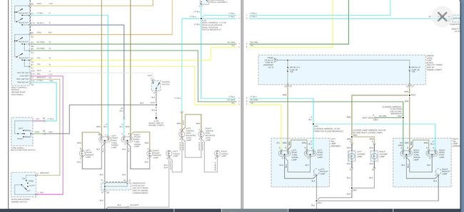

The ones in the front work but the indicators on the dash don't work either. I have checked the fuses and they are fine. Are there any relays within the fuse box that could cause this problem? I have researched a bit and it seems that it would be the flasher relay. But as I research more I'm hearing/seeing that there isn't a flasher relay and the body control module is responsible for the flashers.
Mar 23, 2019 at 6:25 AM
Good afternoon,

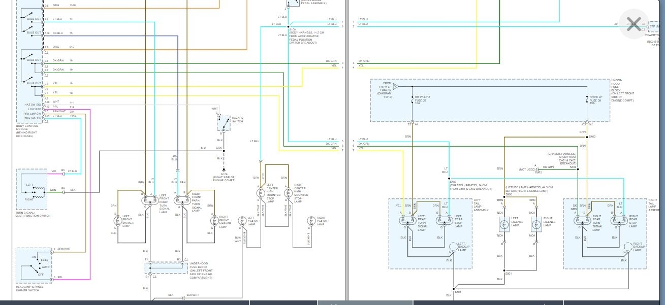

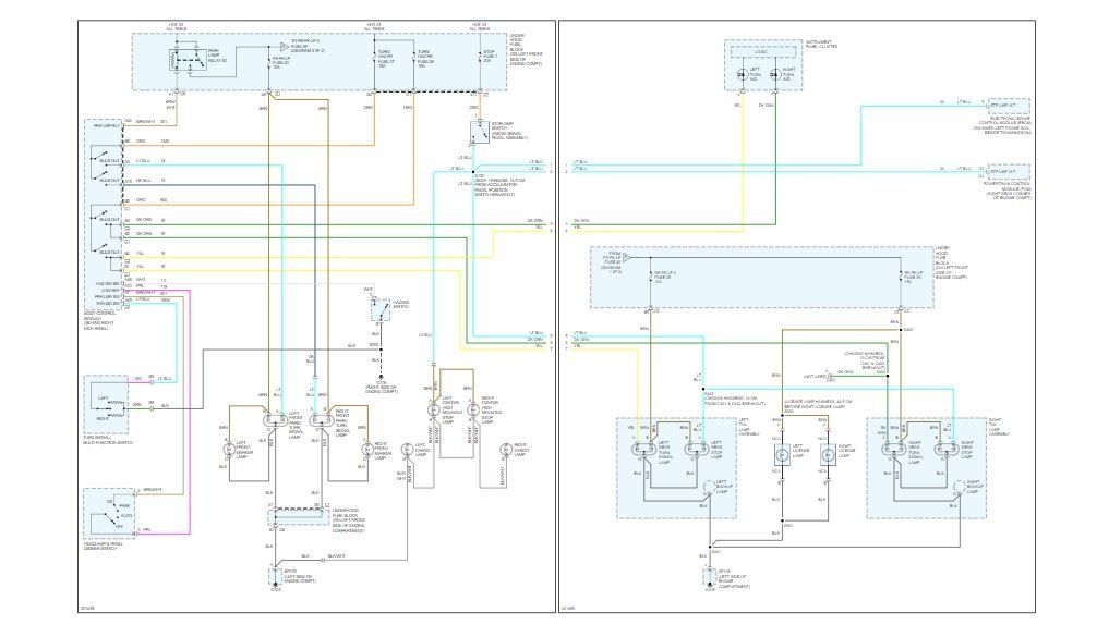

Make sure there is power on both sides of the fuse for the rear lights as in the diagram.
I attached a diagram for you. The power is controlled by both the body control module and the turn signal switch.
