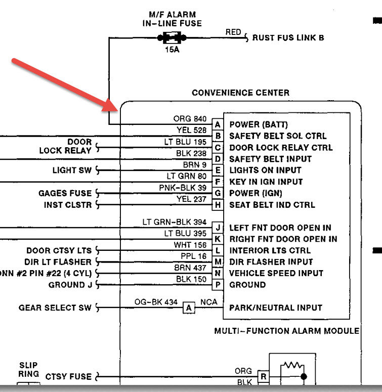

I'm having trouble with my blinkers sometimes they work and not I can see them blinking in the inside but not on the outside my hazard does the same my brake lights don't come on at all changed bulbs but still won't come on

it may be the alarm module in convience center also check flasher on rh side of dash behind fuse box.
