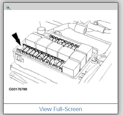

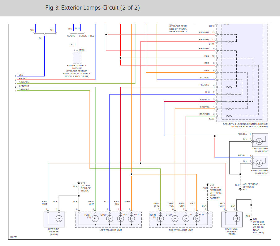

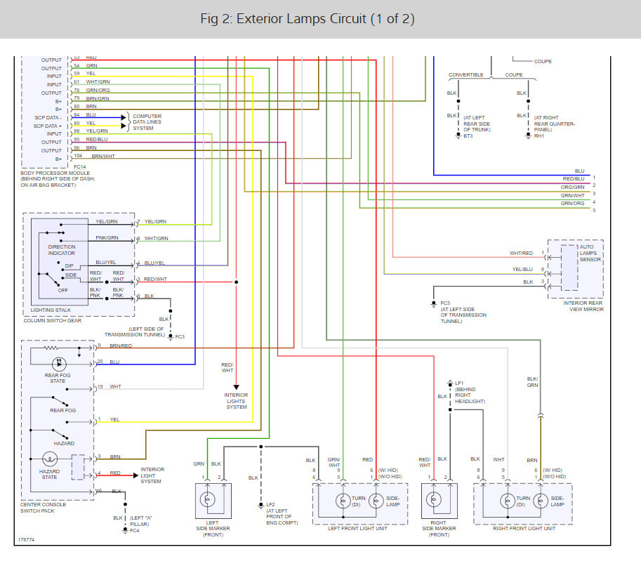

Side marker lights and fogs lights are not working
2004 JAGUAR XJ8
140,000 MILES • 4.3L • V8 • 2WD • AUTOMATIC
GREENXJ8
But all other lights work. fuses are good, relays good.
Sep 5, 2019 at 4:56 AM
  • 55,325 POSTS

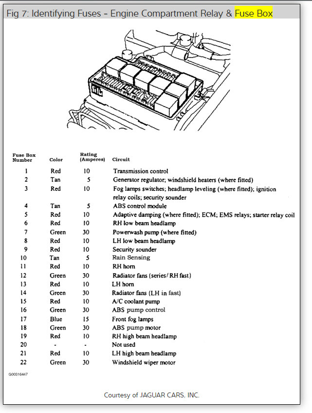

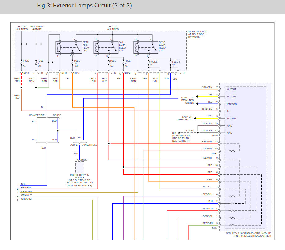

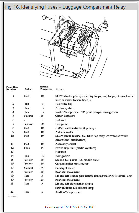

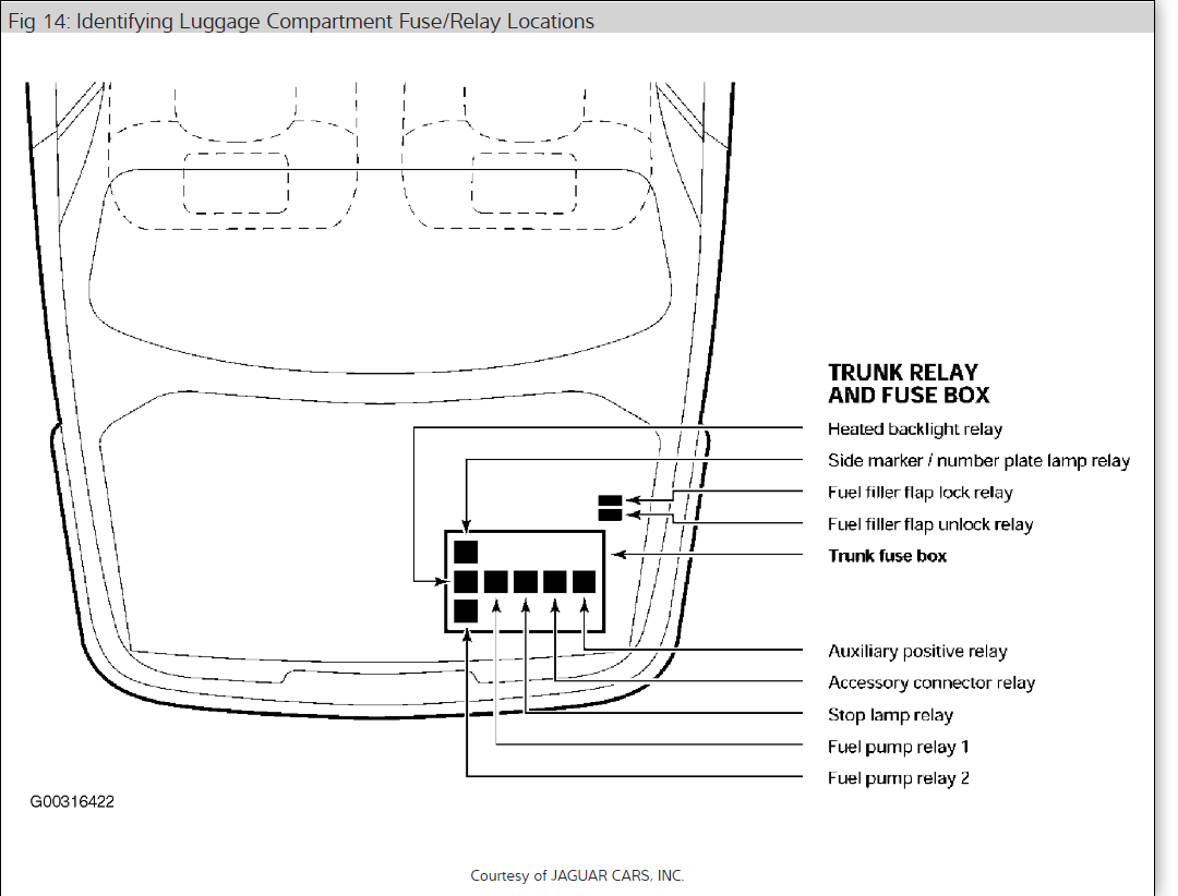

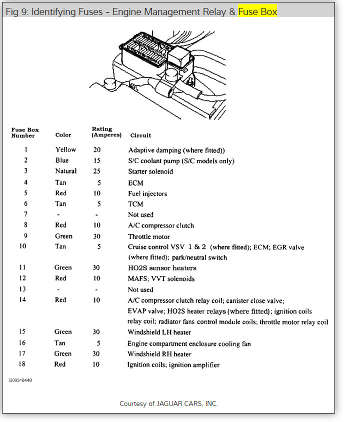

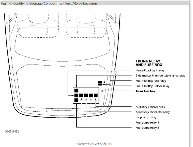

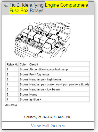

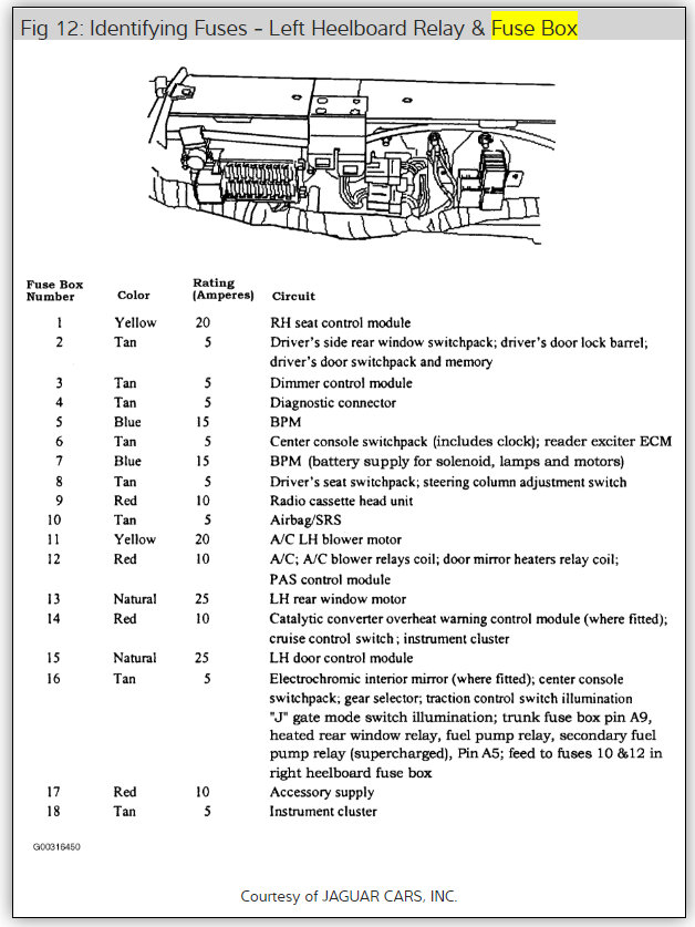

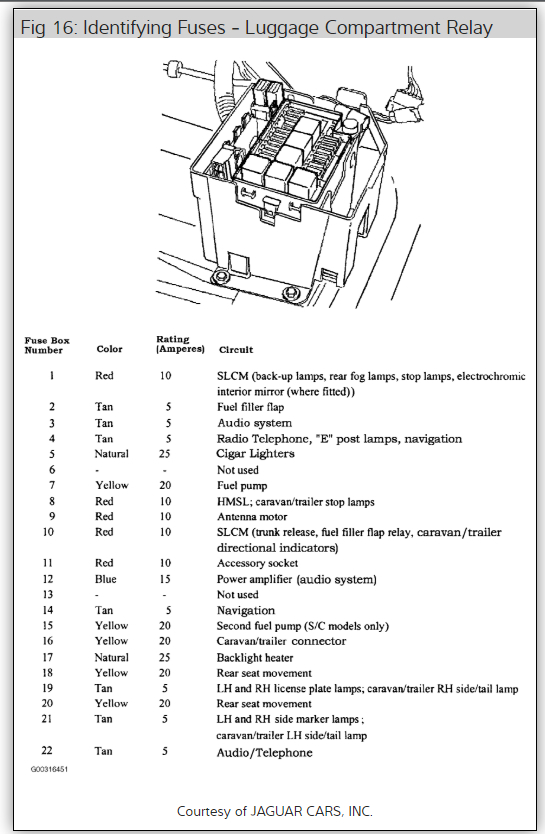

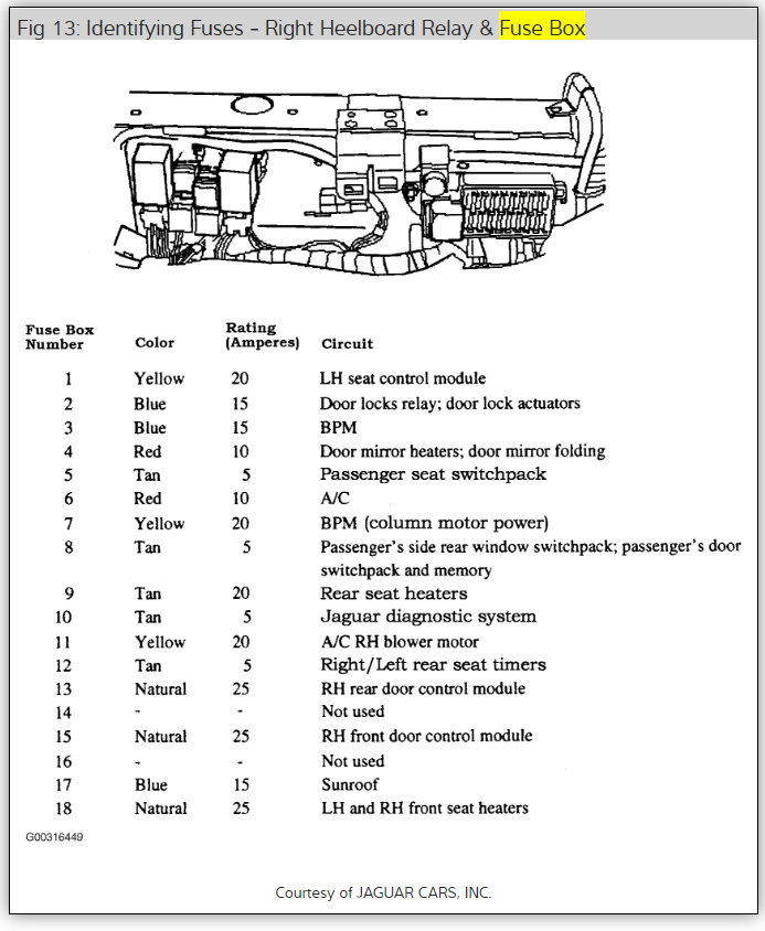

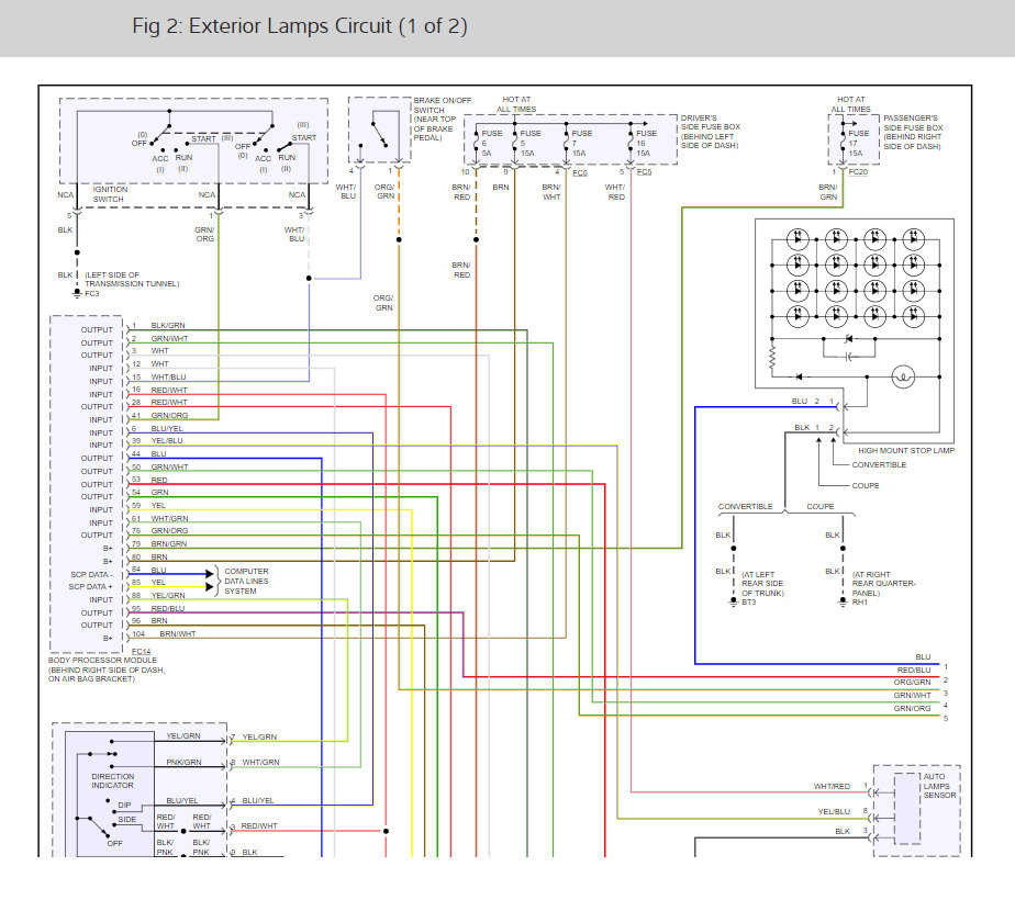

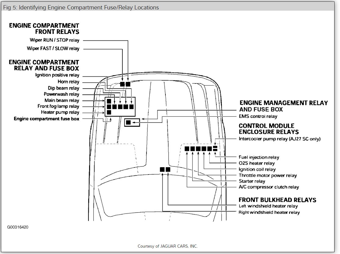

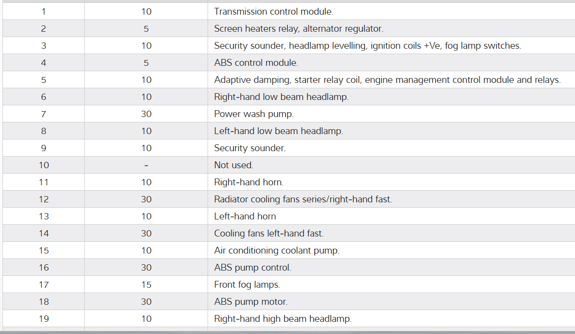

There are a hand fuse of fuses and relays that run the system we should check the fuses first. here are the wiring diagrams so you can see how the system works and which fuses and relays to check:
and
