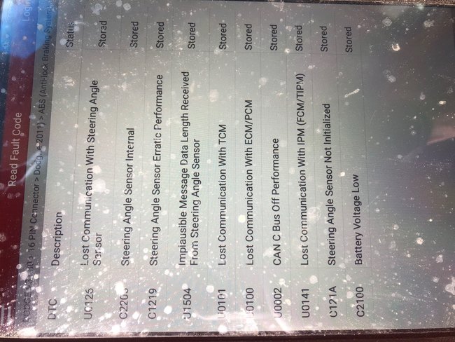

I went home after the alignment with the BAS ESP still on. Scanned it and there were a bunch of course. Deleted them and did a SAS calibration and all is good for now. Will monitor it. I noticed the car has hard time starting first time you try to start it, this started 4 days ago. it will turn over and not start then start second time, volts is good around 13.95 or 14.xx..

codes before.
Apr 3, 2020 at 3:53 AM
Thanks.
Make sure the battery cables are clean and tight. The low voltage code may be the root cause of all the codes.
