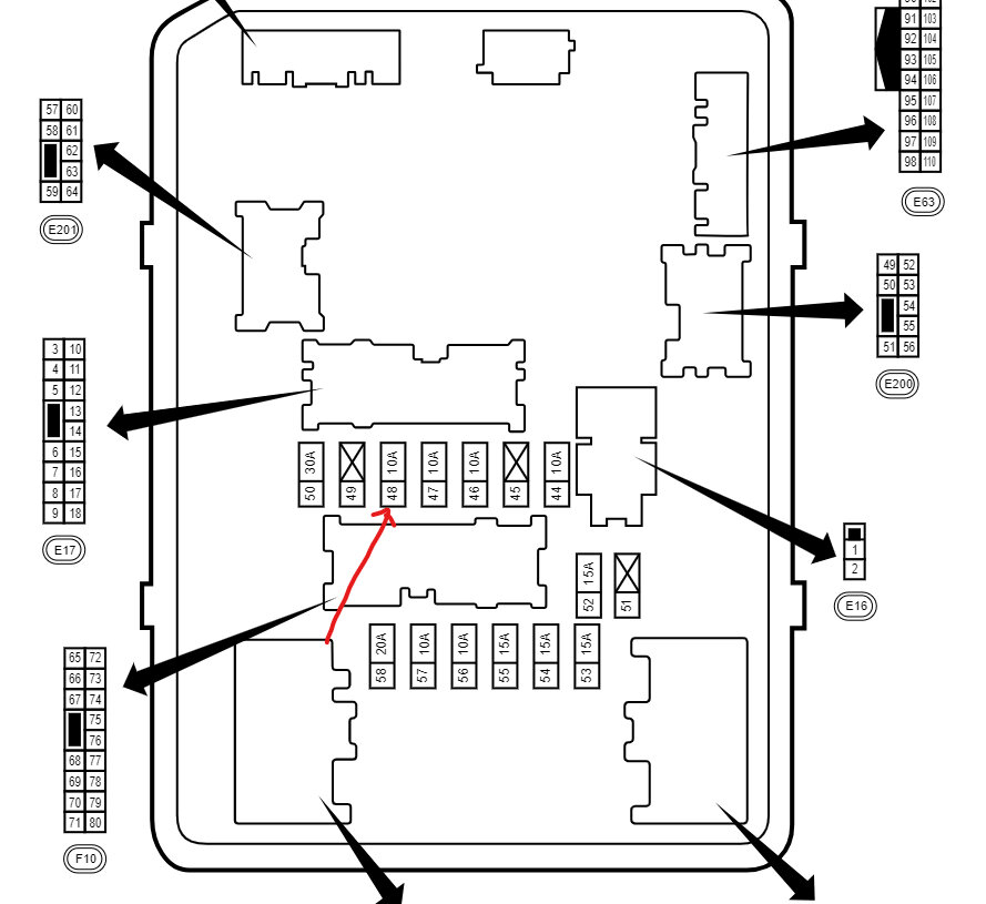

I am trying to find out which fuse controls the active shutter grille.

Fuse #48 in the IPDM under the hood. Here is a guide to help you test it:
Check out the images (below). Please let us know if you need anything else to get the problem fixed.
