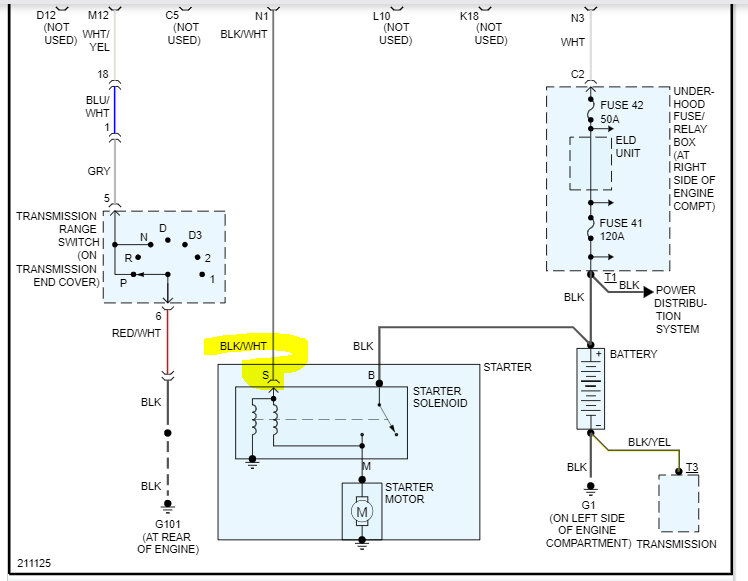

Last week my truck shut off while sitting at a light. So, my first guess is battery. Bought a new battery and was told alternator was fine. Next day the same issue shuts off while at a light. Got worse from there. Next day it stalls to crank and after a few tries it does eventually crank but only drives for a few minutes then shuts off. Then must sit and cool for a good 30 minutes before it cranks back up. Checked the oil it was empty although the oil light never came on and didn't smoke any. So put in four quarts. No lights on, not running hot. I was told the fuel pump, so I bought one and had it out in. And still same issue. Stalls then only goes for few minutes then shuts off then has to sit before it cranks back up.

Now it's not starting at all. Doesn't make any sounds. Lights and all come on but truck is doing absolutely nothing else. Fuses are all good. Tried to jump didn't do anything.

If you have nothing, I need you to check a few things. First, you will need a helper.
At the starter motor, there will be a heavy gauge solid black wire. That wire should have 12v at all times directly from the battery. Confirm that is present.
Next, there is a smaller gauge wire that is black with a white tracer. That wire should only have power when the key is in the start position. Have your helper turn the key to the start position while you check the smaller wire for power.
If the smaller wire does get power with the key in the start position, replace the starter. If it doesn't, let me know. I will walk you through the circuit so we can check for power and ground starting at the starter cut relay.
See pic below. It shows the wires at the starter.
