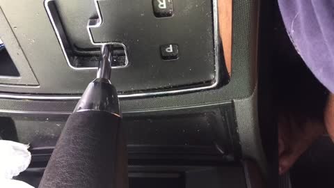

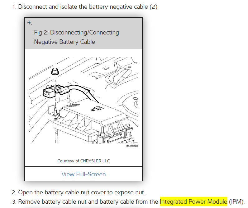

I’ve had AutoZone check alternator and battery, both excellent. However the car shuts down completely while driving, then will not turnover again without a jump. The inner lights would begin dimming til all inside becomes pitch black, headlights go out, then car shuts completely down. Trouble Codes are 0622, 0562, 2503, 0571.
Jul 20, 2019 at 1:53 AM
  • 55,399 POSTS

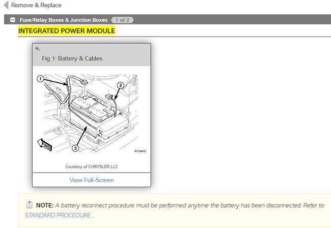

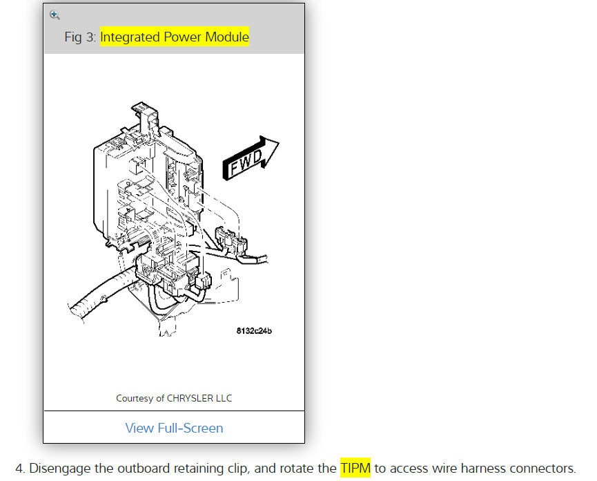

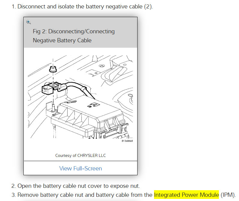

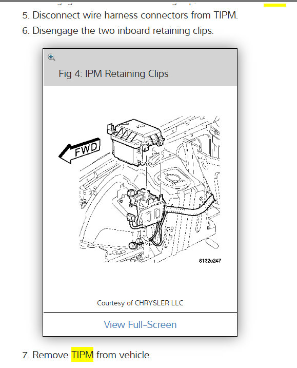

This is common when the TIPM goes out here are instructions and diagrams on how to fix it which is easy because the unit self initializes. Can you please shoot a quick video with your phone so we can see what's going on, that would be great. You can upload it here with your response. Check out the diagrams (below). Please let us know what happens.

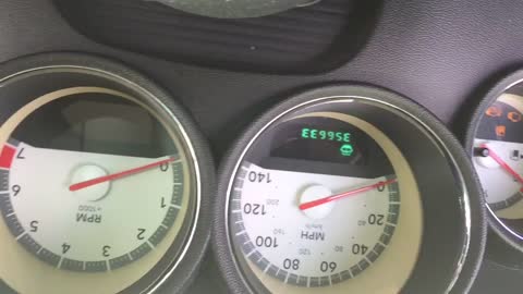

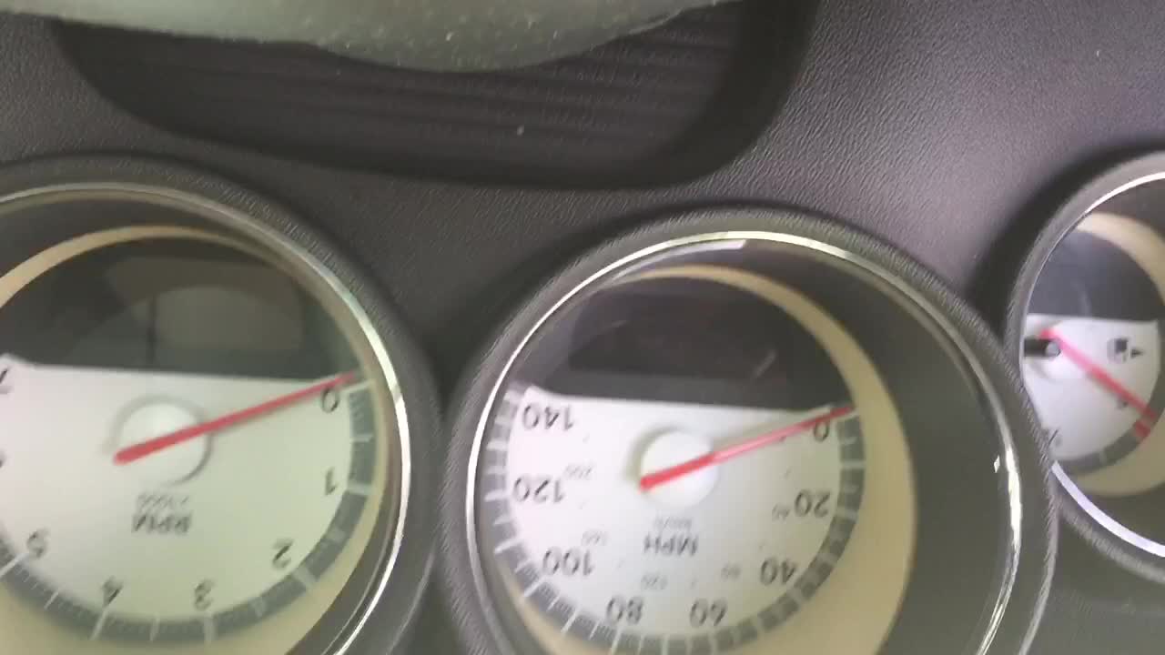

The additional codes are gone. Only the 0622 code remains. Now the rpm gauge is doing its own thing. It revvs itself at a tap of the gas and continues after removal of toe.
Jul 24, 2019 at 6:38 AM
  • 55,399 POSTS
Yep this is typical of the TIPM going out. I would get a new one and install it. Please let me know.
