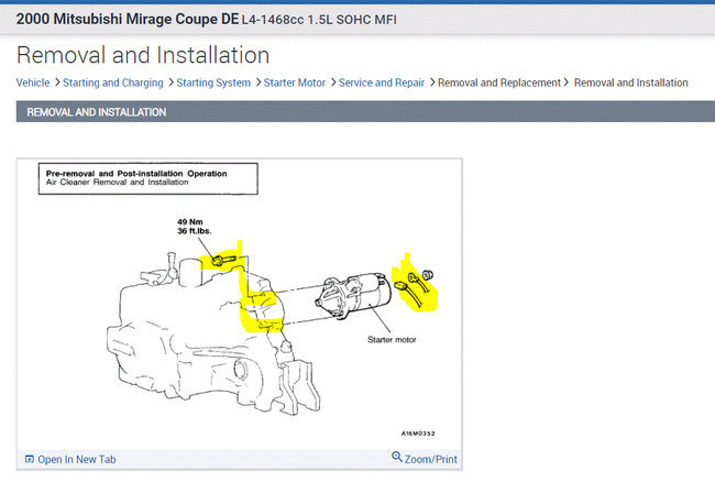

Now the starter is not hard to replace. I just looked at my manual's directions and they are extremely vague. So first, take a look through this link. It explains in general how the procedure is done.
If you look at the pic below, those are the directions I have. LOL There isn't much to go on. However, what you will need to do is this. First and very important, disconnect the negative battery terminal before working on the starter.
Next, you will need to remove the air filter and filter box. The starter is below it. Once you get that removed, disconnect the wires to the starter (carefully) and then remove the two bolts holding the starter in place. When you reinstall, it is basically the reverse procedure. However, when you connect the wires to the new starter, make sure they are not in any way touching each other. If they are, the starter will engage as soon as you connect the battery and not turn off until the battery is disconnected.

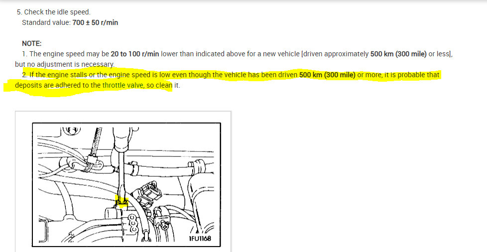

On the IAC - the car has been strange for some time and while hard to explain...the idle is rarely correct until it runs for a moment. turn on the AC and it will race and idle down to normal again. A/C on and then put in drive, it will idle down to around 350rpm and then work its way back to normal again, around 800 to 850 RPMs.
Would a throttle body go bad. I have removed and cleaned it before.

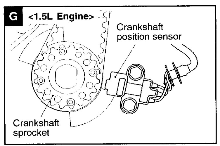

You have anything that shows what I need to remove to replace that thing?
the service manuals I have are pretty sad in that area.
Thanks
Dec 27, 2023 at 3:55 PM
  • 110,251 POSTS

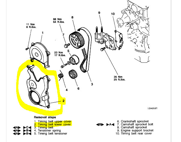

My manual is the same on this vehicle. If I am looking at it correctly, the lower timing belt cover needs to be removed. See pic 1 below.
Pic 2, shows the lower cover I am referring to. If that needs to be removed, the crankshaft pulley needs removed first.
Before you remove the cover, confirm it is required. The labor is showing nearly 2 hours if it has AC, so that sounds like it needs to be removed.
Let me know if this helps.

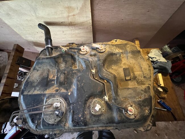

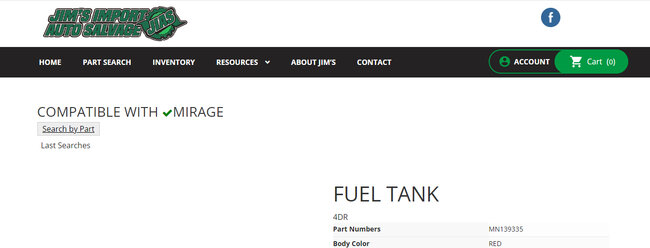

Pulled the tank out today, Sat 1/27/24 again and I am going to test it before putting it back in this time. I was pretty confident it was sealed last time, but as mentioned...forgot to do a step...oh well...so it goes huh...LOL

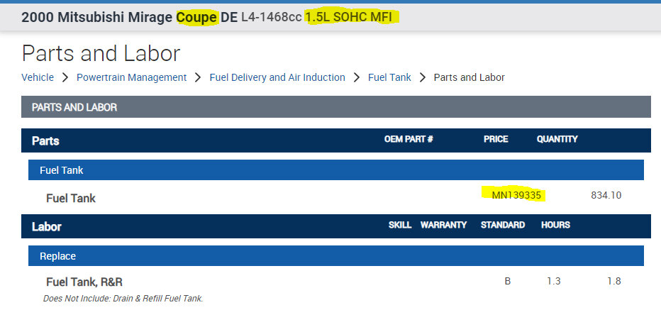

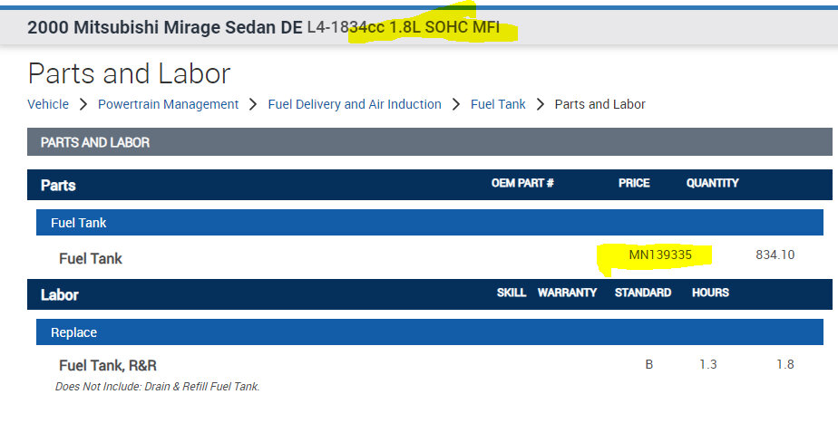

Anyway, would you have a part number for this tank, see pic.
2000 Mitsubishi Mirage DE 4Dr Sedan, 1.5L
It has more smog connections than the tanks I find online. and I could use a filler neck as well. Naturally all are discontinued items - go figure. Dorman shows a tank, but not one like this.
Anyway, patching the holes again with some Permatex putty, will let that sit for a day, then think I'll cover it all with some JB Weld Metal epoxy that says fuel resistant.
Will try that before going after it with a torch and brazing rod.

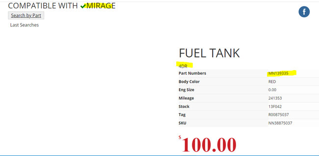

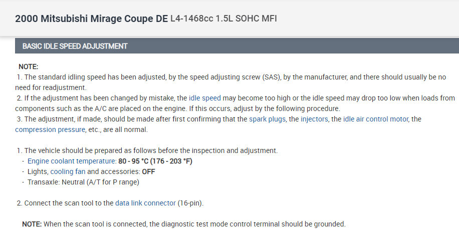

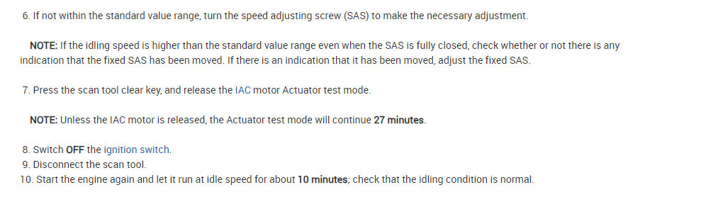

I attached two pics below. In my manual, the 1.5L is only used in a 2-door coupe. The 4-door sedan indicates a 1.8L engine. However, both appear to use the same fuel tank. And I looked up the part number from a dealership, and it indicates your vehicle and engine size, so I'm not sure which one is correct.
The only problem is the cost of the new one. The used one, if you can get them to ship it, would be a great price, $100.00. See the last three pics.
See pics below. Pics 3 and 4 are from the same website. I couldn't fit it on one pic.

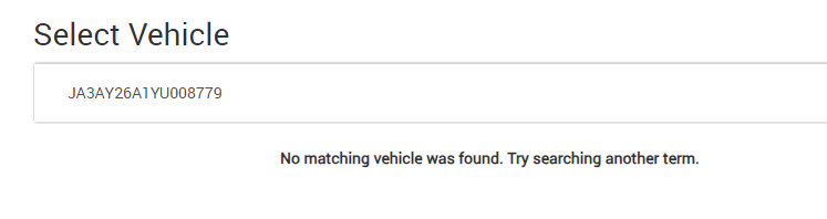

Here is the VIN:
JA3AY26AlYU008779
1.5L 4dr sedan DE
Jan 27, 2024 at 12:26 PM
  • 110,251 POSTS

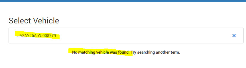

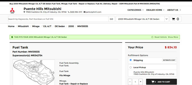

I tried using the VIN, but the system says there is no matching vehicle. If I had to guess, it is likely because they offered different models where you are located. See pic below.
The best thing to do is contact a seller and have him send pictures for you to verify it will fit.
I wish I could be of more help.
See pic below.
Jan 27, 2024 at 1:22 PM

Eh....try JA3AY26A1YU008779 stupid copy and paste picked up the 1 as an L...9th character error...sigh...LOL
Jan 27, 2024 at 1:44 PM
  • 110,251 POSTS
No problem whatsoever. I tried this one and got the same response. See pic below. I suspect it is because of the location.

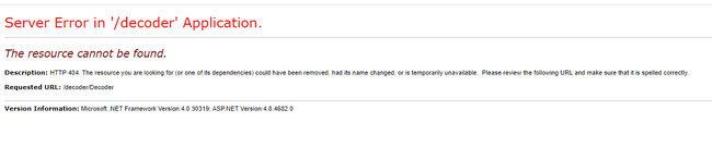

Odd, this link works okay for the VIN:
https://vpic.nhtsa.dot.gov/decoder/Decoder

I tried clicking the link and got an error code. LOL See pic below. I have no idea why.

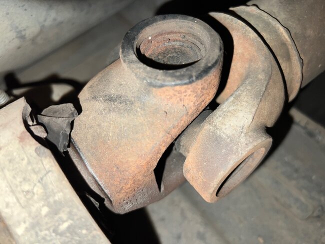

wrong post.
Feb 7, 2024 at 1:37 PM
  • 110,251 POSTS
I'm confused. The pic is a cracked U-joint or yoke. Is that correct?

Back to the 2000 Mirage. I'm not sure if I covered it or not, but the crank sensor is installed.
Not too bad of a job overall, but not something I'd do every day, LOL.
I should have spent a little more time on it and given the timing belt a good look over, but from what I could see of it, it looked fair enough. No cracking or signs of stress in it.
Guess the 1.5L has a camshaft sensor in the distributor. So, some posts have mentioned, and the 1.8L is outside on the head. I certainly cannot find one on this thing.

If you don't notice a change in the idle speed, remove and service the idle air control valve. In addition to the part, make sure the air passage it sets into is clear and not carboned. Keep in mind, a vacuum leak can also cause a rough idle, check that as well.

Thanks Joe will check it all out. As a note, I have changed the IAC and cleaned the throttle body out, but perhaps I still have an issue with the throttle body. It would be like the IAC gets stuck and doesn't want to adjust in and out. I noticed it has a little tiny motor on it to sew the valve in and out as it works, or at least that is what I suspect. Perhaps I just need to replace the throttle body now. It has over 100,000 on it.

There is an electric actuator that moves it. You are correct. When servicing this, you didn't pull or push on the pintel, correct? The threaded portion where the pintel and motor can be damaged easily.
Next, the IAC is controlled by the ECM. When you request AC or turn the steering, it is to compensate for the added load placed on the engine. Let me know if you are able to find anything. If not, we may have an electrical issue.

Ah, honestly, not sure what basics I would check...the manuals are fairly vague on some of this area. I just got a timing light the other day, so I can finally check my timing. It has been good for several years, even after installing a new distributor a few years ago now.
I lined things up with marks I made, but had to guesstimate with the new distributor since I couldn't mark it. But positioned as close as I could with the other markings, I scribed in the old one. Didn't miss or anything and seem to run okay.
I have a new IAC, TPS, and this time new gaskets. I'm going to pull the throttle body one more time and put the new stuff on. The TPS setting is a guess, but I think I seen in the manuals something about voltage, or ohm setting it.
I also got a new idle adjust screw...being it is plastic...the one in the throttle body now, if I can find it...lol, may be an issue. Again, several years ago I pulled the throttle body and cleaned it with carb cleaner and later found that isn't a good idea well too late of that one.
Perhaps the idle screw is damaged, don't know yet.
Funny, I'm on a mission to fix this thing. I've spent too much time fussing with it to give up on it now. New control arms, got the gas tank back in finally and no leaks still to date...saying that quietly... don't want it to hear me, lol.
Any tips you might provide on the IAC an TPS would be helpful.
Thanks Joe.
Terry
Mar 8, 2024 at 12:59 PM
  • 110,251 POSTS
Hi Terry,
I attached directions below for setting the idle speed. Take a look through them and let me know if you feel they are helpful.
Mar 9, 2024 at 9:19 AM
