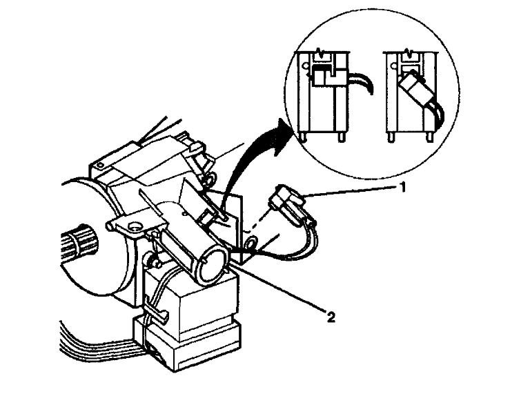

Engine shuts down while driving in afternoon. no warnings, no check engine light. Pull over and restart truck and go. Last time it did this it took 3 tries turn over .

It could be an ignition switch which was really common.
Ignition Switch Replacement

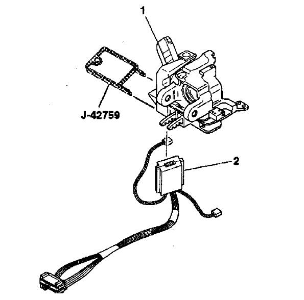

- J42759 Ignition Switch Connector Release Tool

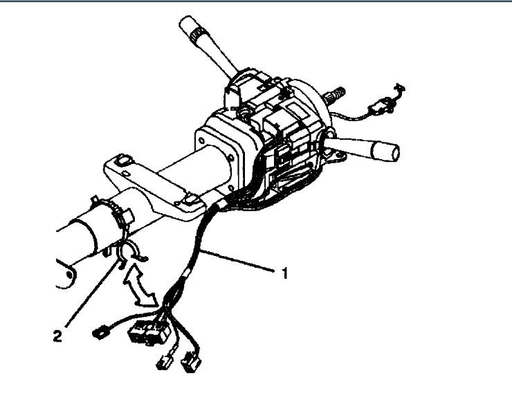

Important: The abrasion sleeve located on the steering column wire harness assembly must be reinstalled. Make note of what connector is coming out of the abrasion sleeve for installation purposes.
3. Remove the wire harness strap (2) from the steering column and the wire harness assembly (1).

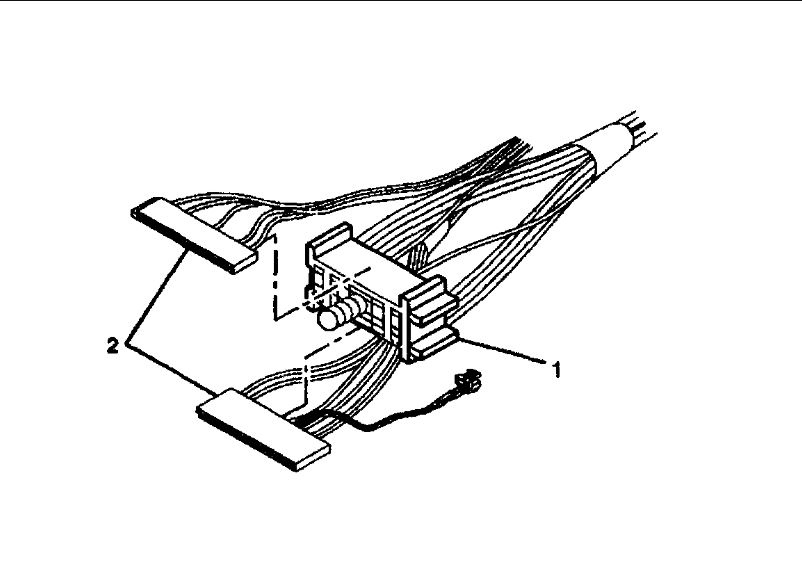

4. Slide the 2 connectors (2) of the turn signal and multifunction switch assembly out of the bulkhead connector (1).
5. Rotate the key alarm connector (1) 90 degrees.
6. Pull the key alarm connector (1) out of the ignition lock cylinder case (2).
7. Remove the passkey connector from the ignition lock cylinder case (2).
8. Insert J42759 into the ignition lock cylinder case (1) and slide the ignition switch (2) out.
