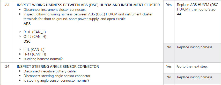

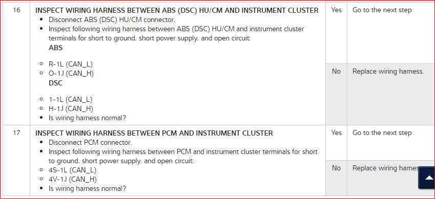

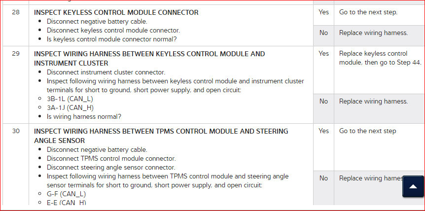

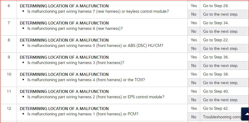

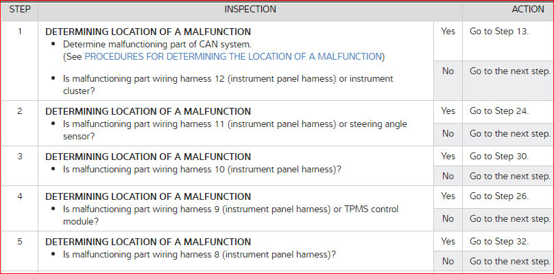

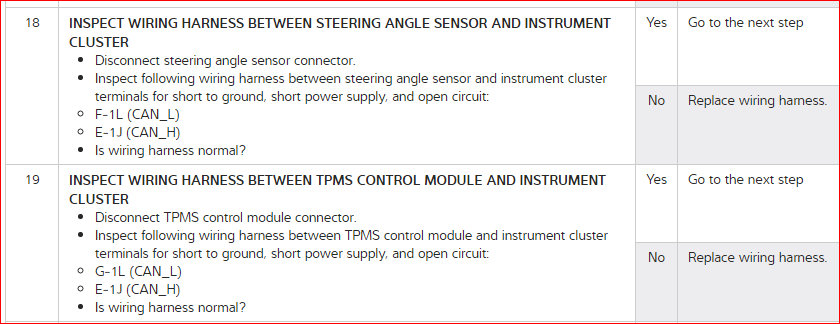

LUKIBLUE1

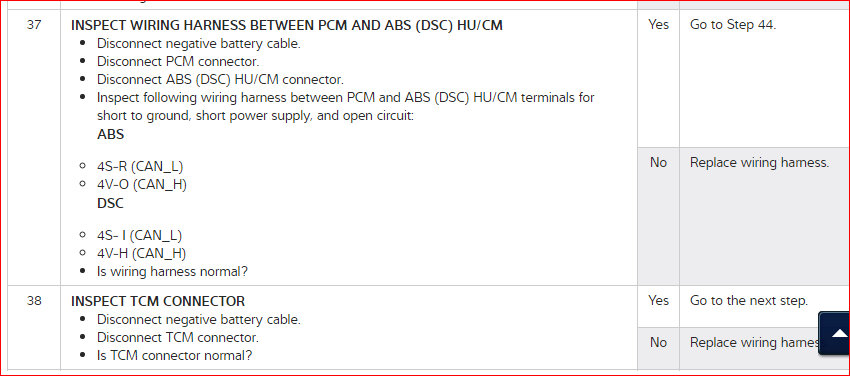

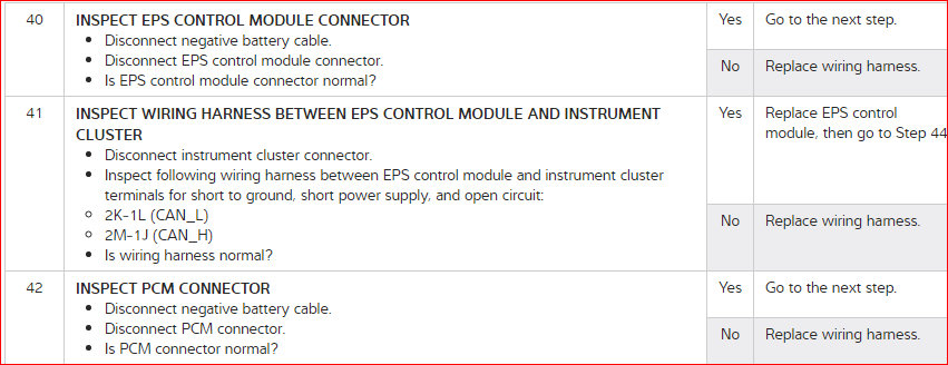

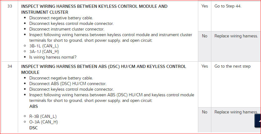

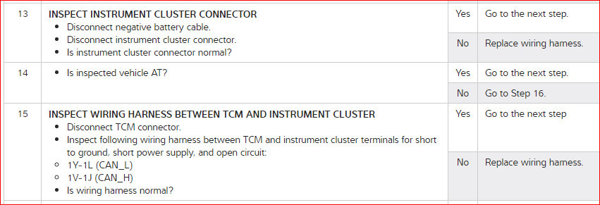

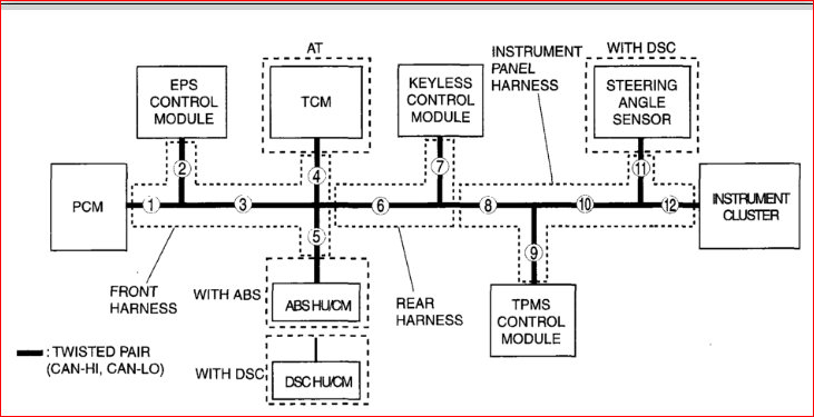

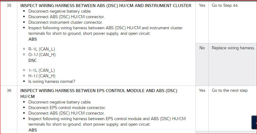

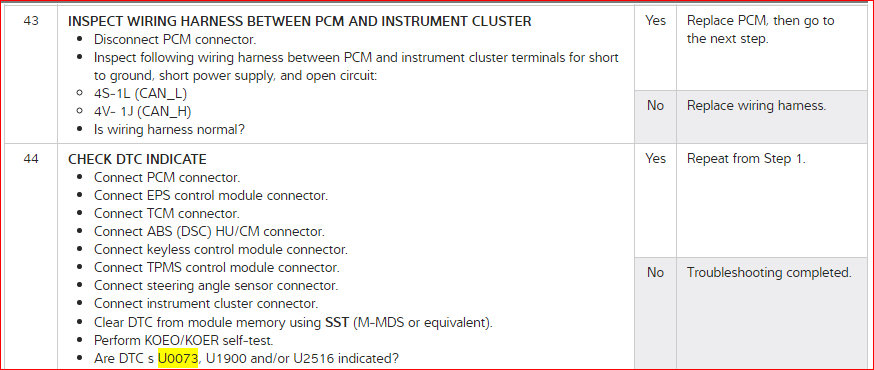

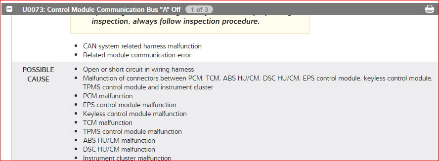

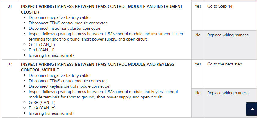

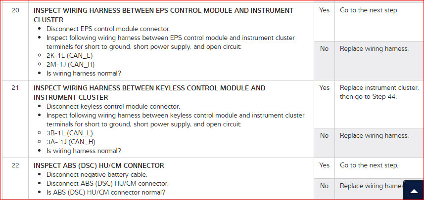

Hi, there is only one fault code its (U0073) which means my OBD was not working good. Any other suggestions? I cannot take the car because it does not start. It only starts if other car will charge it and then it will shut off when idle.
Sep 9, 2018 at 1:11 PM
DANNY L
  • 5,648 POSTS
Hello again.
Well, Since you cannot check codes I am attaching steps on how to check why your OBD is not reading. There are almost twenty pictures. Hope this helps and feel free to ask any questions if needed.Thanks again for using 2CarPros.
