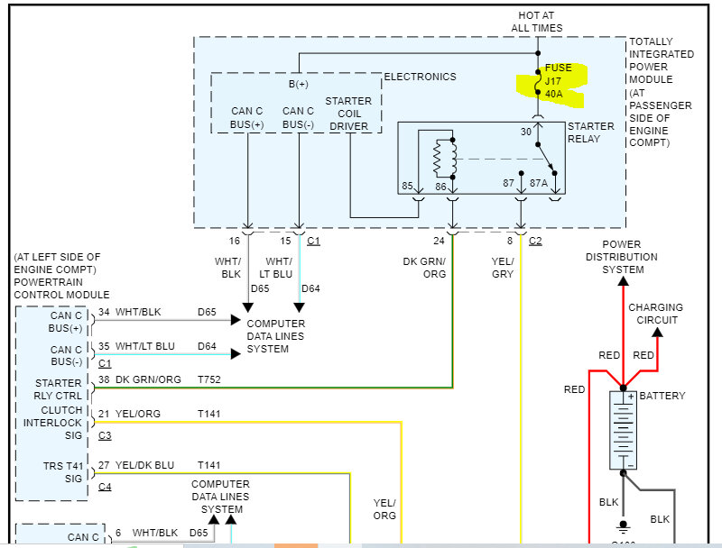

I was driving and went over a pretty steep apron in a lot and my jeep shut off completely with no lights, nothing and the gauges froze. After coasting to a stop and closing a door, the lights came back on, and the aux mode worked, and gauges went down. The engine wouldn't turn over though. Any ideas?
Jan 6, 2023 at 2:32 PM
  • 110,248 POSTS
Is everything now working other than the starter won't engage to start the engine? Also, how steep was the apron?
Let me know. Also, I attached the wiring schematic below for your vehicle. I highlighted a fuse I need you to check. Also, remove and reinstall the starter relay to see if anything changes.
When you check the fuse, make sure there is power to it as well.
Also, make sure the battery terminals are clean and tight and confirm the ground from the battery to the engine block is in good condition.

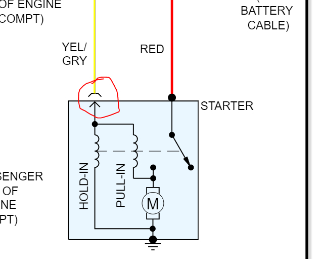

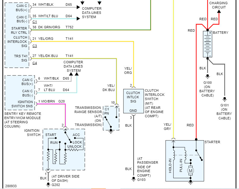

If the fuses and relays are all good, then we need to check for power at the starter motor.
At the starter motor, there will be a heavy gauge red wire straight from the battery. It will have 12v at all times. Confirm it does have power.
Next, there is a smaller gauge yellow wire with a gray tracer. It won't have power unless the key is in the start position.
Have a helper turn the key to the start position while you check that wire for power. If you have power, remove the starter and have it bench tested. If there is no power, then we need to work backward.
Let me know what you find.
See pic below.
