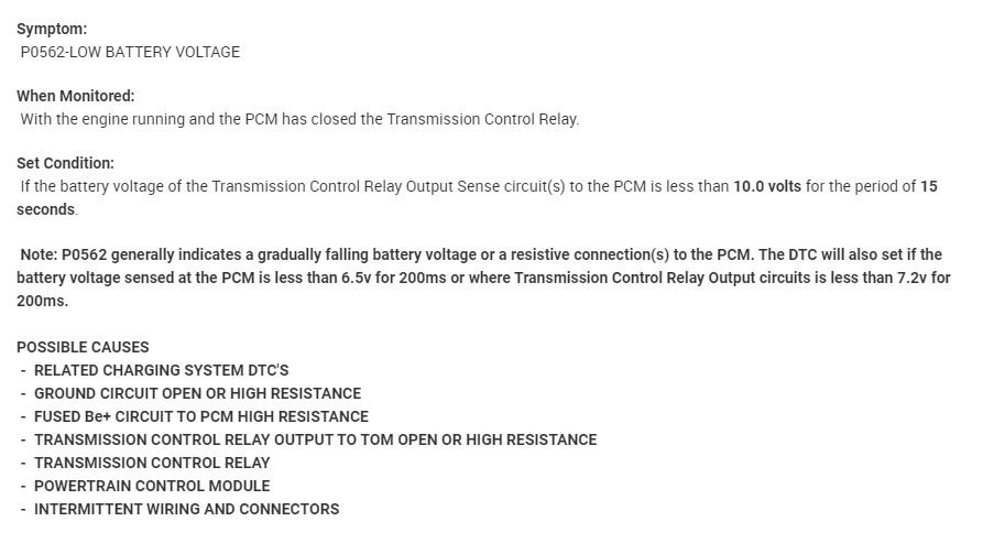

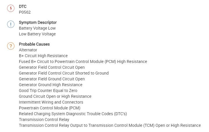

Po 562. It's a low voltage code but I can't figure it out.

The 562 is for low voltage and that could be the reason for shutting off. You need a minimum of 12.2 volts for any of the modules to work.

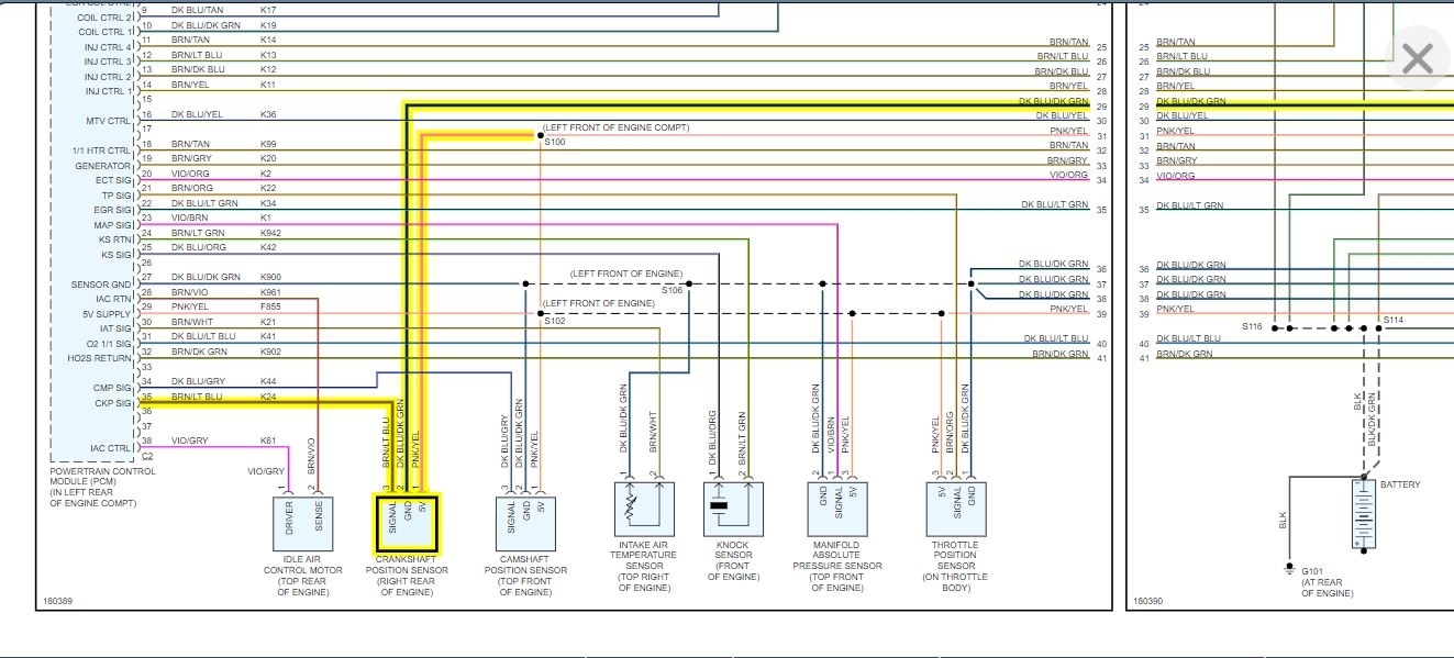

I am going to attach a diagram for you to view for the crank sensor. You will need a voltmeter to do a test.
I need you to put the red lead in the pink/yellow wire and the black lead in the dark blue/dark green wire. Turn the key on and tell me the volt reading.

It read at 5.00v.
May 24, 2020 at 1:11 AM
Okay, then move the red lead to the other wire and tell me the voltage.
May 24, 2020 at 1:22 AM
BENTLEYT17
  • 11 POSTS
Reading the same.
