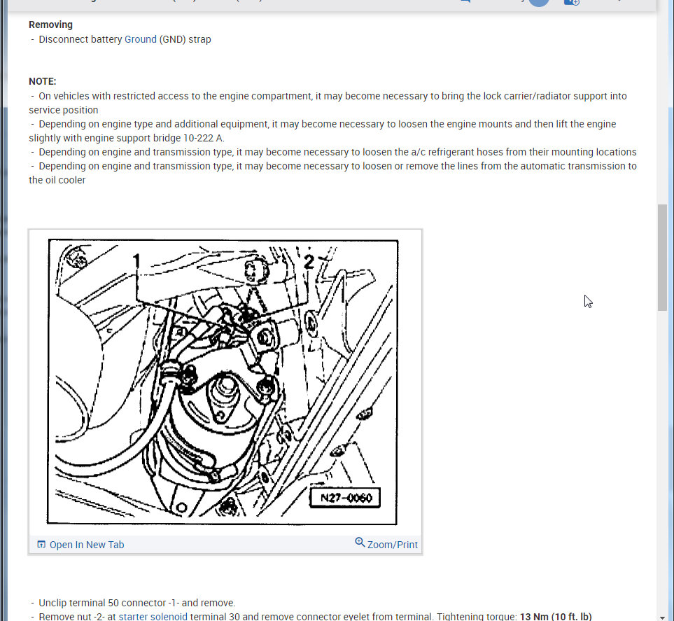

While was stopped it shut off didn't want to start had juice because lights and everything electrical works. got it started by tapping on starter, so I know starter is going out. but what would make it shut off of the blue while it's running.
Jan 13, 2021 at 6:51 AM

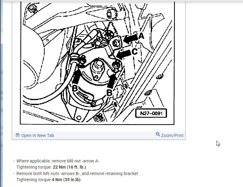

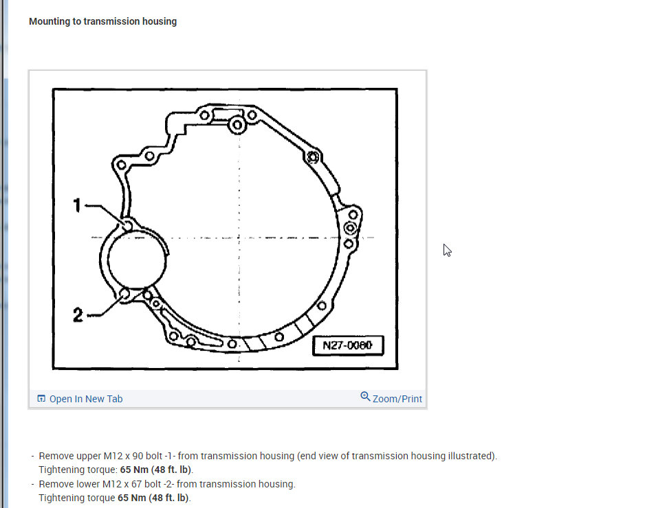

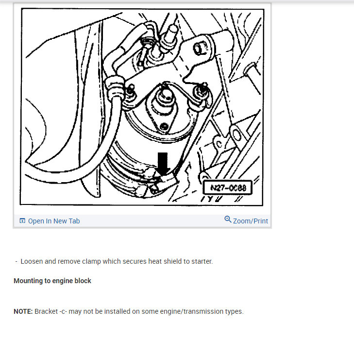

You are correct about the starter and I attached the process on how to replace that below.
