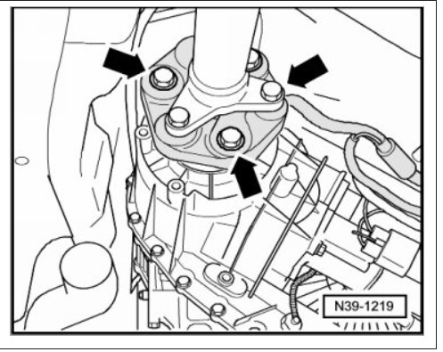

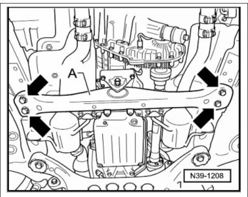

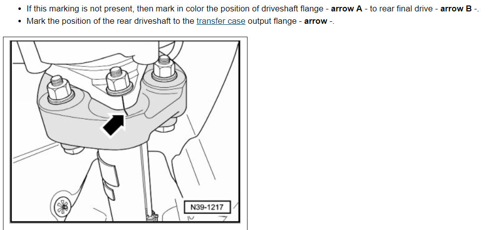

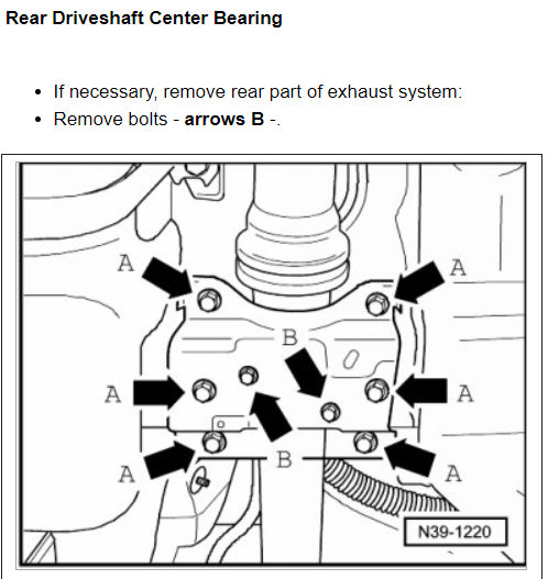

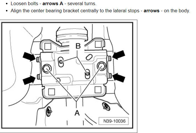

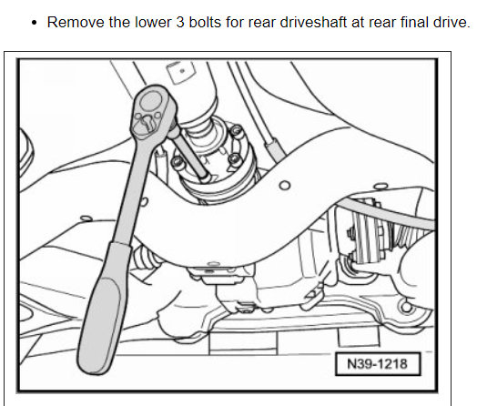

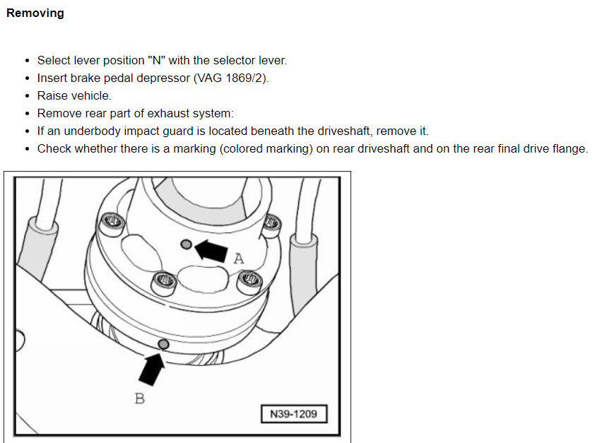

Apr 27, 2018 at 2:48 AM
  • 55,399 POSTS
This sounds like a driveshaft problem like the center support or flex joint is out allowing the driveshaft to move around causing the vibration.
Here are diagrams to help you see what I am talking about.
