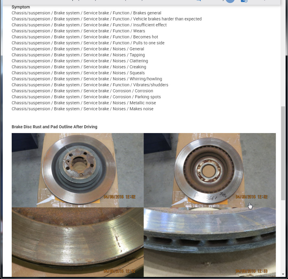

This is either the rotors and hubs have some rust build up in between them. If this is not cleaned when the rotors are replaced they will vibrate at times.

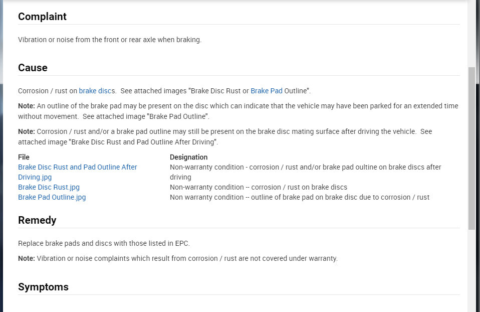

The other thing it could be is rust build up on the rotors themselves. There is a TSB out for that which I attached.

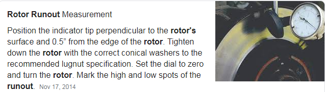

Based on that, I doubt it is caused by your braking habits. Sounds like there is a runout issue. I would ask them to get the runout measurements of the rotors and hubs.
