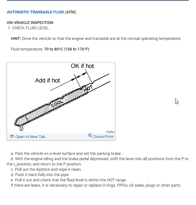

I have recently started noticing noise in low gears and little friction while shifting through low to high. As I recall, the fluid has not been changed before. Should I go for a transmission fluid flush as I am afraid it might do more damage or just let the fluid drain and replace some of it, or just leave it as it is?
As I have started noticing these noises recently, I am wondering if I can stop the transmission from getting any worse. I appreciate any help. Thanks in advance.
Feb 18, 2020 at 9:26 AM
I would check the fluid and see what condition it is in. Make sure it is not low and pink in color. If it smells burnt then I would go ahead and change it.
Servicing the transmission is never a bad idea. However, there is no service interval for this transmission. You are to inspect the fluid every 60,000 miles and then change it when you need to.
Let me know if you have questions. Thanks
