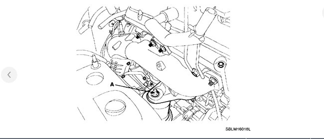

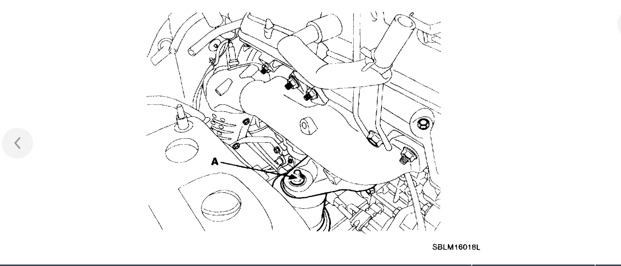

Sounds like you may have a broke engine or transmission mount, The axle shouldn't give a banging noise. Now that you have the front drive shaft back in your vehicle, It is putting more stress on the mounts and if you have a broken mount this can throw your drive-line out specs causing engine or transmission to bang. I'm attaching engine mount location.
also check the suspension height and struts, springs, and shocks for this can also cause drive-line problems. I have also seen body mounts make a banging noise when making turns over rough terrain.
Let us know what you found so we can help others.
