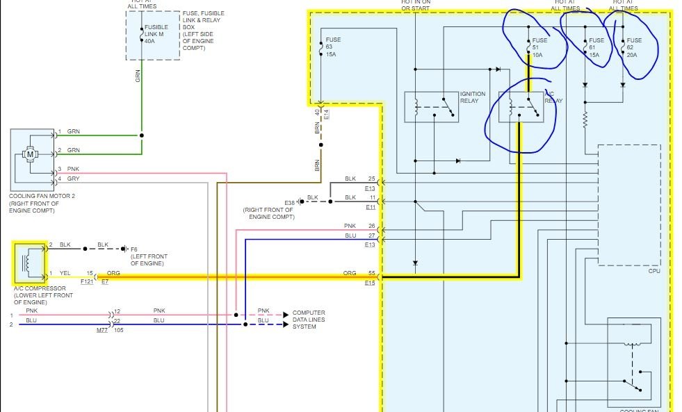

Shorted out high pressure A/C switch trying to jump it, will not start
2013 NISSAN ROGUE
130,000 MILES • 2.4L • 4 CYL • 2WD
SANDRABOUNDS
Tried jumping high pressure A/C wires and shorted them out.sparked to battery and starter went out.replaced it wit a used one. it throws code of mass flow sensor.replaced that.

Why does it give code of throttle body sensor?

Good morning,
Let us start with the codes? Can you list the code numbers for me to see so I can help you?
Did you verify power to the high pressure switch?
I attached a wiring diagram for you to view. Verify power to the fuses with the key on. This is not a visual test, it is a power test.
