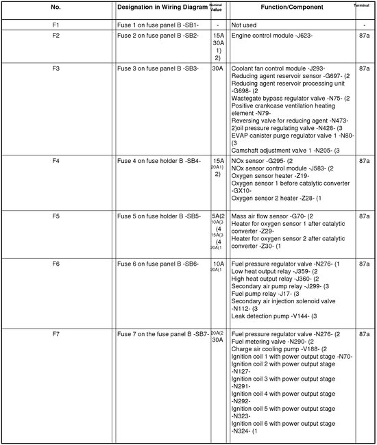

I have a 40 amp fuse in the engine compartment that keeps blowing on my car listed above TDI VIN 1VWCN7A34CC044177.
How can I obtain a fuse diagram for my vehicle?
Apr 10, 2021 at 1:46 PM
  • 110,244 POSTS

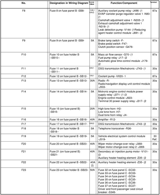

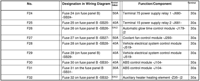

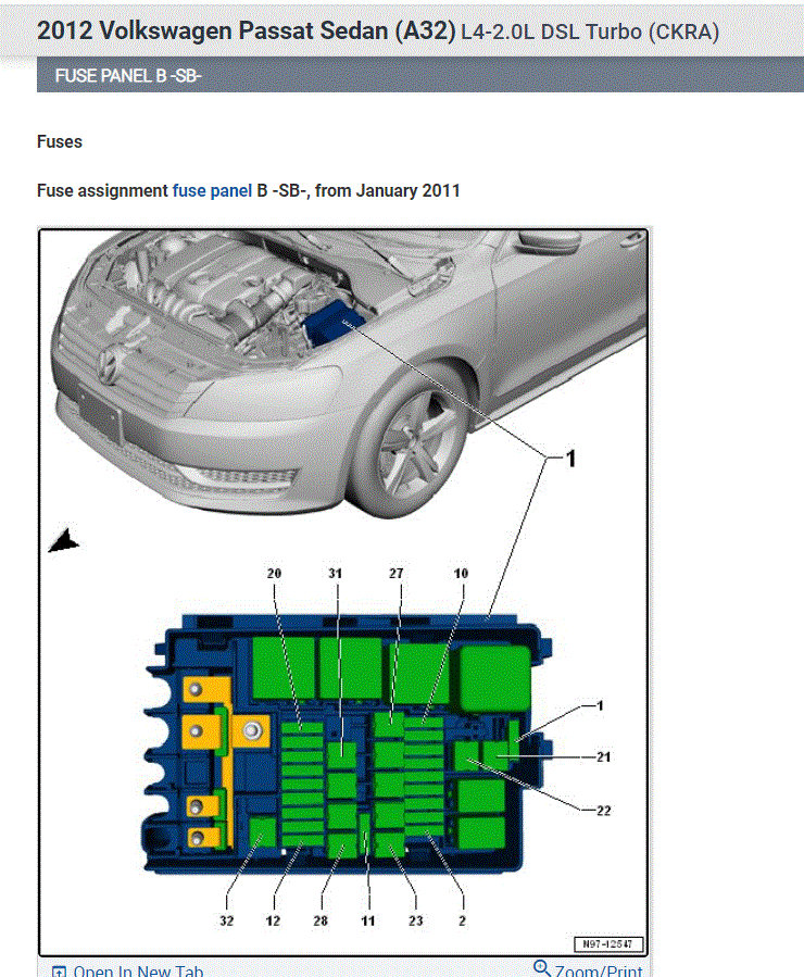

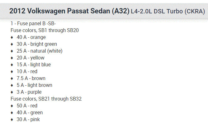

I attached information related to the fuse box under the hood. I don't know which fuse is blowing, and there are a couple that are 40 amp.
Take a look through this and let me know if it is what you needed. Also, if you can provide the production date, it may help. When I go through the manual, there are several production dates to choose from. The one listed below started in January of 2011 but was used in the 2012 model year.
If you look on the driver's door or the door frame, there should be a label that indicates when it was built.
Let me know if this helps or if you have other questions. Also, here is a link you may find helpful:
Apr 10, 2021 at 2:39 PM
MD TDI
Joe, thank you very much. According to the diagram it is the F16 40 amp fuze for the Amplifier R12. I will trace that down and see if it is shorted out.
