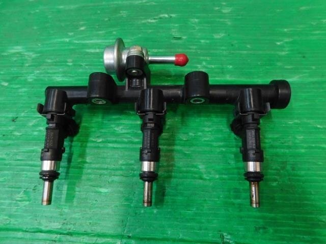

How to check this type of fuel pressure regulator? it does not have any vacuum connection . And yes fuel pump does not hold pressure . Can a one way valve can do some? And at idle ltft stays -4.7 and sometimes -6.0. if fuel pressure isn't good then my ltft should be positive I guess.

Okay, if the fuel pressure drops off, it could be either one of the injectors leaking down bleeding off the fuel pressure or it could be the check valve in the pump itself.
The injector rail off as in the picture you see, pressure up the pump with the key on and see if any of the injectors are leaking fuel.

I already checked the injector by disconnecting fuel rail and key on no fuel drips while in switch on..

Okay, then it is the fuel pump itself.
