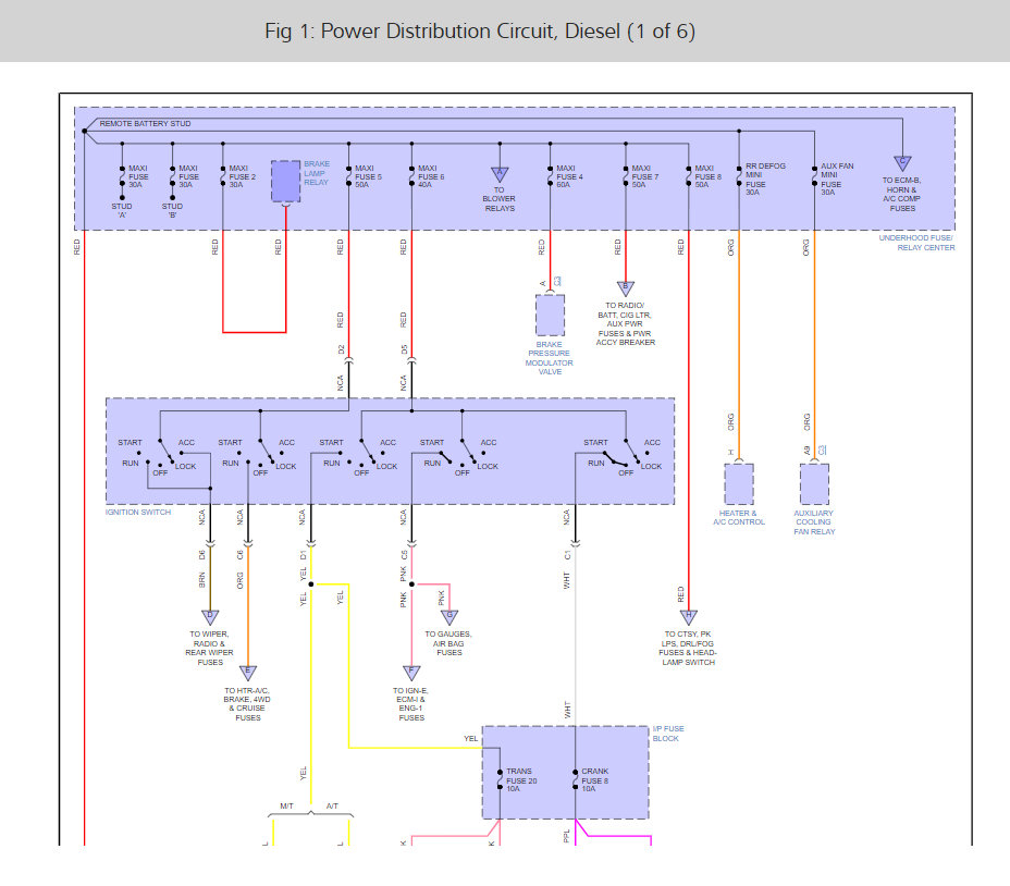

This is common when the ignition switch goes out. To be sure, here is a guide to help you to test for power at the brown, yellow, pink, and orange wire with the ignition switch on. You should do the test when the gauges etc., are not working.
See how the system works by clicking the image ignition wiring diagrams below. Check out the diagrams (below). Please let us know what you find. We are interested to see what it is.

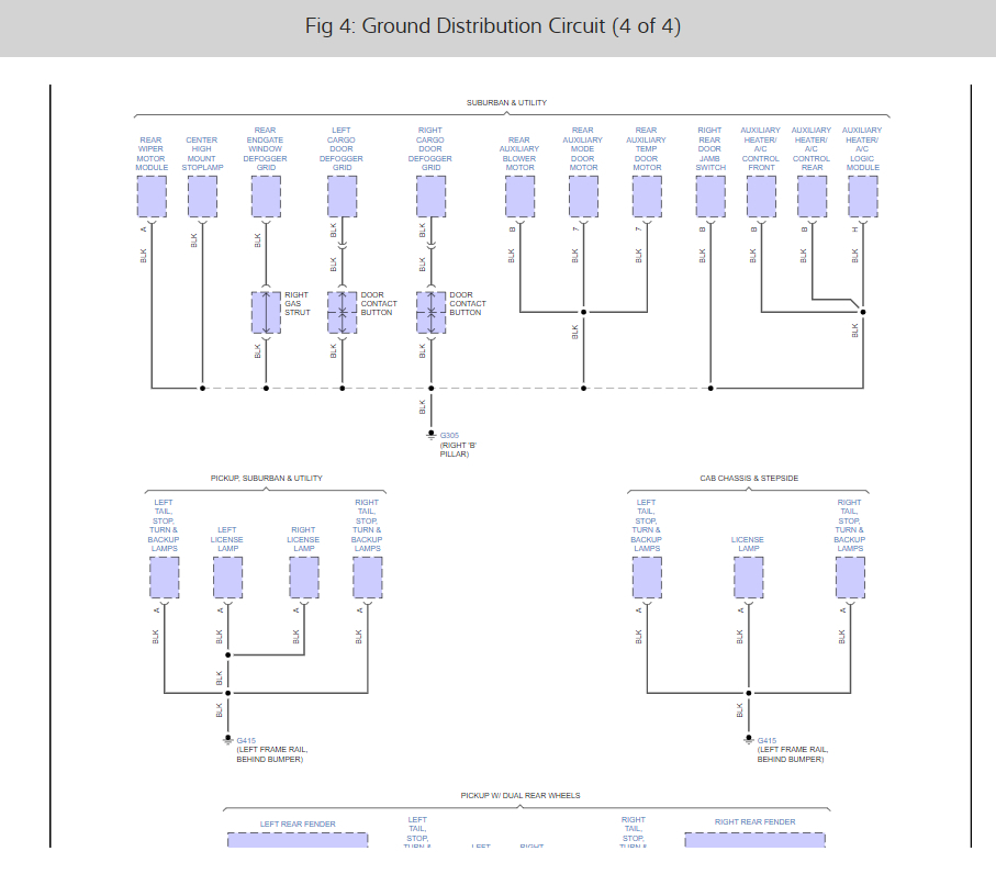

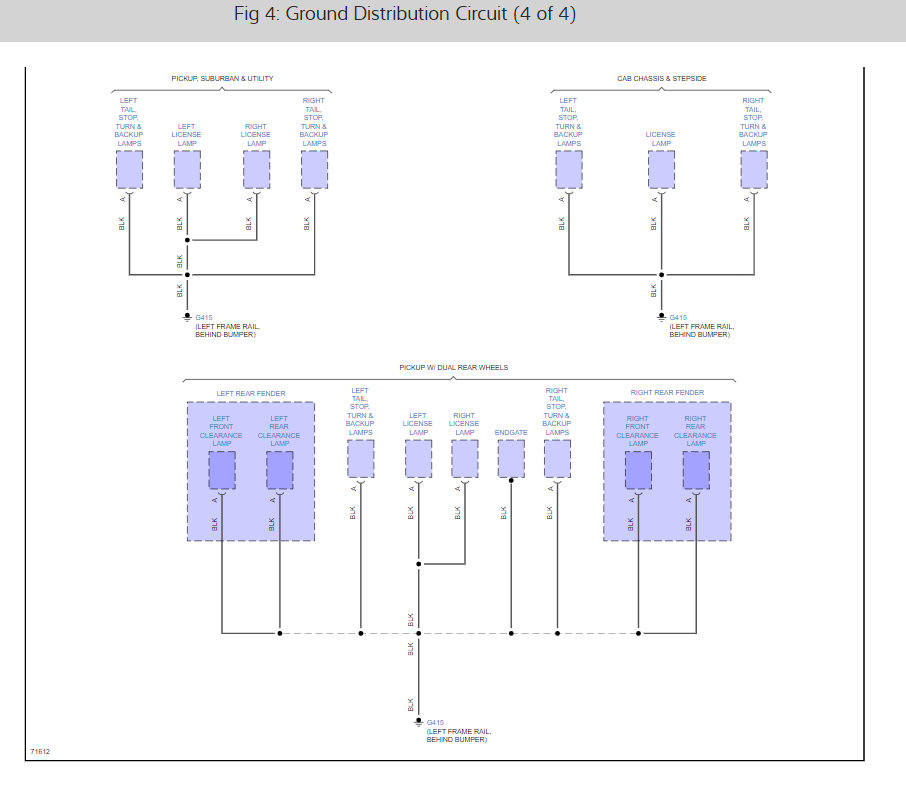

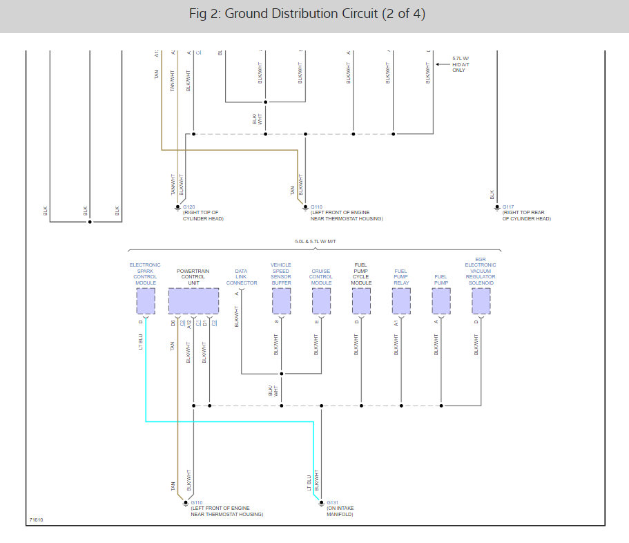

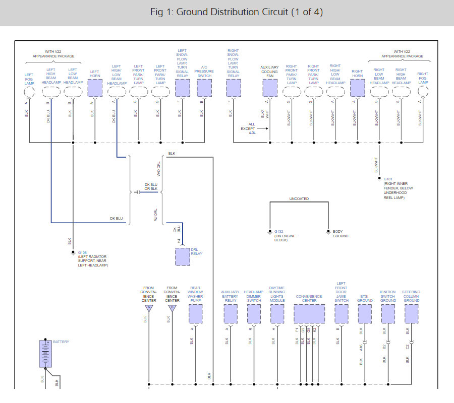

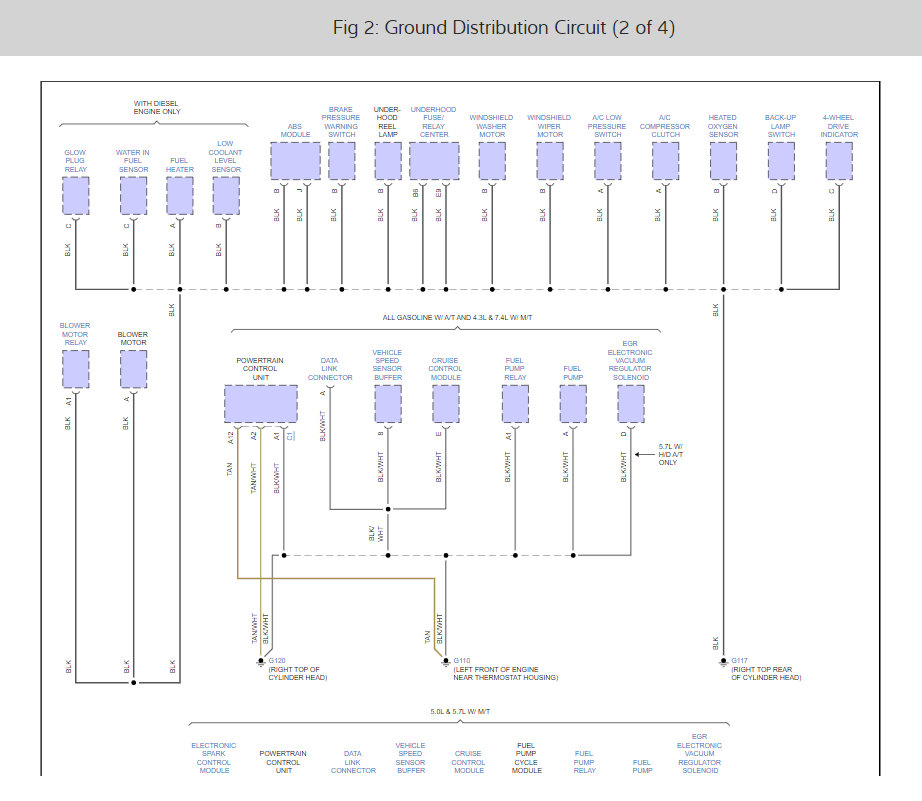

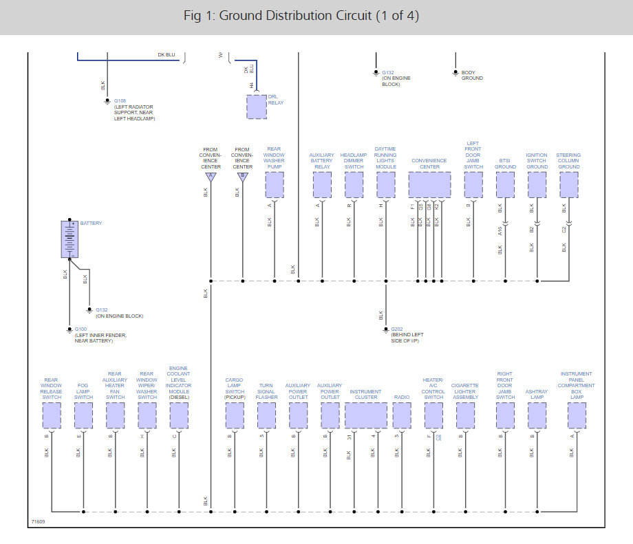

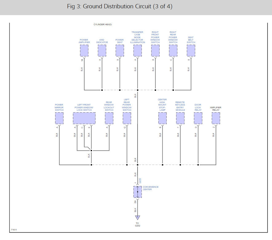

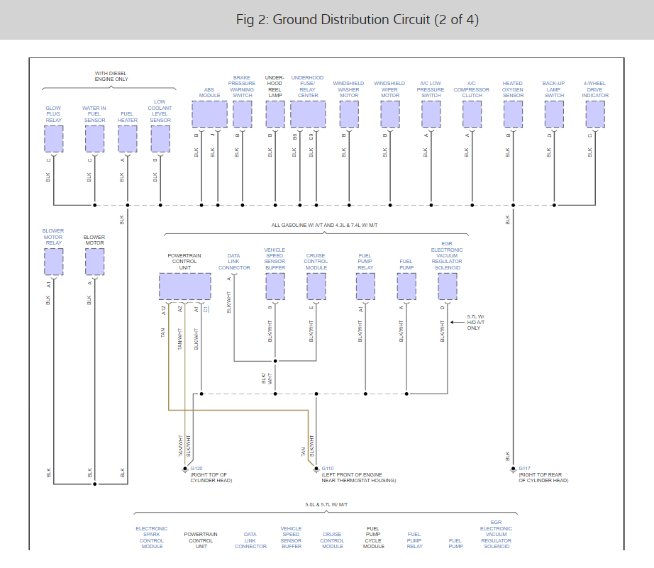

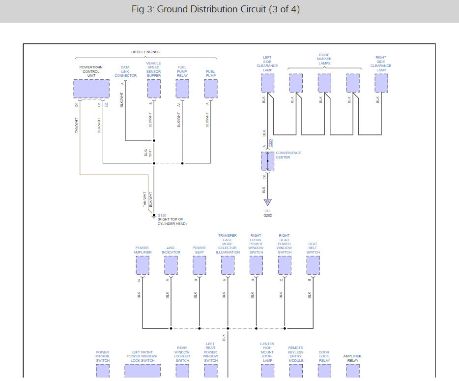

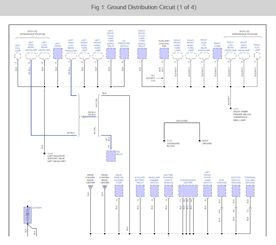

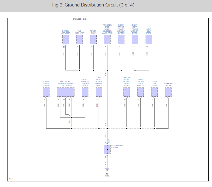

That sounds like a bad ground, I would check the under dash ground points, here are the locations in the diagrams below.
