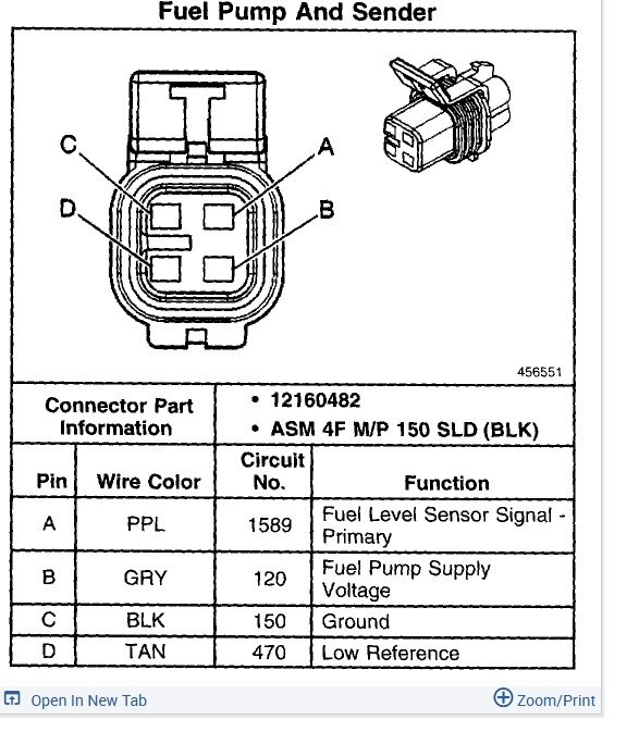

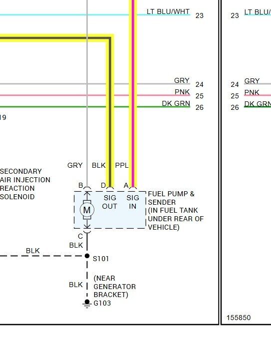

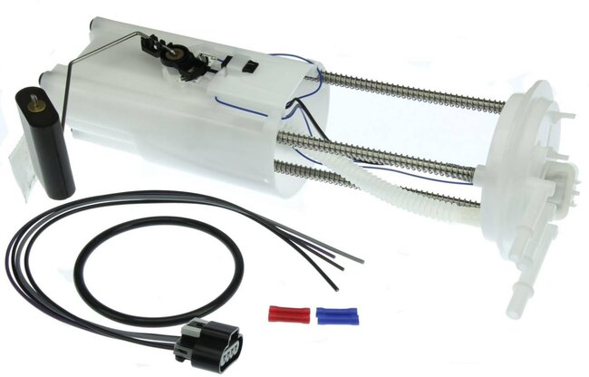

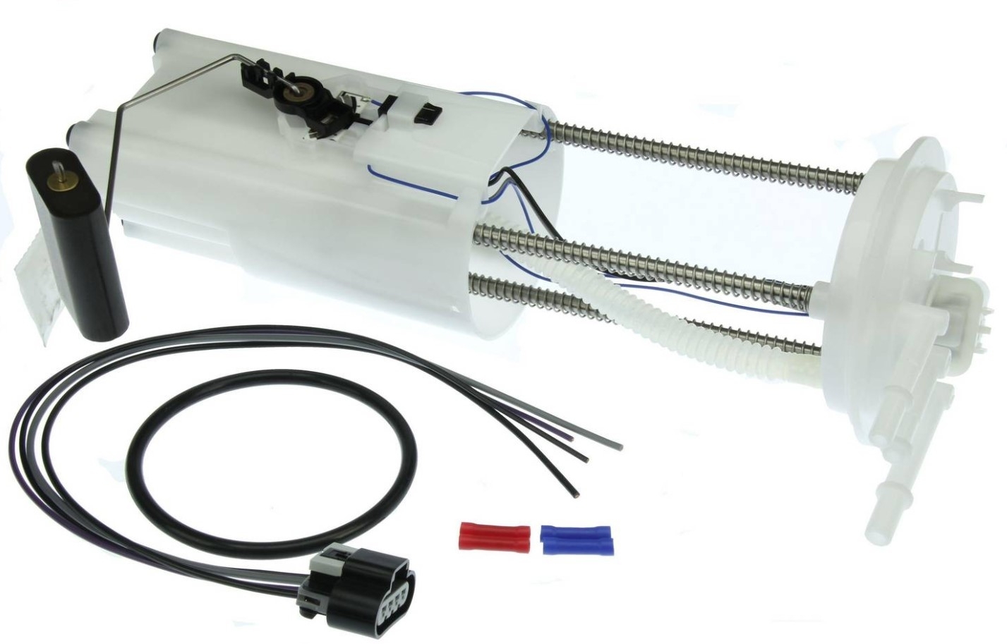

The shop stated wiring was not the same as new fuel pump. The shop spliced wiring to fuel pump, since wiring was different. I drove the vehicle to get fuel and returned to the shop because the fuel gauge was not working at all. The shop switched wiring around and said gauge is now acting erratic. Fuel needle is bouncing. Shop says cluster bad! I said cluster is fine. Problem in their wiring patch or ground or wrong pump. thoughts?
Jan 23, 2025 at 12:14 PM
STEVE W.
  • 15,202 POSTS
GM did change the pump connector on the newer pumps in an attempt to prevent the failures the earlier design had. However, the aftermarket pumps usually come with the new pigtail and the directions of which wire connects to what. The problem is that many of the aftermarket pigtails come with similar colored wires. The idea is that you look at the OE wiring and then match the functions to the replacement connector. As they replaced the module itself along with the wiring it could be the wiring, or the pump module might have a defective sending unit. Hard to know without testing them outside the tank. Connecting the wiring wrong might have done damage but it would depend on which wires they were. If the two for the gauge were reversed it would have made the gauge work in reverse, so as you added fuel the level would have gone down. If they reversed the grounds, it would likely have damaged the cluster as it passed a lot more current to power the pump than the gauge would have used. You could use a scan tool that can read live data and see if it acts erratic, if it does as well then it isn't the cluster but the sending unit. What you might want to do is get a second shop to look at it, tell them that you had a shop replace it and how they had to redo the wiring and now the gauge is bouncing. See if they will bill the first shop.
