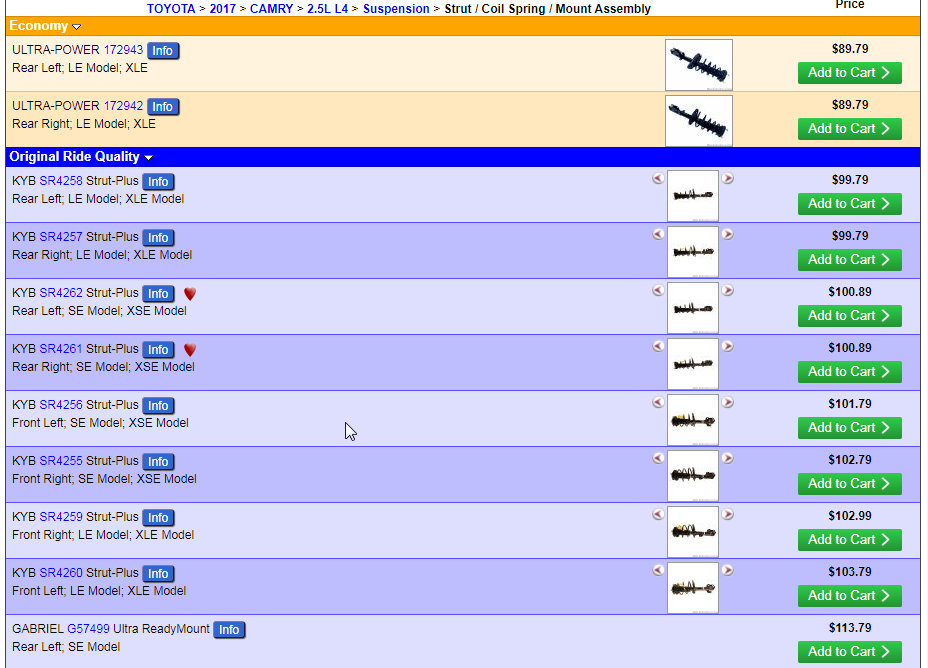

I am wondering what the best replacement make and model of shocks/struts would be for the 2017 Camry SE. I am hoping for a brand with a high quality durable build and can help the car ride smoother.
Jan 12, 2020 at 3:52 PM

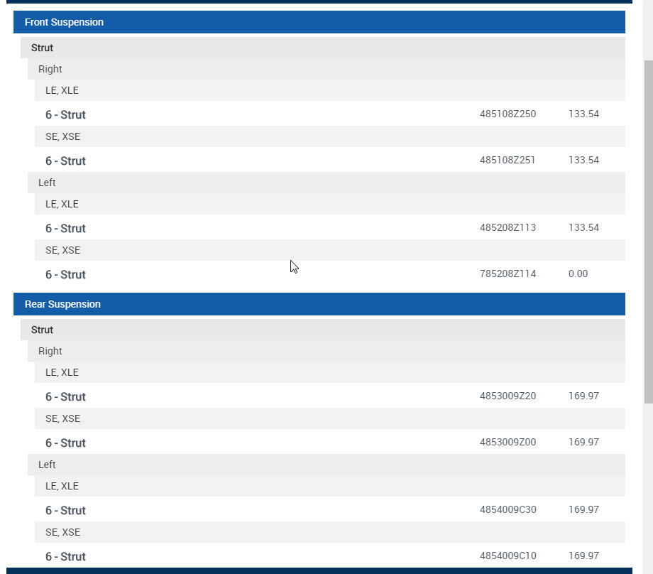

There are quite a few of replacement options out there for these but there are not many for an "upgraded" ride quality because this is not a vehicle that is altered very often. This means that the companies that make these don't wonder far from what the OEM used.
I say all this because I don't suspect that you will find a strut that changes the ride quality enough to notice. This means that you can't really make a wrong choice. If it was me, I would go with one of the KYB options that I attached below.
The first screen shot is of OEM part numbers. The second is a popular parts site.
