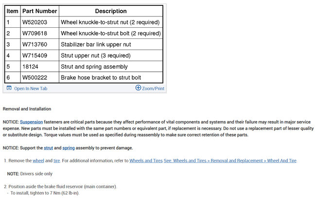

It keeps on making a whole bigger on my shocks mounting and making noise and losing control. I changed it last of last week it was better now has started again.
Nov 16, 2023 at 10:17 PM
  • 55,781 POSTS

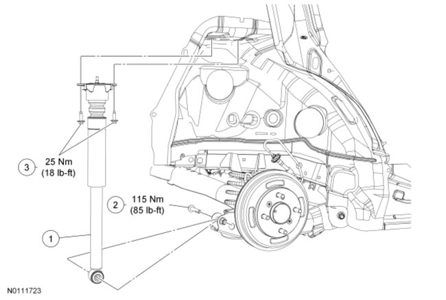

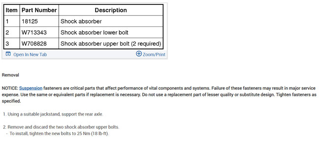

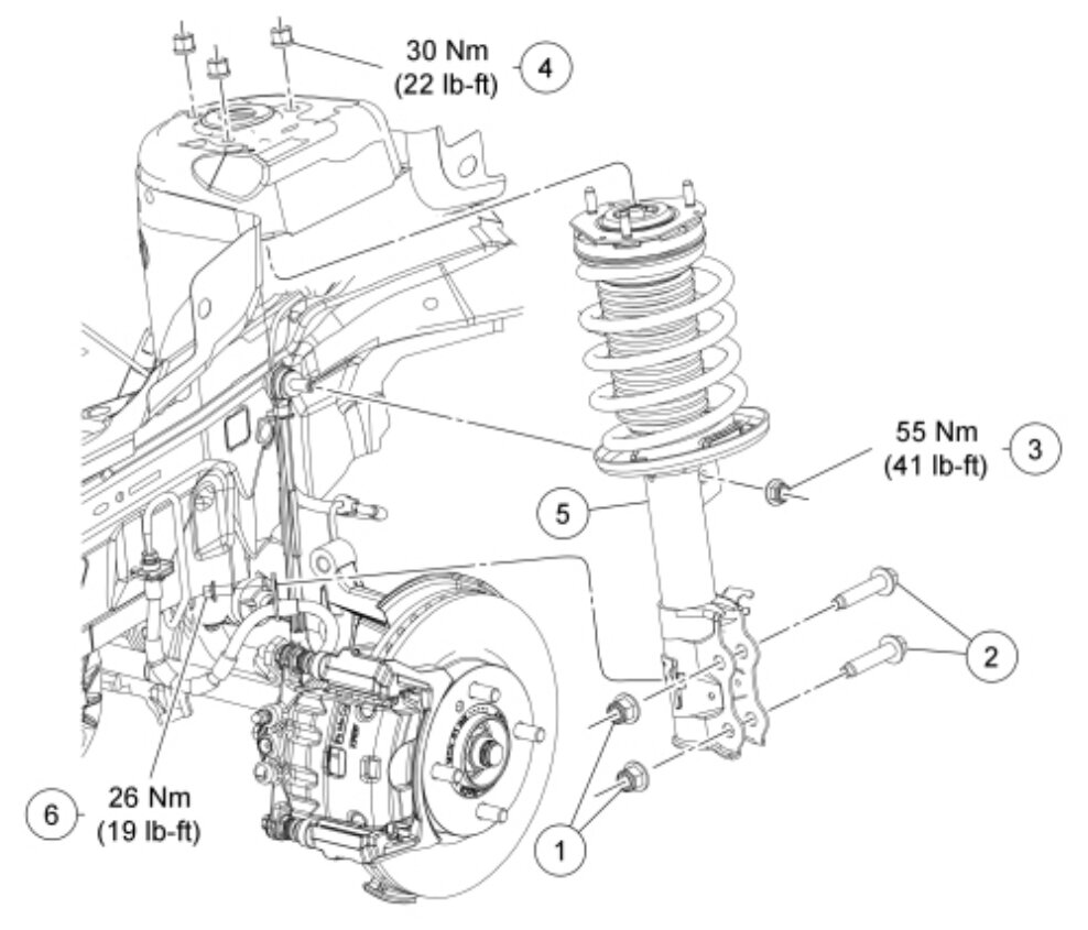

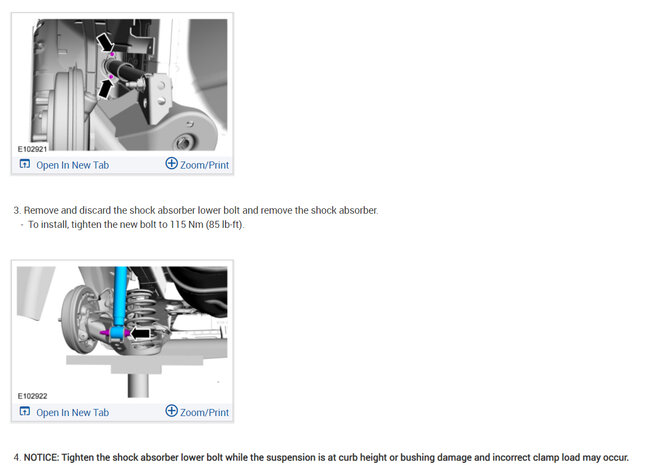

Can you give us more information, maybe an image of the problem so we can help? Here are images and instructions on the front struts and rear shocks so we can be on the same page. Check out the images (below). Let us know what you find.
