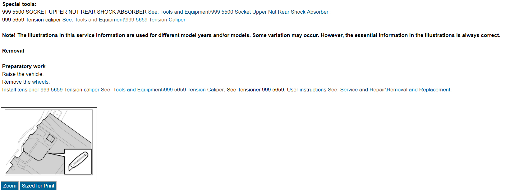

passenger side shock is leaking. what brand of shocks that will work best?
Apr 26, 2018 at 8:08 AM
Experienced Mechanic
55,616 POSTS

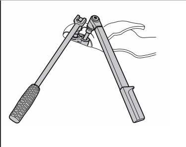

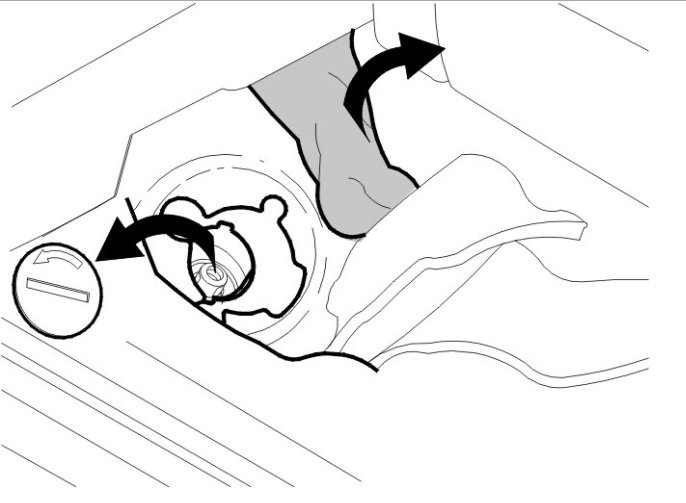

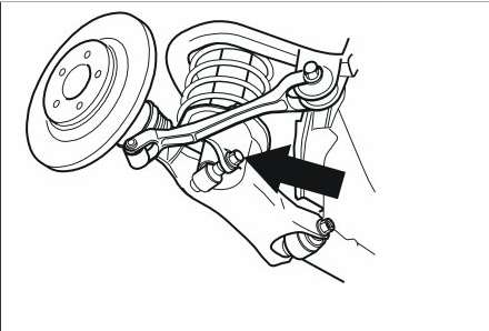

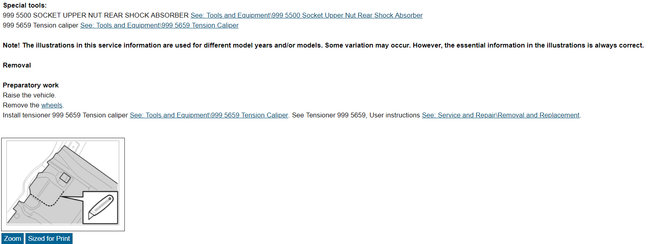

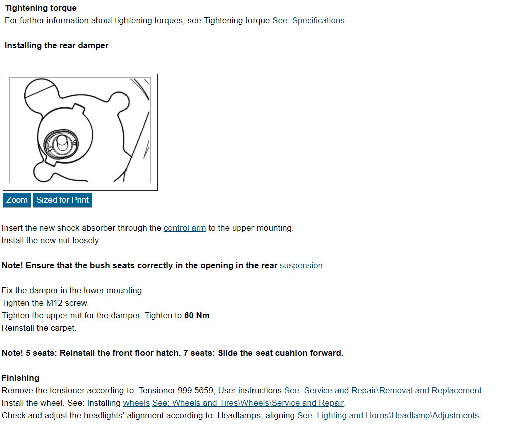

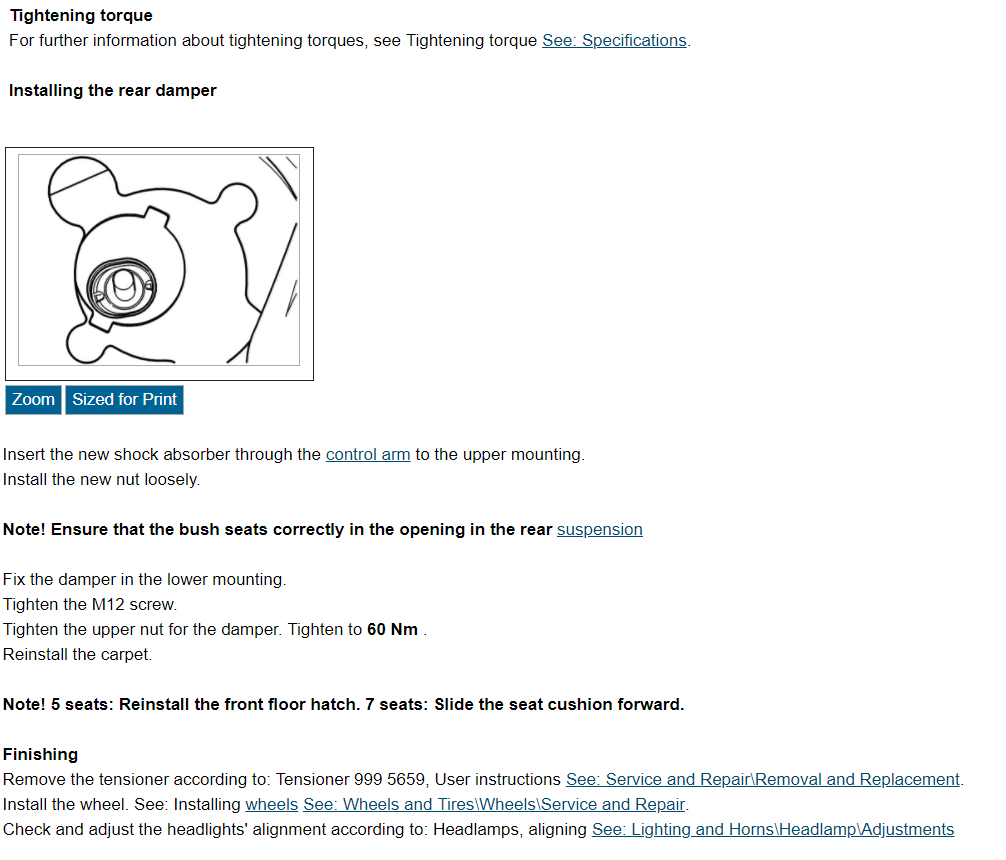

I see the Volvo shocks are about $365.00, but I found a SACS brand which is good for about $76.00.
https://www.amazon.com/gp/product/B004A3BT0I/ref=as_li_qf_asin_il_tl?ie=UTF8&tag=2carprcom-20&creative=9325&linkCode=as2&creativeASIN=B004A3BT0I&linkId=315a6060c95240749fb247dac4087896
Here is a guide to help you get the shocks changes out:
https://www.2carpros.com/articles/replace-shock-absorber
Here are diagrams to of what it will be like on your car.
Check out the diagrams (Below).
Images (Click to enlarge)
