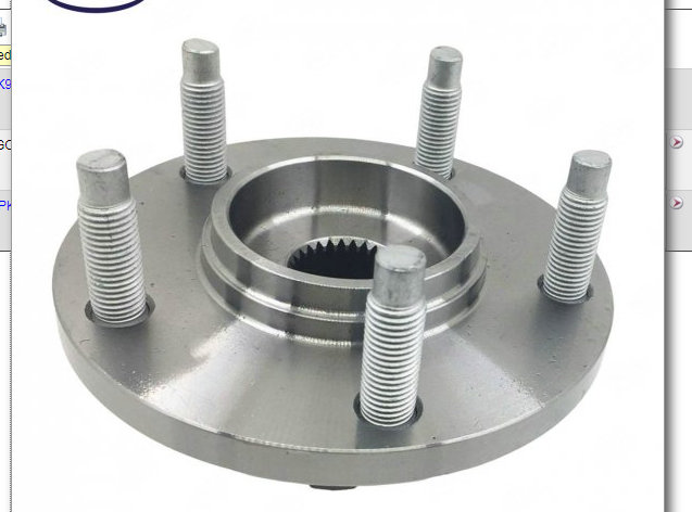

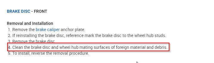

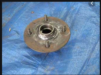

Have you cleaned the hub surface when putting the new rotors on? If you don't then it can create run out which will be felt as a shimmy.
If you look at the pictures below you will see a corroded hub surface and then a new one. Clearly the surface will not look like new but it needs to be cleaned to ensure it is bear metal and no rust build up.
Jan 27, 2020 at 9:50 AM

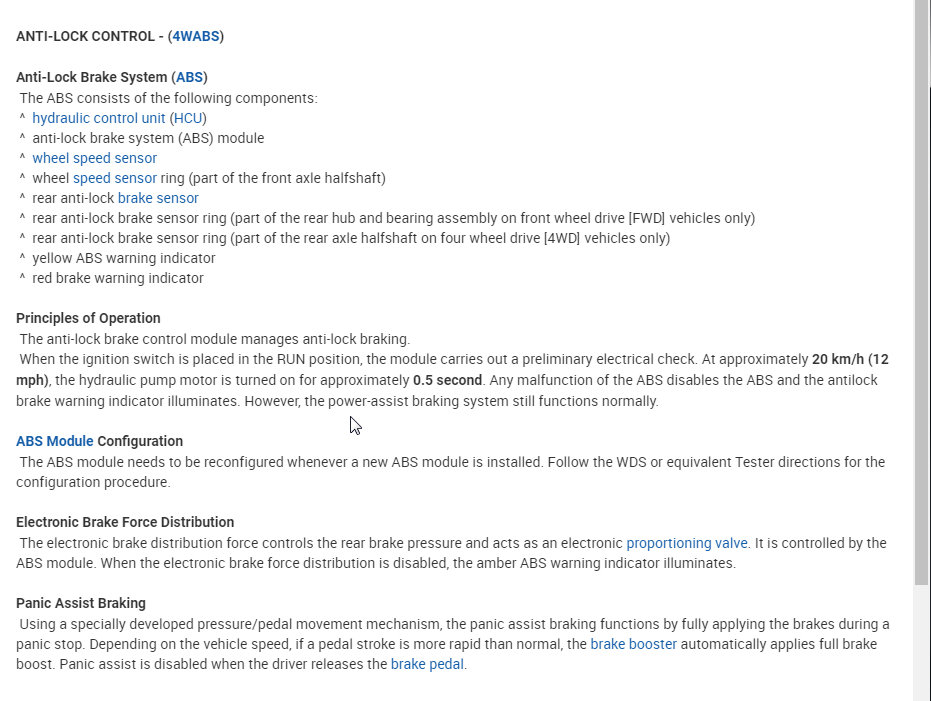

This sounds like the ABS is activating. Do you hear a grinding type noise and feel the vibration in the pedal?
We need to inspect the wheel speed sensor connections and the tone wheels for cracks. Do you have a scan tool that can look at wheel speeds inputs to the ABS? If so, we need to monitor them which driving and see if they are all the same speeds.
If not, here is a guide that goes through how to test a speed sensor. Let me know if this sounds like your issue. Thanks
https://www.2carpros.com/articles/abs-wheel-speed-sensor-test
