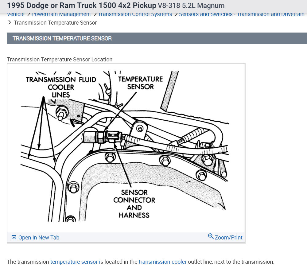

I have seen the transmission fluid temperature sensor go out causing this issue. But to be sure we should run the codes. If this is an OBD2 system this guide will help:
if not use this guide:
https://www.2carpros.com/articles/retrieve-trouble-codes-for-chrysler-dodge-plymouth-odb1-1995-and-earlier-car-mini-van-and-light-trucks
Check this guide out as well:
Here is the fluid temperature sensor in case you want to try it. Check out the diagrams (below). Let us know what happens and please upload pictures or videos of the problem.
