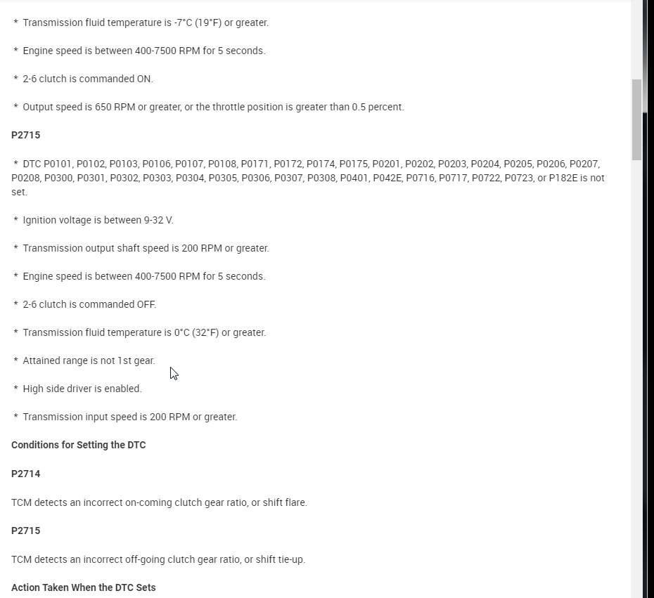

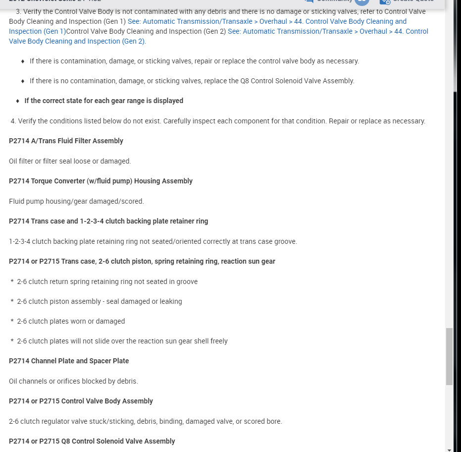

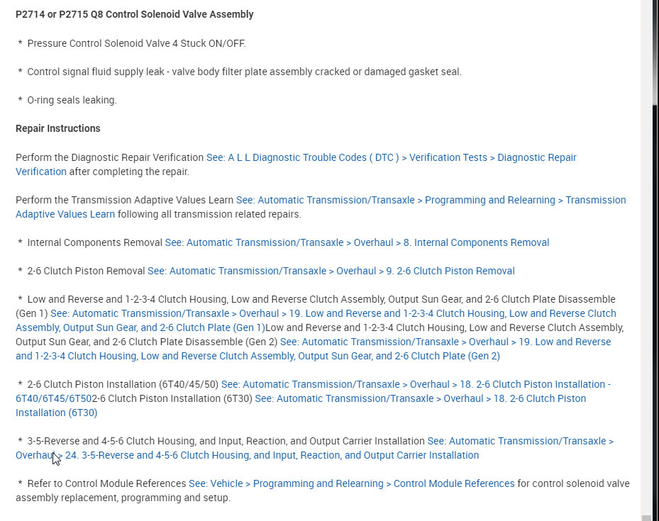

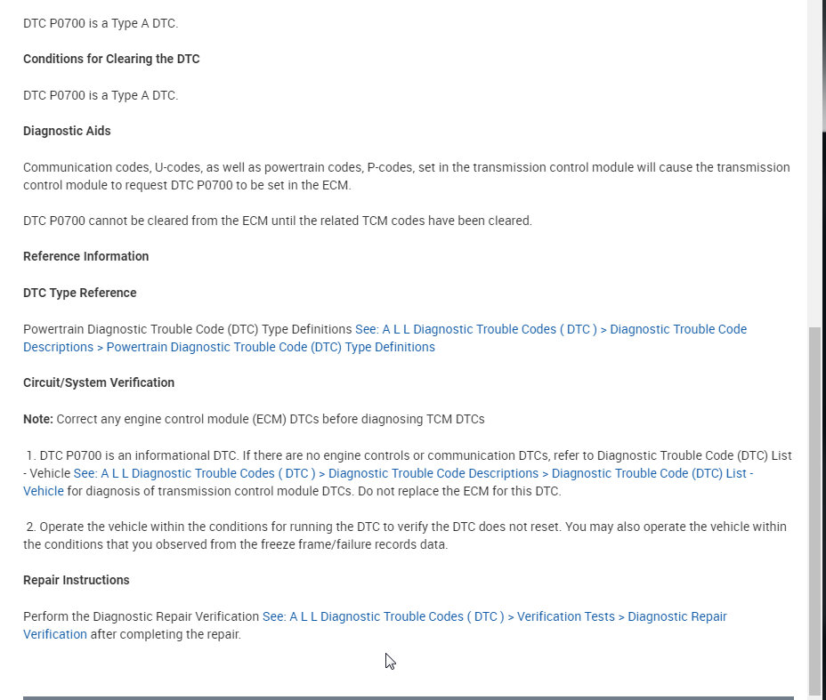

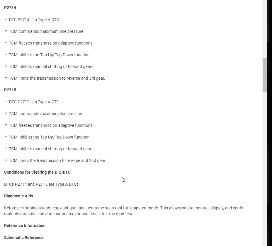

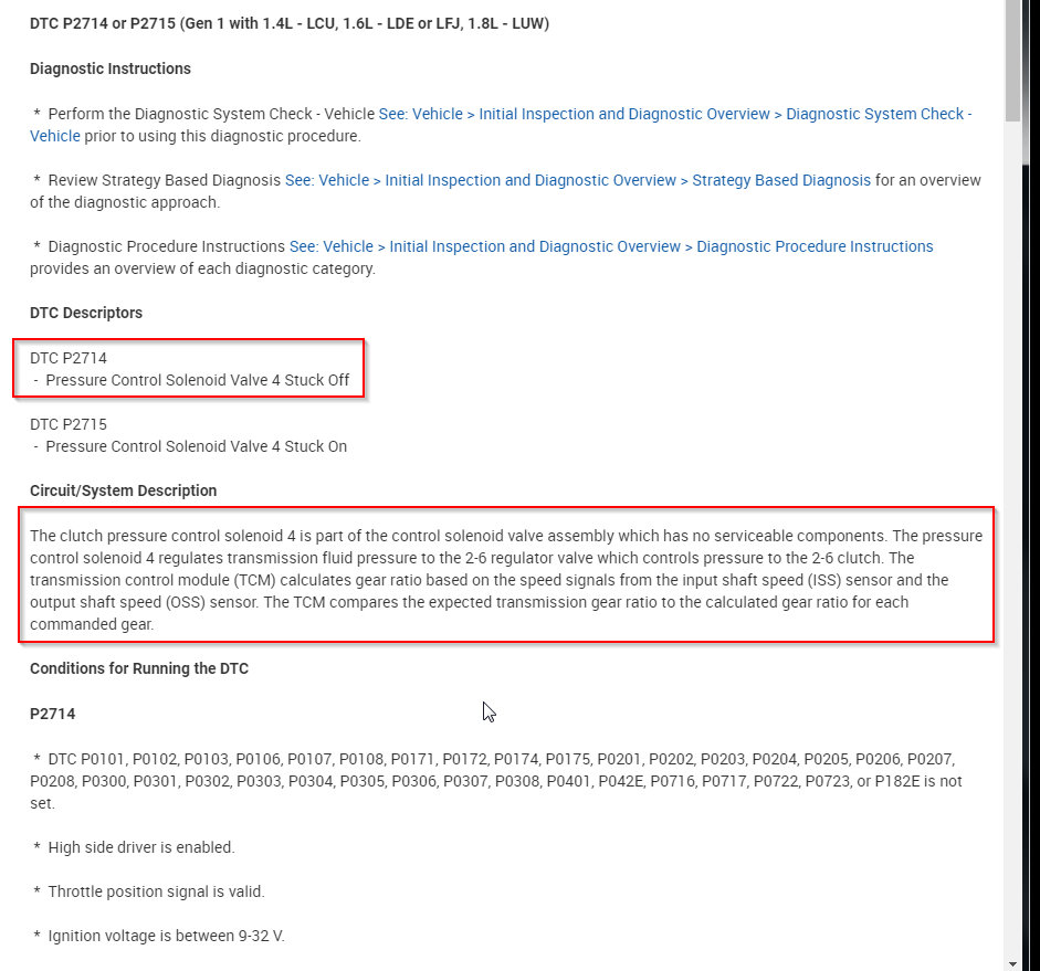

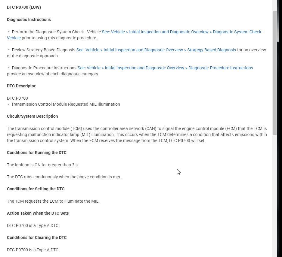

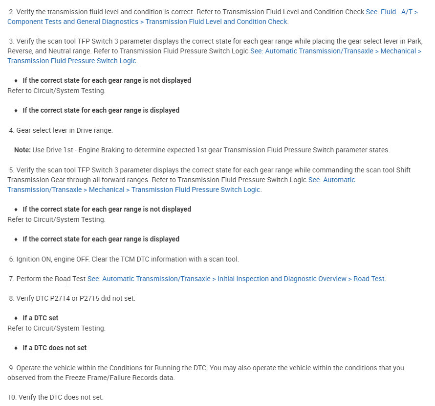

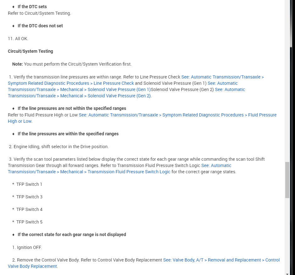

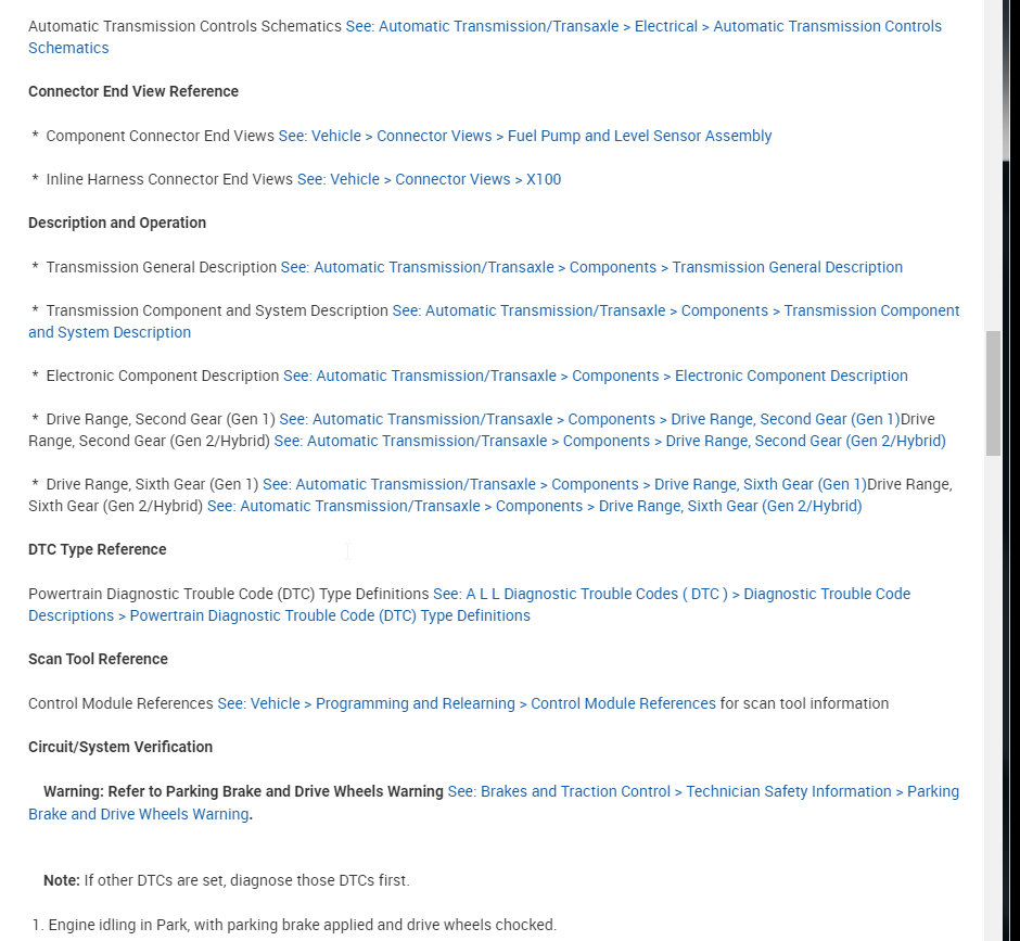

This is more than likely an internal issue and is not the TCM again. I attached the testing that needs to be done in order to find what the issue is. This is pretty lengthy and not the easiest testing to run through. If you are not sure about it then it would be best to take it to a shop. The P0700 is just a general info code and the P2714 is pointing to your issue. Unfortunately the only way to find out is to go through the test.
