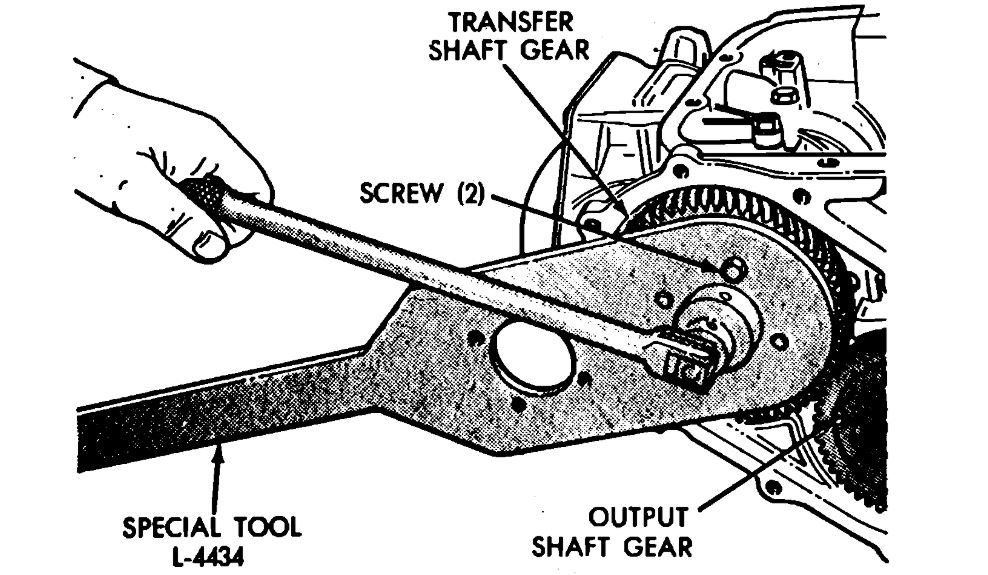

After it gets warm it doesn’t want to shift in to higher gear after you stop at a stop sign. Please help I want to be able to drive it this summer! Thanks in advance.

I would start by changing the fluid and filter in the transmission. If the filter is clogged, it will not shift.

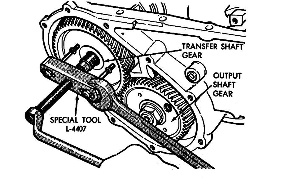

Beyond that, it could be the governor in the transmission which controls the shifting.
The governor assembly can be removed for reconditioning or replacement without removing the transfer gear cover, transfer gear and governor support. To remove governor, drain transmission fluid and remove transmission oil pan. Remove valve body, unbolt governor from governor support, then remove governor.
When cleaning or assembling the governor assembly, ensure governor valves move freely in governor body bores.
1. Remove rear cover attaching bolts and rear cover.
2. Using transfer shaft gear tool No. L-4434 or equivalent, remove transfer shaft gear retaining nut, Fig. 3.
3. Using transfer shaft gear puller tool No. L-4407 or equivalent, remove transfer shaft gear and shim, Fig. 4.
