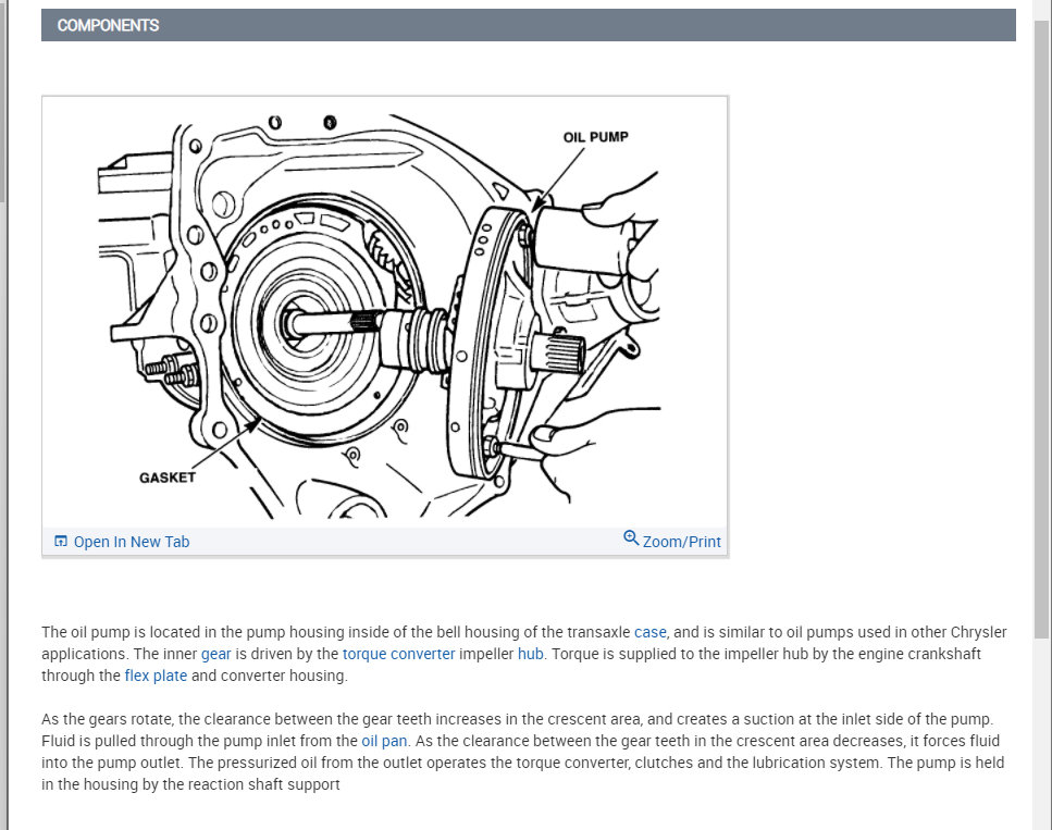

The other likely cause of this is a pump issue or other internal leak that only comes in when it gets hot.

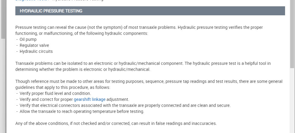

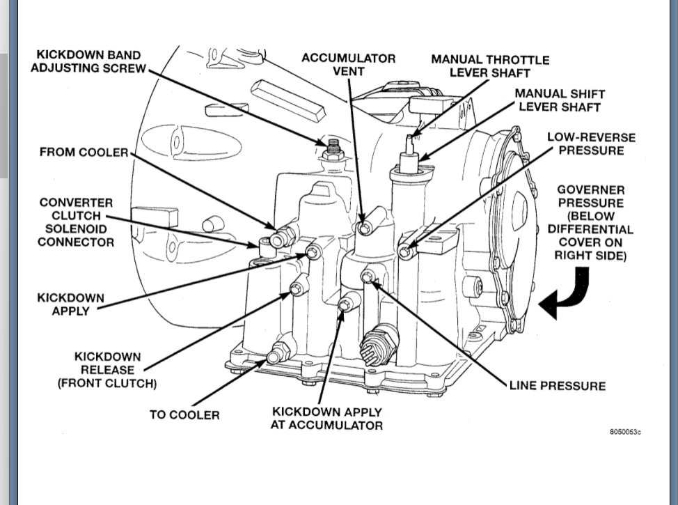

So that means if the fluid is ok, we are going to have to check the pressure of the unit to find out if the pump is building pressure. You simply put a pressure gauge in the line pressure port and then run the transmission in neutral and then in gear.
Please see the info below and let me know what you find with this, and we can go from there.
