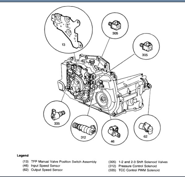

I have read the trouble code and it comes up with shift solenoid A electrical. I guess my question is, where in the transaxle is this located and do I have to remove the transaxle from the vehicle to repair it?
Jan 30, 2021 at 11:43 AM
DANNY L
  • 5,648 POSTS
Hello, I'm Danny.
Can you provide us with the code number? I've attached a picture below of solenoid locations in the transmission. Get back to us with code information and we'll go from there. Hope this helps and thanks for using 2CarPros.

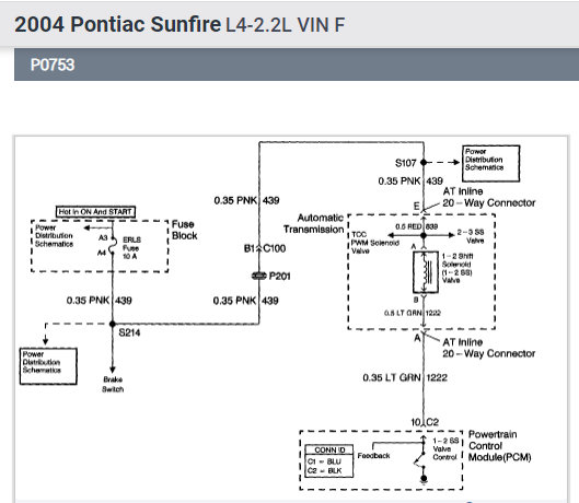

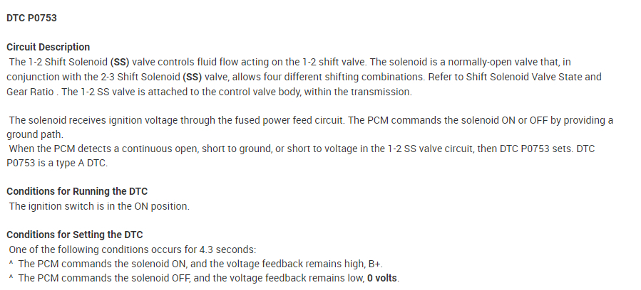

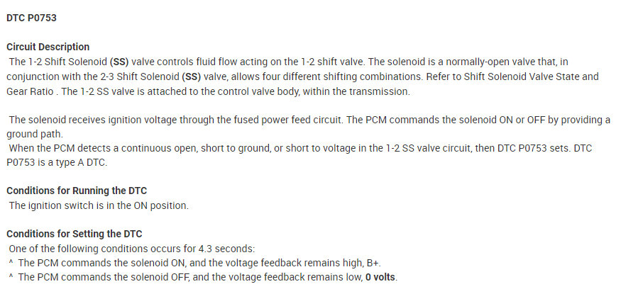

The code that came up was P0753 Shift solenoid A electrical.
Feb 1, 2021 at 2:37 PM
DANNY L
  • 5,648 POSTS
Hello again.

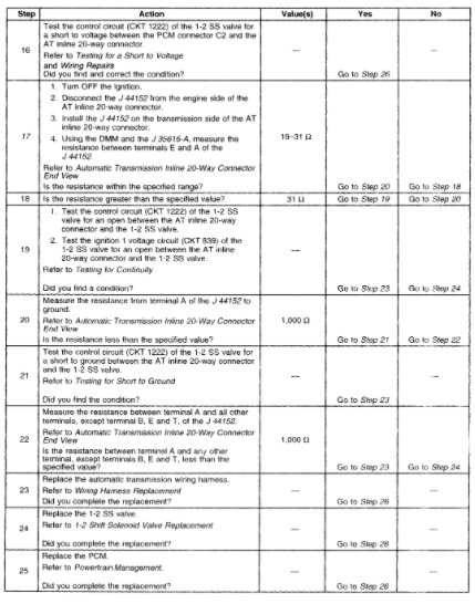

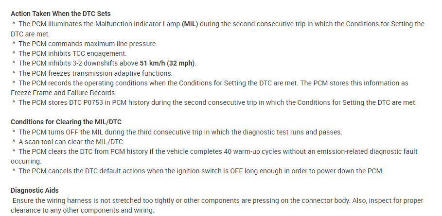

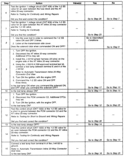

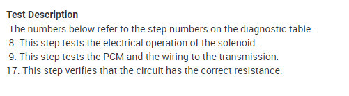

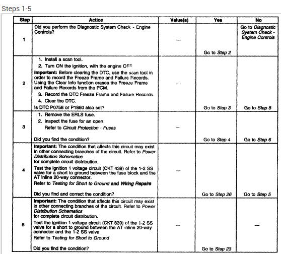

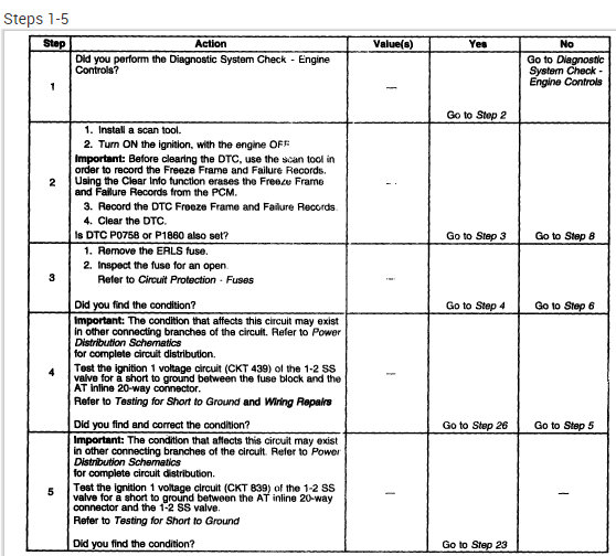

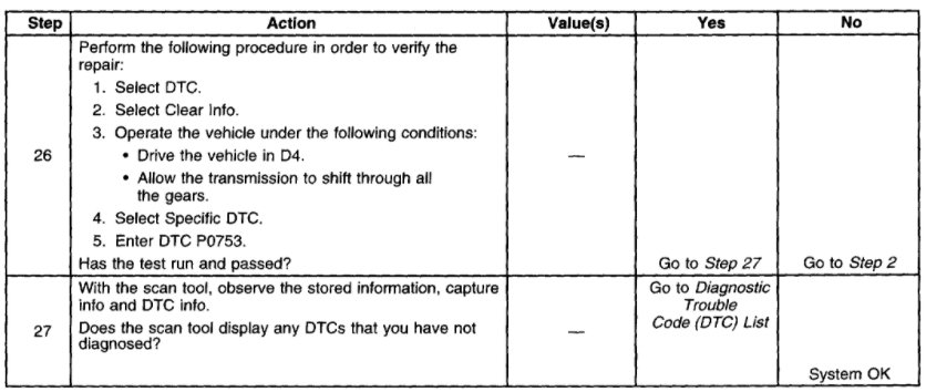

Here is what I found relating to that transmission code. Here is a tutorial showing how to test electrical wiring:
I've attached picture diagnostic steps below for code P0753 on your car. Hope this helps and thanks again for using 2CarPros.
