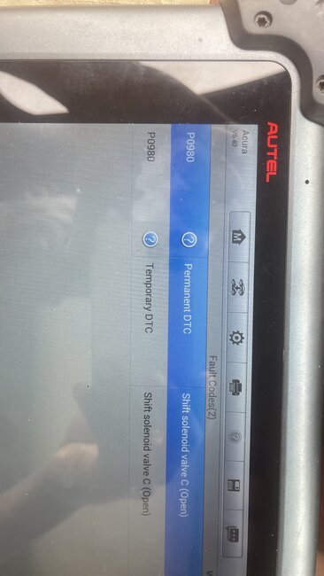

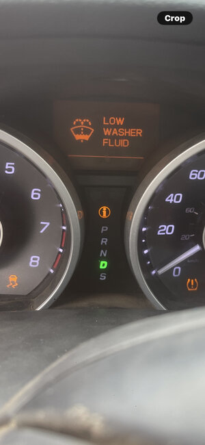

My Acura ZDX does not engage in reverse, drive D lights keep blinking with a P0980 shift solenoid open circuit. May be have the exact location and image of this solenoid. Tcm wiring diagram. I have actually tested resistance on alll 4 solenoids I get averagely 5.4 on wlll 4, the the 3 small solenoids, I get 16.5 ohms.

the solenoid resistance readings they gave sound believable, so I’d lean toward a circuit, connection or TCM side issue before calling the solenoid bad. A P0980 code is an electrical circuit fault for Shift Solenoid C. I would test the solenoid C for 16 ohms, (about) Also, when you remove it check for metal shavings which can clog the solenoid port. Also, I would remove the PCM connector and transmission electrical connector for corrosion, this is common. The no reverse symptom may be because the transmission is in limp mode. First, clear codes, then retest the gear. Please let me know what happens.

I did clear codes but they won’t go, meaning indeed is an open circuit. Does this have a separate transmission module or is integrated in the PCM? If separate may I have the location

What i experienced, at first the p light shows red while the D keeps blinking, when i shift to R N D S, I could see it shifting even on live data as well on dash. After disconnecting the PCM with the negative battery disconnected, I did not see any corrosion. When I fitted every connector, the P light no longer appears and when I shift gear, I get no signal R N S won’t show anymore.

The codes can’t be cleared, it remains even after clearing. They are 4 big solenoids and 3 small solenoids, I got 5.9 ohms resistance on the big solenoids, and on the small solenoids I got 16.9 ohms of resistance.
