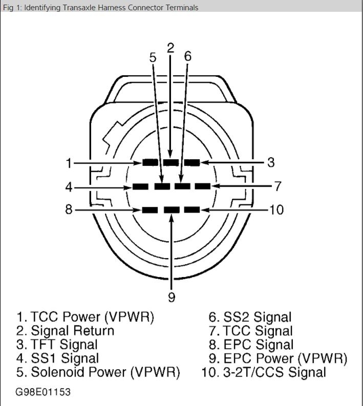

Changed transmission shifting problem and speedometer not working as long as you manually shift it works. will valve-body cause it not to work? it had a white plug-in I put a brown one on it or should I put a white one back on it?

Transmission I took out had a white tin pen connector and I put in had a brown connector for a valve body
Mar 24, 2018 at 6:50 PM
VELVA BLARE
White plug is 10 pin connector on top of transmission valve body . Transmission I put in car has a brown 10 pin connector for valve body. I was told the brown color connector has a history for failure? Problem has to do with turbine shaft input sensor failing to read.

Have you retrieved any trouble codes from the pcm or tcm?
Here also is a test procedure for the shift solenoids.
TEST A: SHIFT SOLENOIDS
Electronic Diagnostics
Ensure transaxle harness connector is in acceptable condition. Repair as necessary. Ensure transaxle harness connector is fully seated. Connect NGS tester or equivalent to DLC. Perform KOEO test until Continuous Memory trouble code(s) have been displayed. See QUICK TEST . Enter output test mode. See ADDITIONAL SYSTEM FUNCTIONS . Select ALL ON mode. Push START to turn outputs ON. Push STOP to turn outputs OFF. If vehicle enters output state, go to next step. If vehicle will not enter output state, see SCAN TOOL UNABLE TO COMMUNICATE .
Check Electrical Signal Operation
Turn ignition off. Disconnect transaxle harness connector. Inspect condition of connector and repair as needed. Turn ignition on. Using DVOM, connect positive lead to transaxle harness connector terminal No. 5. See Fig 1 . Connect negative lead to suspect solenoid circuit. While monitoring DVOM, press START and STOP to cycle solenoid output on and off. If voltage changes at least .5 volt, go to step . If voltage is unaffected, go to next step.
Fig 1: Identifying Transaxle Harness Connector Terminals

Check Continuity Of Solenoid Signal & VPWR Harness Circuits
Ensure ignition is off. Disconnect PCM 104-pin connector, and inspect it for damaged pins, corrosion and loose wires. Repair as necessary. Install breakout box, leaving PCM disconnected. Measure and record resistance between breakout box test pin No. 1 and transaxle harness connector terminal No. 6. See Fig 1 . Measure and record resistance between test pin No. 27 and transaxle harness connector terminal No. 4. Measure and record resistance between test pins No. 71 and 97 and transaxle harness connector terminal No. 5. If any resistance is greater than 5 ohms, repair open circuit. Connect all components. Disconnect breakout box and repeat QUICK TEST . If each resistance is 5 ohms or less, go to next step.
Check Solenoid Harness For Shorts To Power & Ground
Measure and record resistance between breakout box test pins No. 1 or 27 and test pins No. 71 and 97. Measure and record resistance between chassis ground and test pin No. 1 or 27, and between chassis ground and test pins No. 24, 51, 76, 77, 91 and 103. If any resistance is less than 10 k/ohms, repair short circuit. Connect all components. Disconnect breakout box and repeat QUICK TEST . If each resistance is 10 k/ohms or more, go to next step.
