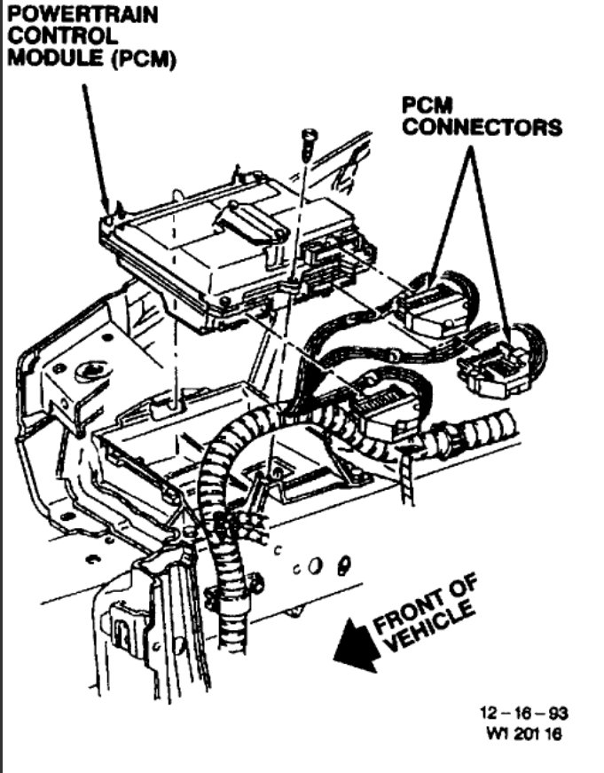

When i drive my car it will not shift into overdrive. But after a few miles i can stop and shut it off, then restart and drive again and it will shift properly.

Sometimes it will. And sometimes not. I have had it plugged in but it has shown nothing.

Do you have a scanner that will read transmission codes? Most inexpensive ones won't.

O'Reilly has tried but nothing.
Nov 19, 2017 at 9:01 AM
  • 110,248 POSTS
Usually, the parts stores only have scanners that will read engine codes. With that in mind, confirm with them that they had one that will.

Ok i will ask them. But in your opinion is this a possible chance of jyst a short somewere

To me it sounds like you have ECM that is going out becasue when you reset the system it starts working again. Have you serviced the transmission lately?
Here is a guide to give you an idea of what you are in for when doing the job.
Also here is the location of the ECM I would try to get a used one and plug it in to see if this is the problem.
