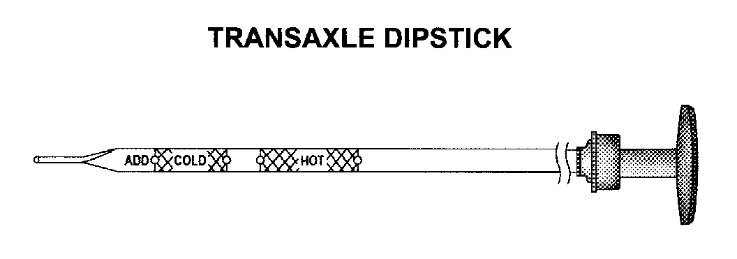

Procedure for Checking Fluid Level
Check the fluid level while the transmission is at normal operating temperature. this occurs after at least 15 miles (25 km) of driving. At normal operating temperature, which is approximately 180 °F (82 °C), the fluid cannot be held comfortably between the fingers.
To check the fluid level properly, the following procedure must be used:
1. The vehicle must be on level ground.
2. The engine should be running at curb idle speed for a minimum of 60 seconds.
3. Fully apply parking brake.
4. Place the gear selector momentarily in each gear position ending with the lever in P (PARK).
5. Remove the dipstick, wipe it clean and reinsert it until seated.
6. Remove the dipstick again and note the fluid level on both sides. The fluid level should be in the crosshatch area at normal operating temperatures. If the fluid is low, add as required into the dipstick tube. Do not overfill.
See pic 1

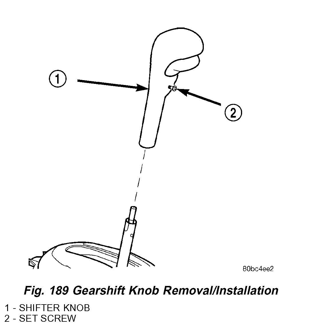

pic 2

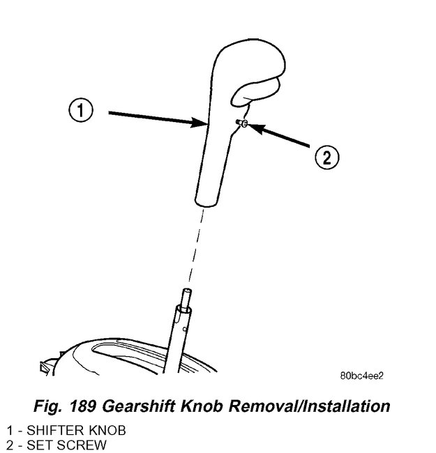

1. Loosen set screw and remove knob from shifter handle (Fig. 189).

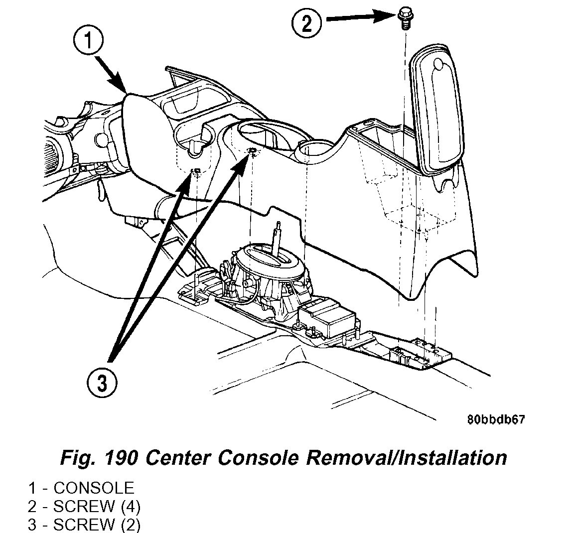

pic 3
2. Remove the center console assembly as shown in (Fig. 190).

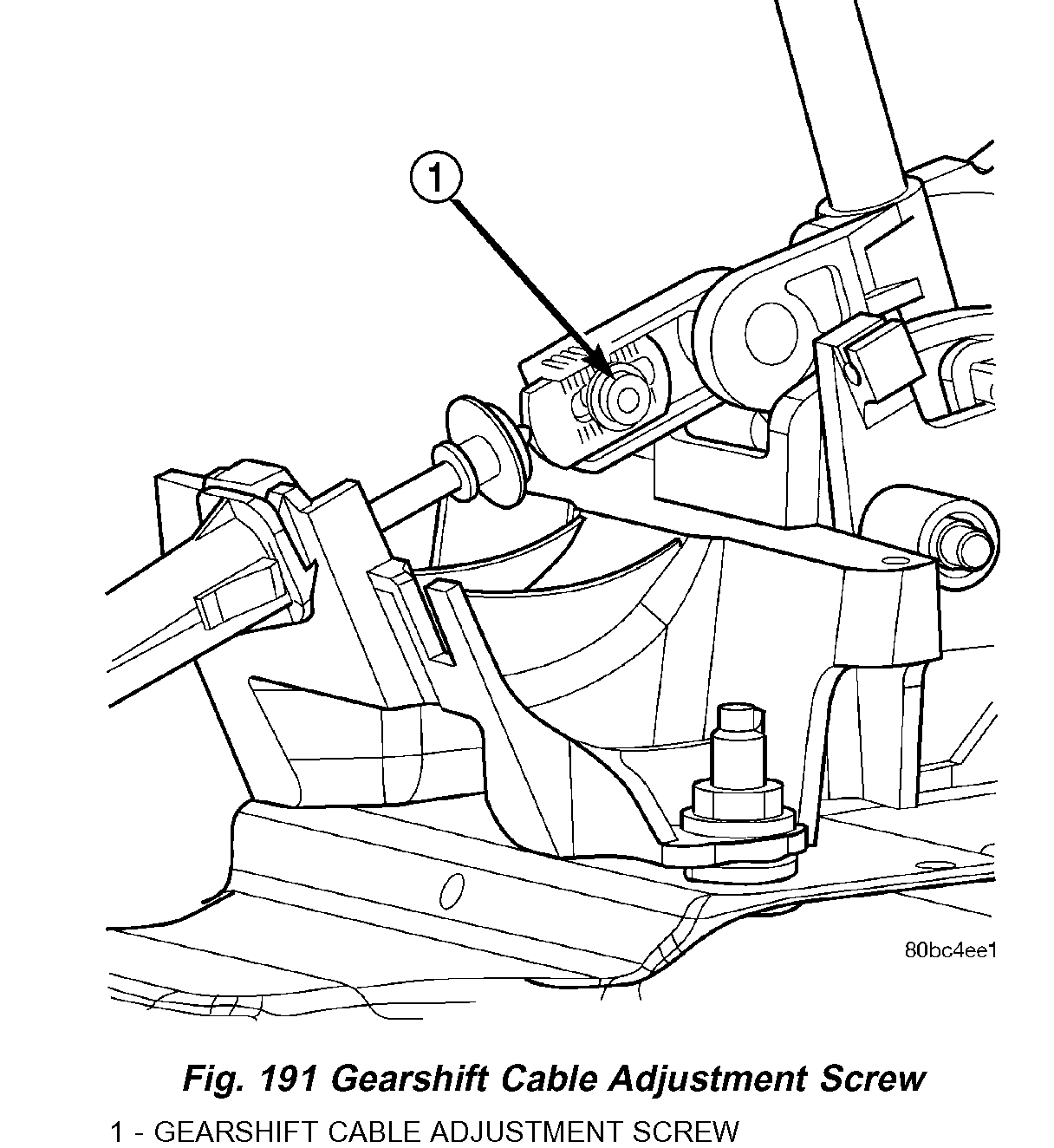

pic 4
b. Loosen shift cable adjustment screw (Fig. 191).
c. Move transaxle manual lever to the PARK. Verify transaxle is in PARK by attempting to roll vehicle in either direction.
d. Tighten shift cable adjustment screw to 8 Nm (70 inch lbs.) torque.
4. Verify proper cable adjustment. Engine should start with the shifter lever in PARK (P) and Neutral (N) positions only.
5. Install center console assembly (Fig. 190).
6. Install gearshift knob and tighten set screw to 2 Nm (15 inch lbs.) torque (Fig. 189).
