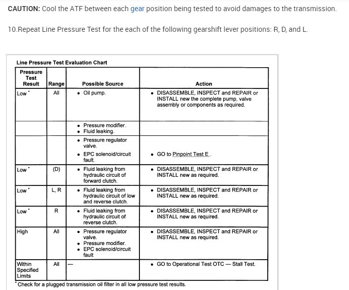

Transmission runs smoothly, but around 3,500 to 4,000 RPMs it will not shift out of second gear into third gear.

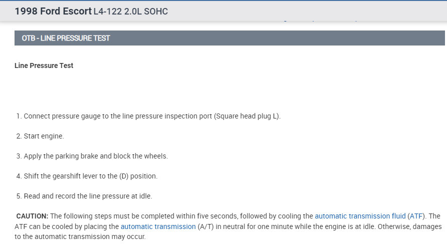

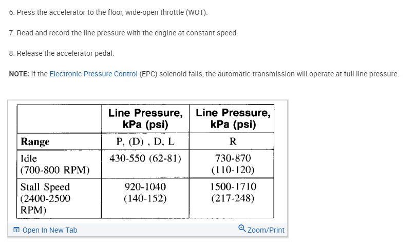

Without codes, it will become a guessing game. In this case, I would likely check line pressure next to see if it is low specifically when in reverse. Reverse requires the highest amount of pressure to engage.
I attached the directions below. You will need a transmission pressure tester, but you should be able to get one at a parts store.
Take a look and let me know your thoughts.
