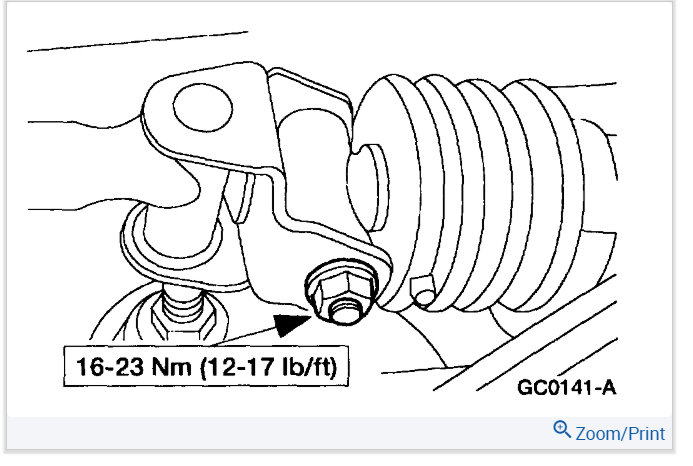

I am having problems getting my five speed into mainly first, second, and fifth gears and sometimes even reverse. Can someone please give me an idea of what might need to be fixed and maybe how much also it will cost me?
Jul 20, 2018 at 5:24 PM
  • 55,746 POSTS
Yes, it sounds like the clutch disc is falling apart which means the clutch will need to be replaced. Here is a video that will give you an idea of what you are in for when doing the job:
https://youtu.be/6N6b5F2ChyE
Jul 22, 2018 at 5:40 AM
THERONVAREC84

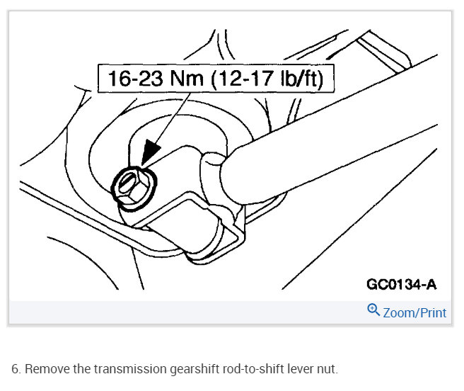

Replaced the clutch already, it has to do with the linkage or cables I believe sir.
Jul 22, 2018 at 5:42 AM
  • 55,746 POSTS

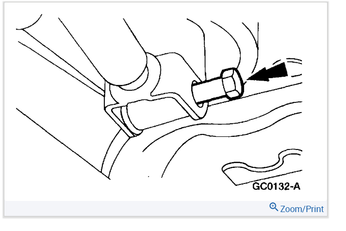

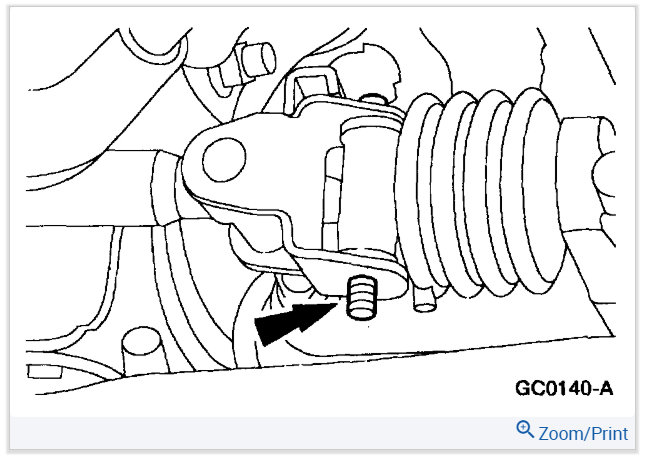

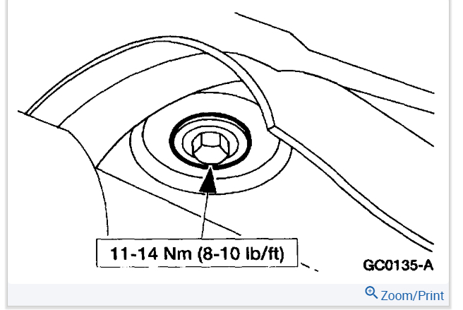

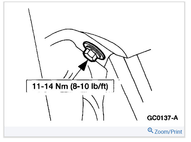

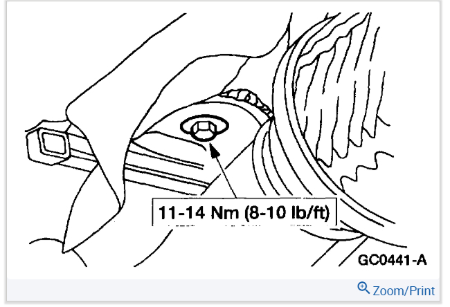

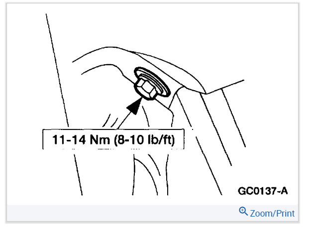

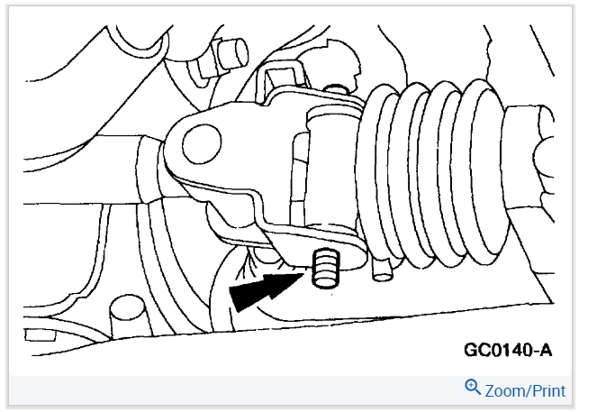

That could be as well. Here is the shift linkage diagrams to help you replace the shift rod which the bushings can wear to in.
