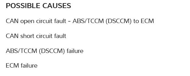

To take off I to put it in low gear. Once I get moving I place it back in drive. Every time I stop. That is just what I was told by seller. Now I have car in possession. Car is not starting. I need to fix this problem first. Scanned it codes P1637 and code P1000 going to do research. I think I i's the fuel pump. Turns over. Ordered electric fuel pump parts of the fuel pump assembly. Car sat for years. Changed out fuel filter and oil. Will try and remove old gas. How can I fix this?

both of those codes mean that one or more modules are not talking to each other a mechanic must look at this to get it fixed. probably seller did not tell you that because you would not buy it. It is a can/bus problem it is more like an ECM or one of the modules listed. See pic.
