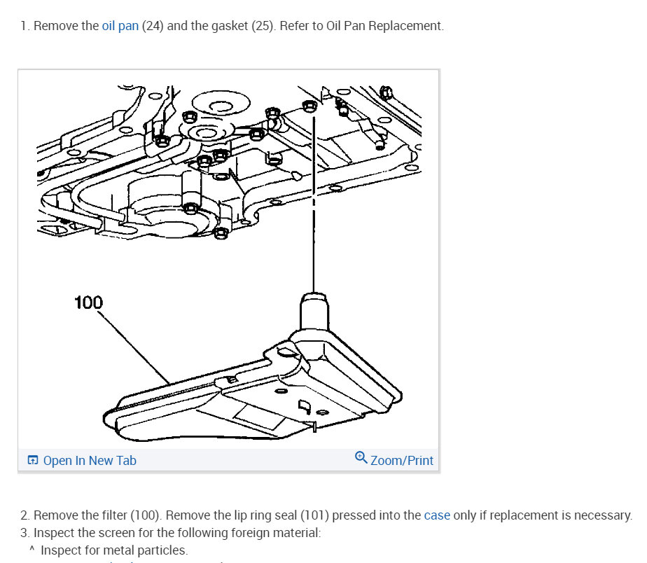

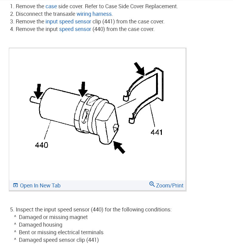

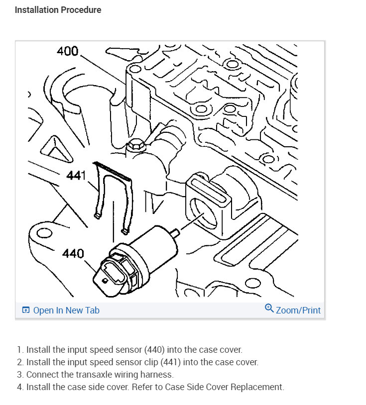

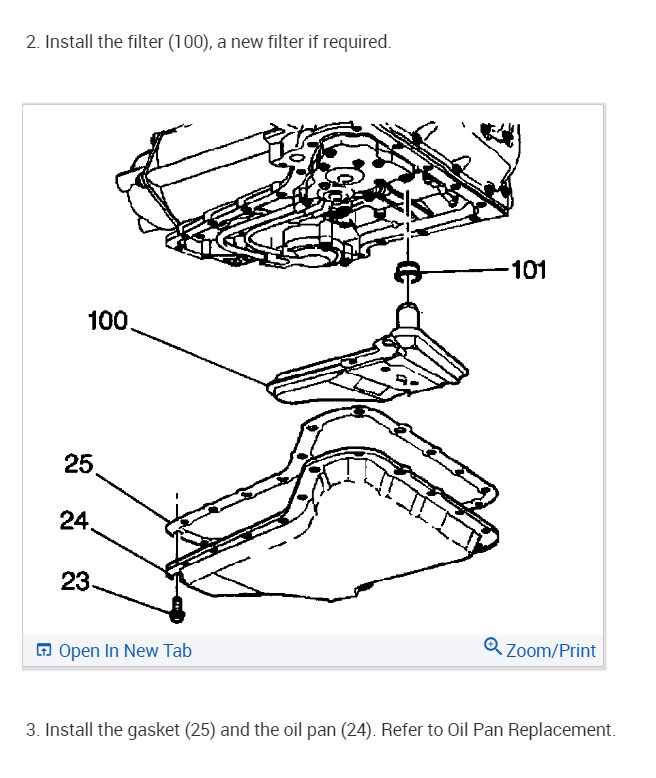

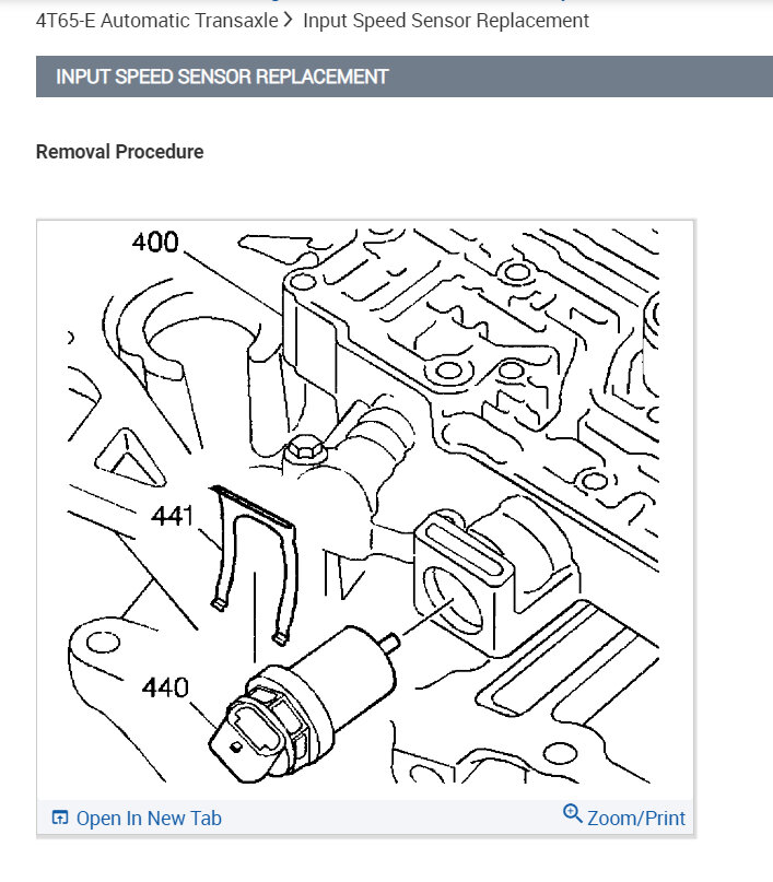

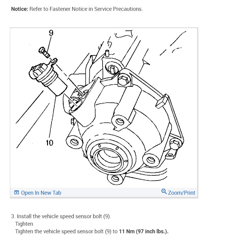

Is the speedometer working? I would try to change out the input shaft sensor because if it is off a little the transmission won't shift, and it won't have a code.
This guide may help as well:

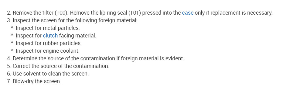

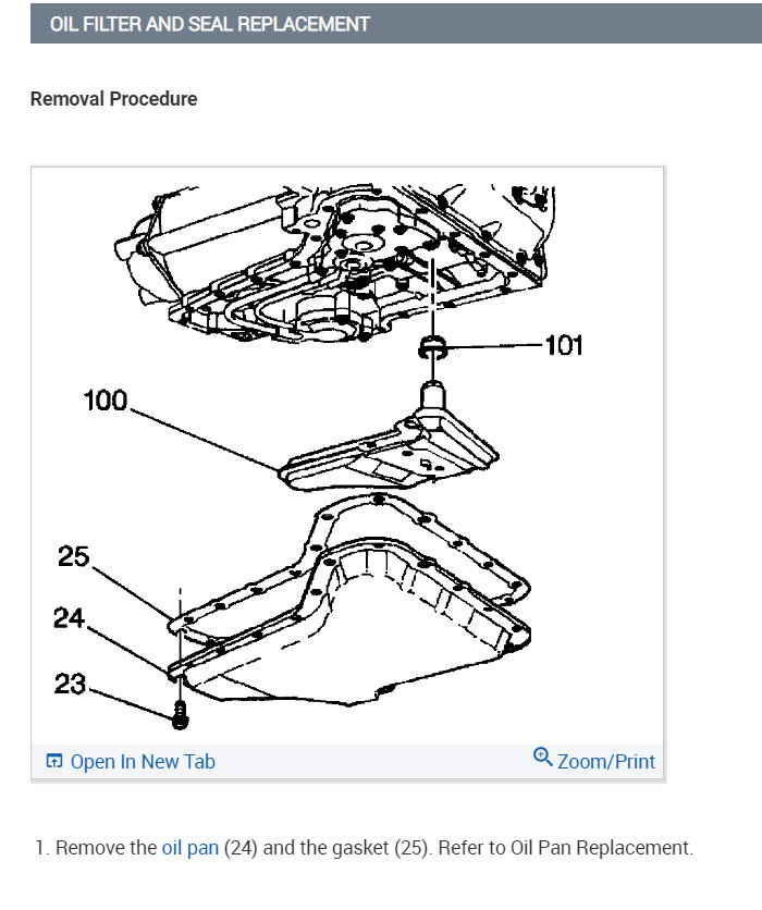

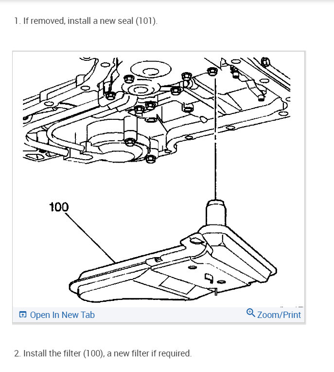

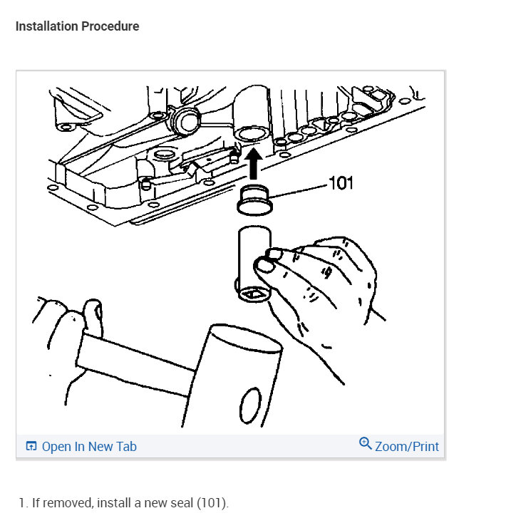

I have also seen the filter fall out of the case which lowers fluid pressure which can be a problem as well. Check out the images (below). Please let us know what you find. We are interested to see what it is.
Feb 3, 2023 at 5:19 AM
JONCHRIST
  • 5 POSTS

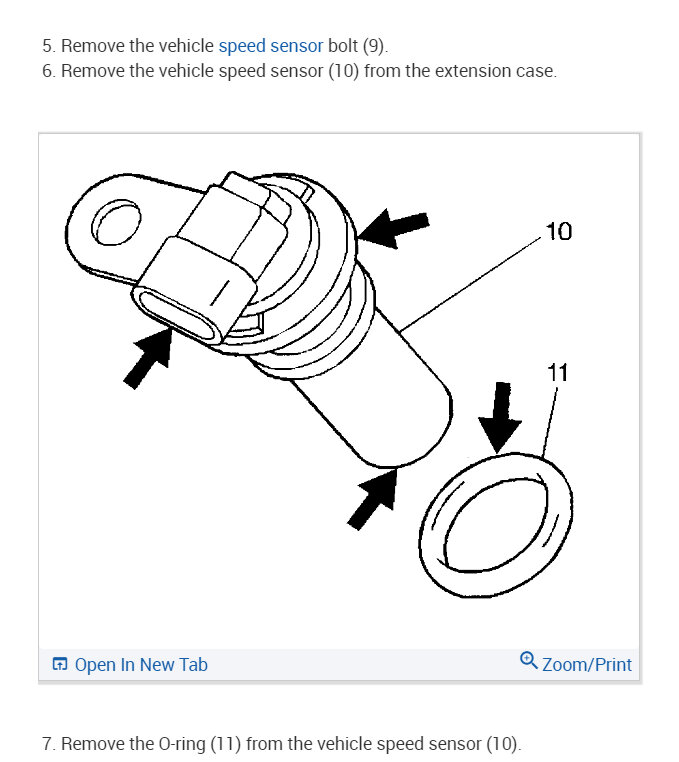

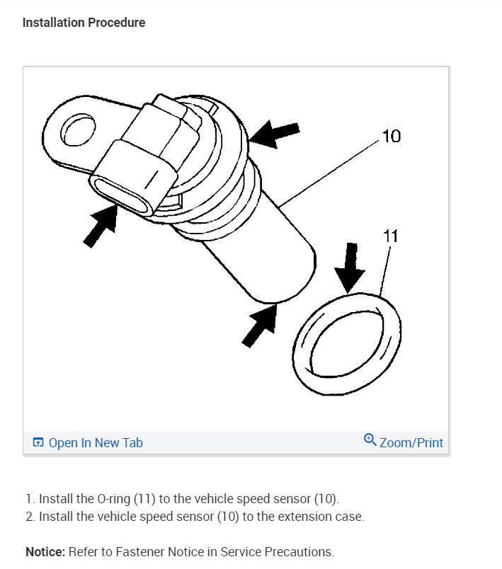

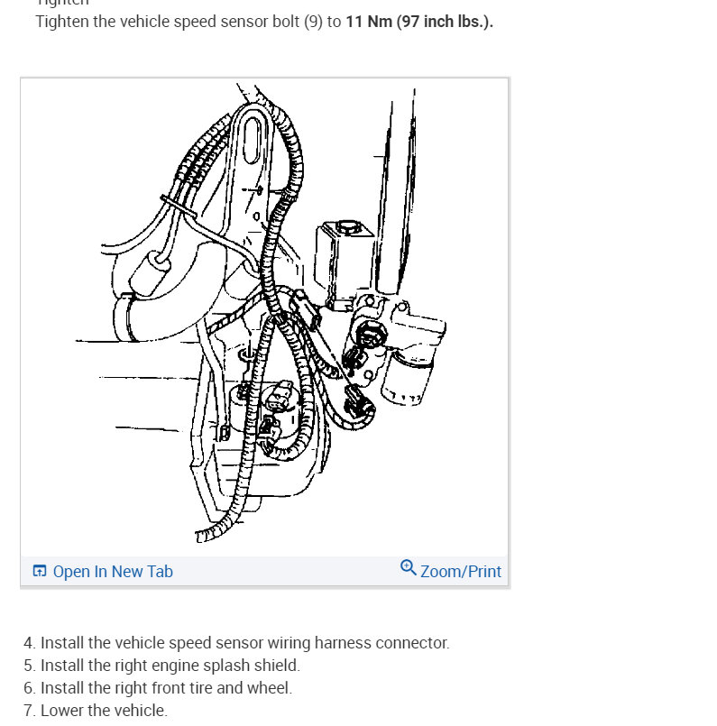

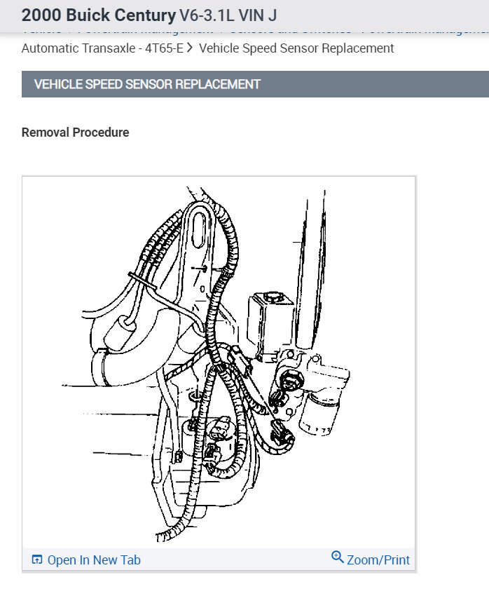

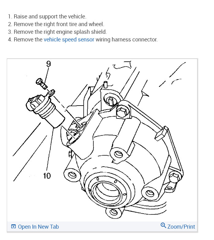

Hello!! Thank you for asking me that. The answer is no, the speedometer is not working. hasn't since i became unstuck.
Feb 3, 2023 at 6:14 AM
  • 55,694 POSTS
Yep, that will cause a shifting problem, please check the wiring to the sensor first, here is the location of the vehicle speed sensor so you can check it out. Please let me know.
