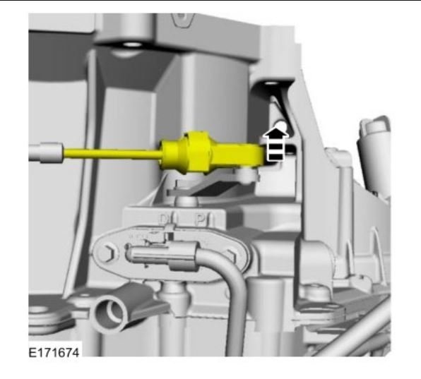

The car battery is completely drained and I am trying to shift it into neutral from park. Is there any way of overriding the lock on the gear shifter to move it to neutral?

It would be easiest to remove the air filter housing and release the cable from the transmission. You just need a screwdriver to pop off the end from the linkage.
Selector Lever Cable
Removal
1. Refer to: Air Cleaner Outlet Pipe See: Air Cleaner Housing > Removal and Replacement > Air Cleaner Outlet Pipe (303-12A Intake Air Distribution and Filtering - 2.0L Duratec-HE (125kW/170PS)- MI4, Removal and Installation).
2.
3.
1. Release the locking tab on the selector lever cable clip.
2. Remove the selector lever cable from the selector lever cable bracket.
