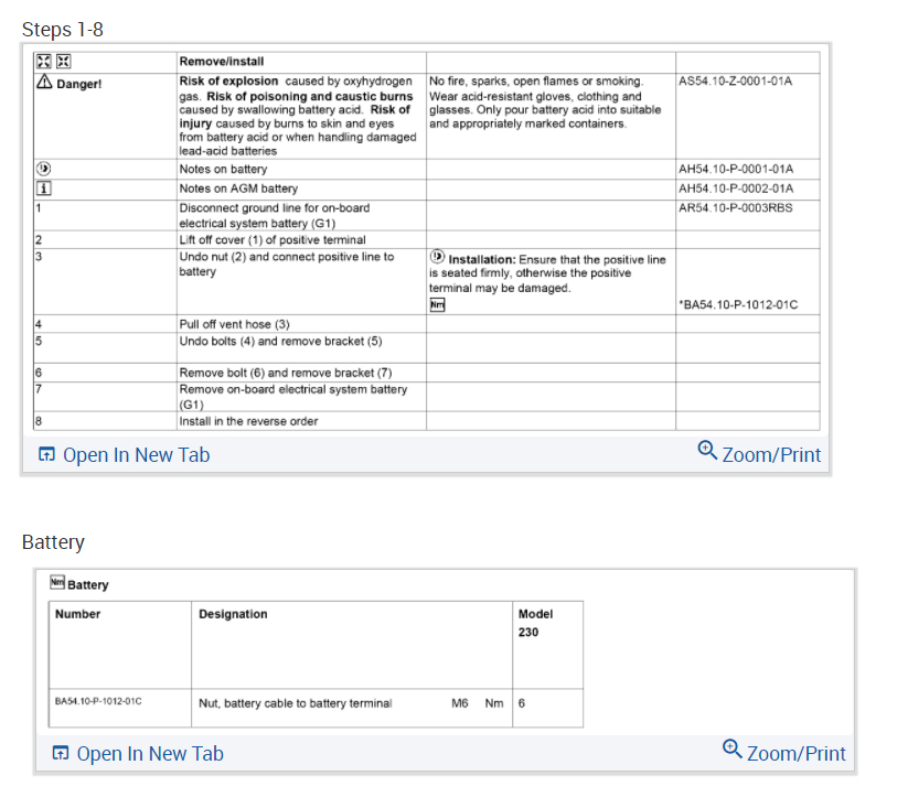

  • 55,433 POSTS
No, you must get the battery working to activate these items. Let change the battery out. here is a guide to help you step by step with instructions in the diagrams below to show you how on your car:
https://www.2carpros.com/articles/how-to-replace-a-car-battery

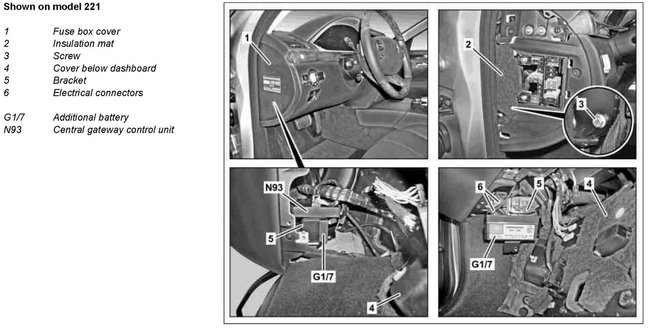

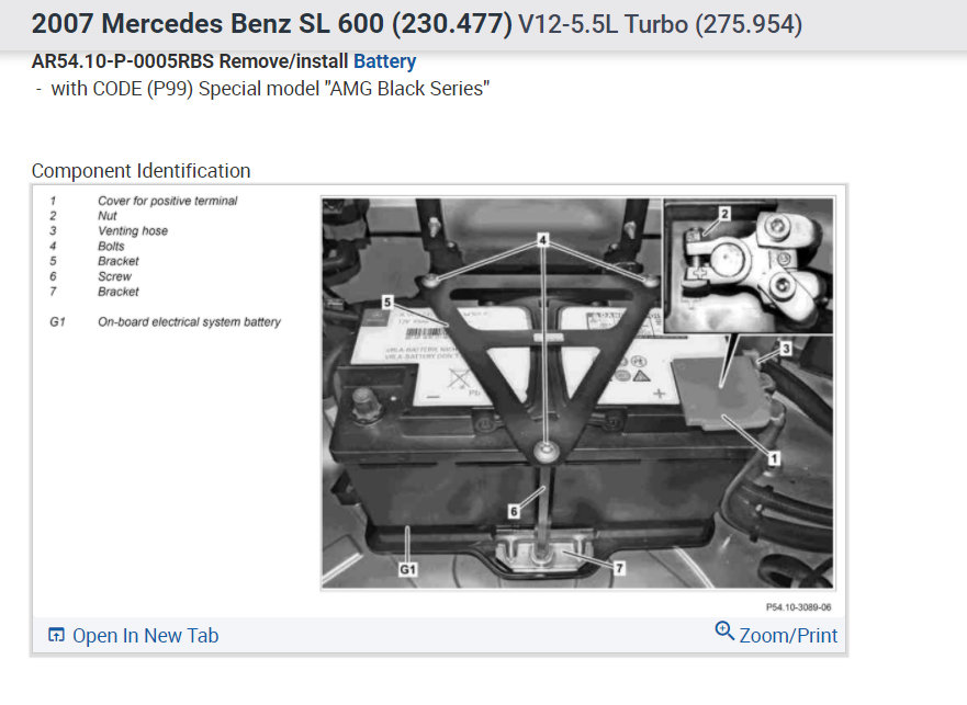

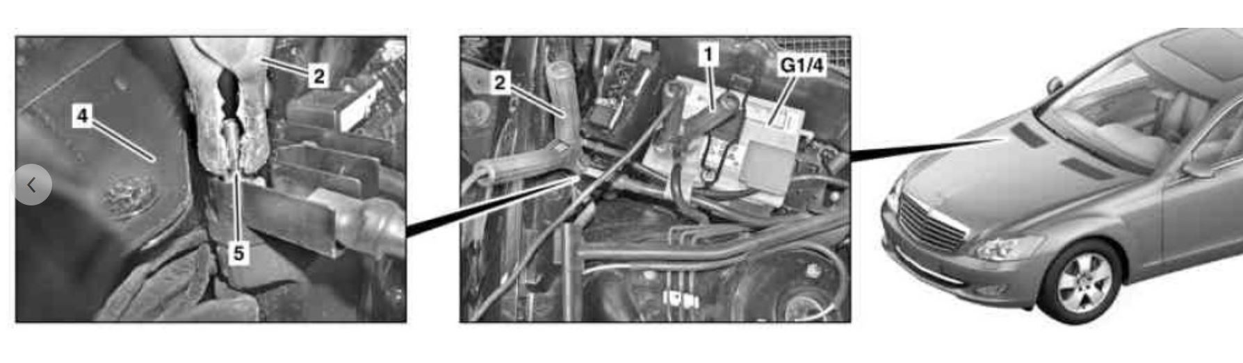

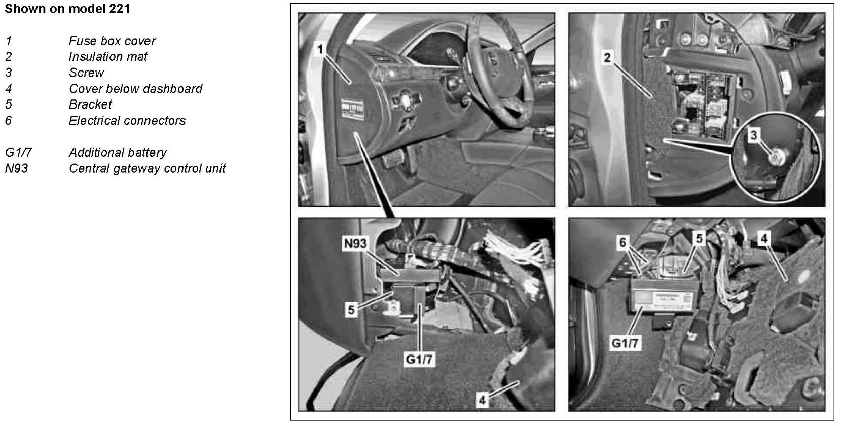

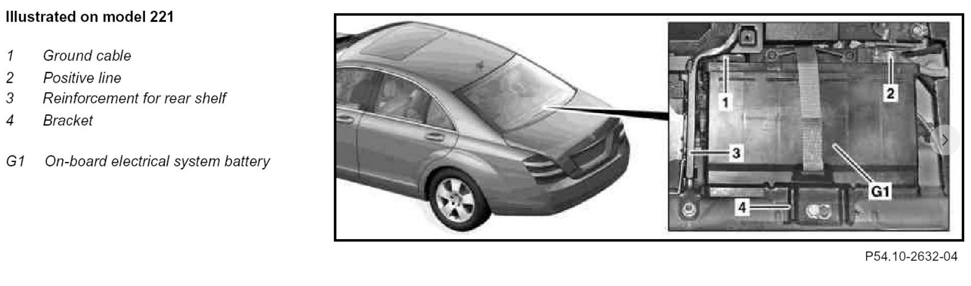

STEVE W.
  • 15,349 POSTS
There should be at least two batteries in that car. The starting battery electrical system battery and a possible third battery that goes in the end of the dash on the drivers side. Most have the third battery because of the security and safety options.
The starting battery is under the hood tucked up under the cowl on the right side. Then there is the electrical system battery in the trunk on the right side under the access panel and the third one in the end of the dash. All three need to be good for all systems to work.
Mar 7, 2021 at 10:35 AM
