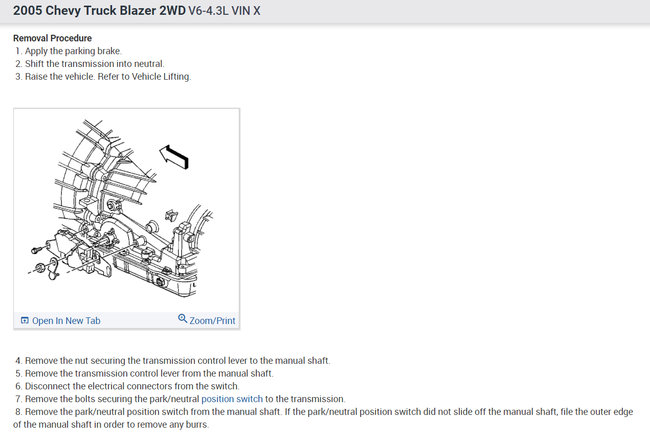

The truck will not go in any other gear but first gear.
Aug 23, 2022 at 3:36 AM
  • 55,721 POSTS

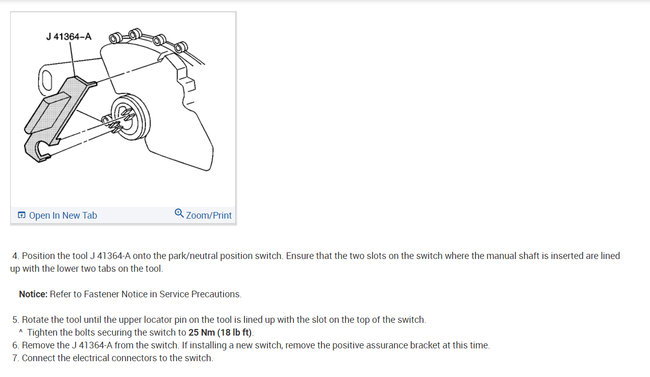

It sounds like you have a gear range sensor that is not working, but to be sure we need to run the codes this guide will help. I have also included the gear range replacement instructions case you need it. you can get a code scanner from Amazon for about $20.00.
Here is a guide/video to show you how:
Here is a scanner link:
