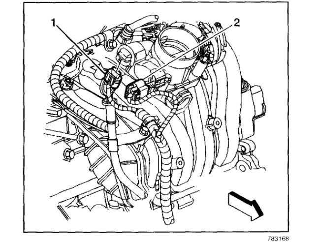

Just started not shifting out of first gear. It sat for nine months.

Is the check engine light on?
The throttle position sensor controls the shift points for the transmission. If it is bad, it should set a code.
I would start by changing the fluid and filter as nine months is a long time to sit.
1. Remove the air cleaner outlet resonator.
2. Disconnect the throttle position (TP) sensor harness connector (2).
3. Remove the throttle TP sensor screw.
4. Remove the TP sensor and seal.
