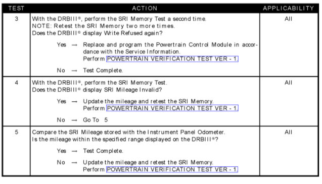

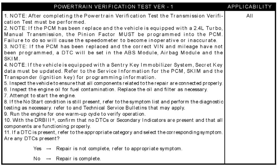

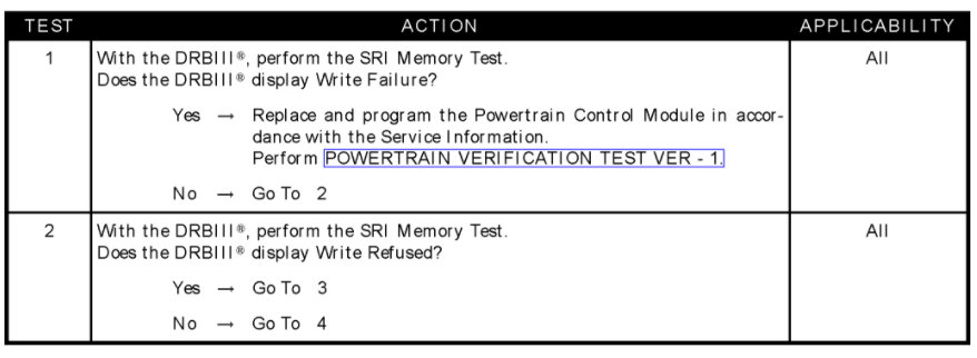

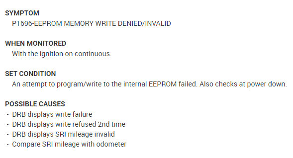

Hello again.
Here are diagnostic steps for code P1696. This code has a lot to do with the PCM- powertrain control module. I've attached the steps below. Let us know what you find and keep us updated. Hope this helps and thanks again for using 2CarPros.
Danny-
Feb 24, 2021 at 6:16 AM
JBOB93
  • 8 POSTS
I am not sure I’ve seen one of those types of scan tools. I’m just curious if that air restriction could cause that code because of the PCM not getting a proper reading.
DANNY L
  • 5,648 POSTS
Hello again.
Yes, that is a Dodge specific scan tool with Dodge software. The basic scanners-code readers like from Pep Boys don't even come close to reading those type of faults or information. You can find them online for $4,000.00 or maybe a neighbor or friend can let you borrow. Have you taken the intake system apart to see if there is a restriction? Thanks again for using 2CarPros.
