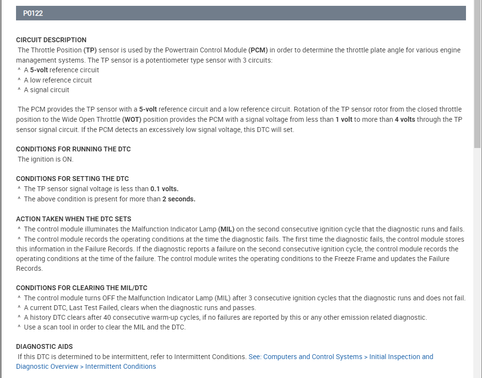

Vehicle has been worked on for about two years now. I got it without knowing all that was wrong with it. It drove, I didn't see anything wrong under the hood, but apparently it was junk when I got it. That being said, it's drivable now, but was told there are still a couple of codes. One indicates the throttle sensor as included with the vacuum code. I can tell sometimes, it doesn't want to shift. I know it's not the transmission, and the engine is great. Could it just be a vacuum issue and not the throttle? The reason I'm wondering is because sometimes, the acceleration gets to above 4RPMs, and then shifts. Or, I have to let off the gas in order for it to shift. It couldn't also be the timing belt could it? I'm thinking it could also be a spark plug issue, but no codes come up for that. The vacuum code encompasses a myriad of issues that could be causing this delay in shifting, I'm asking if I should replace the throttle sensor to get started on fixing the issue. Thanks so much for all your help!

There are three codes recently. PO122, 300, 449. 449 is the EVAP Vent Valve, and the 300 is the misfire. However, I just gassed up the truck today and the shifting had absolutely no issue. So maybe I need a new gas cap? I also checked the transmission fluid a couple months ago. It was drowning so had the guy drain it to proper level. I get the fluids checked regularly, almost every week. Mom's boyfriend says that I need to replace the entire exhaust system, catalytic converter included. I don't think I need all of that. The last time I listened to him, I got my other Blazer taken away even though I bought it from the family he knows.

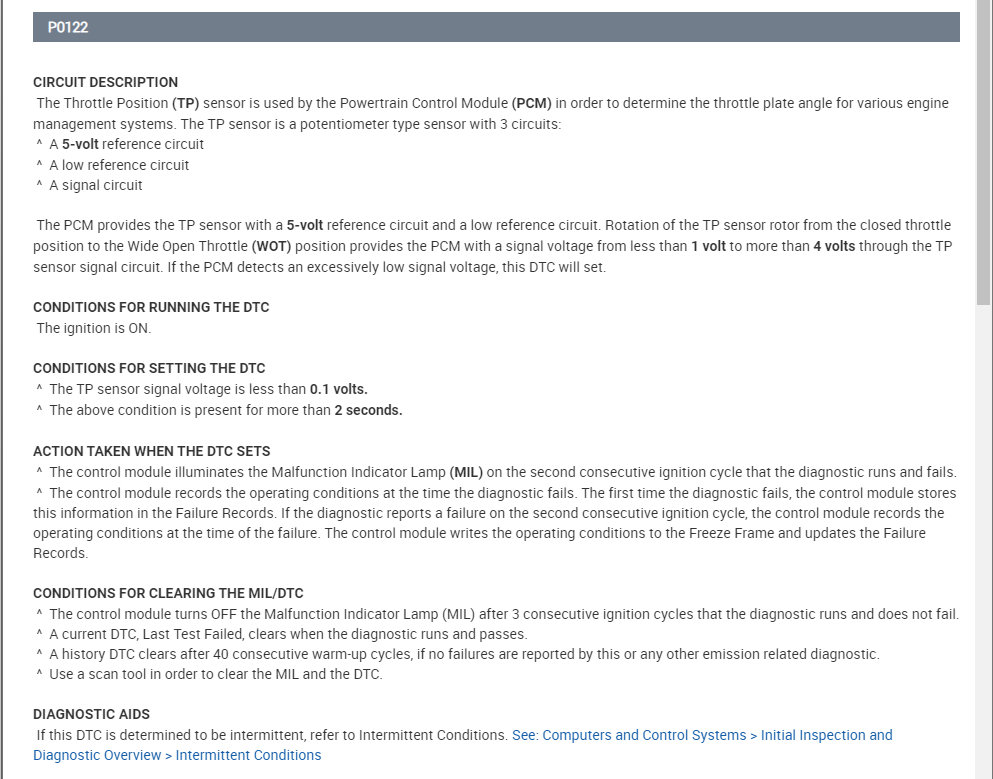

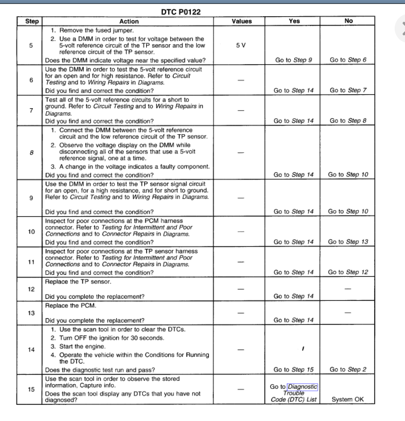

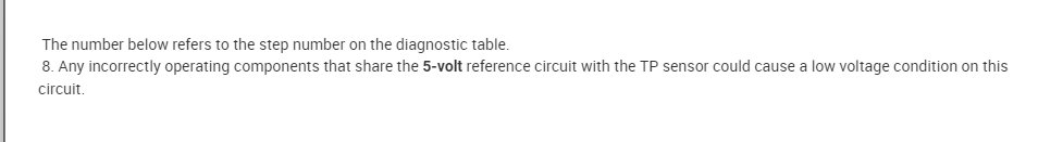

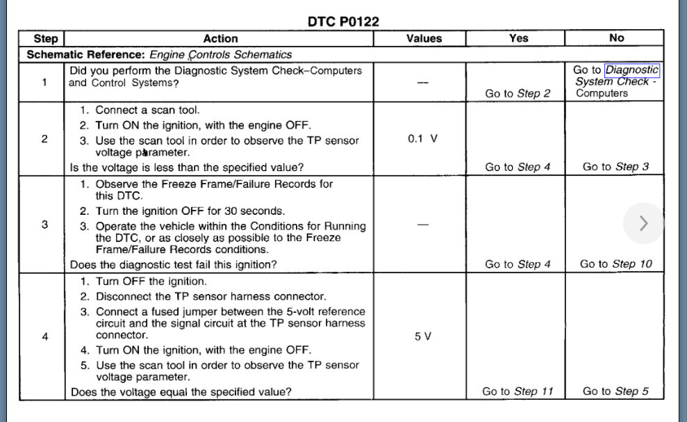

Okay. That is all positive news. So, let's address the throttle position sensor code first because that can cause shifting issues. The throttle input is used for shifting so that needs to be accurate.
I am attaching the testing below as this could just be a sensor issue but if we have a greater 5-volt reference issue then that may be causing all your issues.
Let me know what questions you have. Thanks
