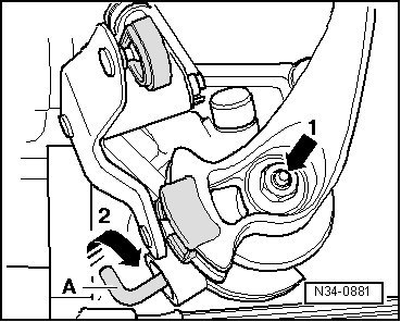

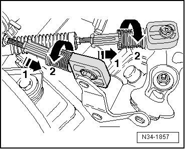

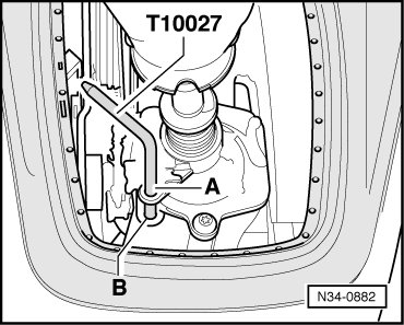

My car is currently stuck in 5th gear. the stick shift moves semi freely. I'm able to pull it back and forth all I want to however it doesn't move side to side in the slightest. along with that it also doesn't lock in any of the even gears but does lock in the odd. The dealership said my shifter and selector cable are binding. Is there any way to stop this without a whole replacement?

Other than replacing parts, the only thing I can think of would be to check adjustment. Here are directions that explains how it's done. The attached pics correlate with the directions. Take a look through them and see if anything is helpful.

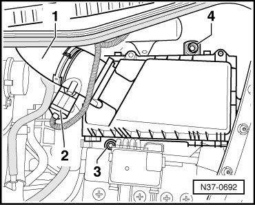

- Disconnect intake air duct - 1 - and connector - 2 - from Mass Air Flow (MAF) sensor (G70).
pic 1
- Remove bolts - 3 - and - 4 -.
- Remove complete air filter.

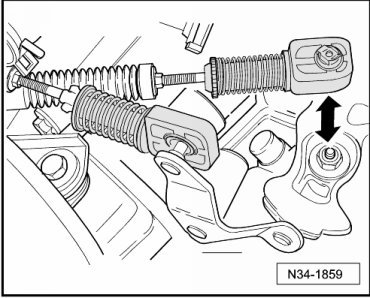

- Pull locking mechanism on shift cable and on selector cable toward front to stop in direction of - arrow 1 - and then lock toward left in direction of - arrow 2 -.
pic 2
Secure shift rod as follows:
- Press down shift rod direction of - arrow 1 -.
pic 3
- While pressing down shift rod, rotate bracket - A - upward in direction of - arrow 2 - and simultaneously press it carefully in until it engages in shift rod.

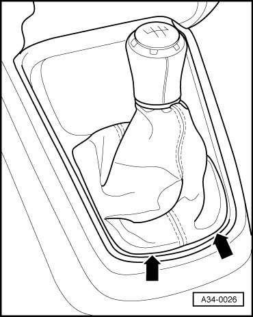

- Carefully pry off cover from upper part of center console - arrows -.
pic 4
- Pull off cover toward rear from upper part of center console.

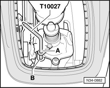

Secure shift lever as follows:
- Select neutral on shift lever.
- Guide connecting pin (T10027) through hole - A - into hole - B -.
pic 5

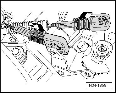

- Turn locking mechanism on shift cable and on selector cable toward right until stop in direction of - arrow -.
pic 6
The spring presses locking mechanism into initial position.

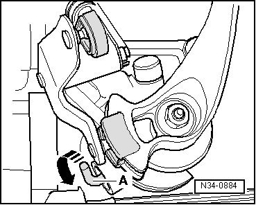

- Rotate lock bracket - A - back into initial position in direction of - arrow -.
