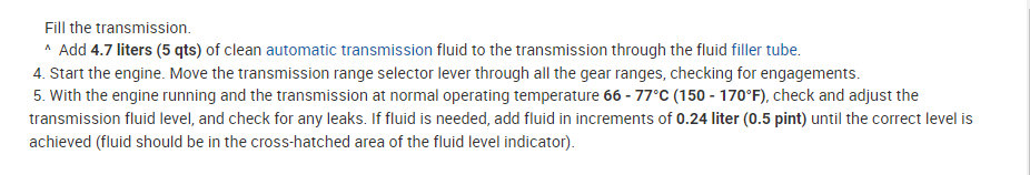

I replaced transmission in vehicle listed above and it wouldn't shift. the mechanic said I needed to have computer reset and someone said it maybe transmission and try reset. Now, I talked to mechanic at Mr. Transmission he said that I don't have to flash it. that I don't have the kind of transmission that need it. so would do you think? I need to flash it to see if it shifts because I don't want to waste $90.00. And do you think I can drain it and try the Lucas first?

If all you replaced was the transmission then they are correct that you do not need to program anything for this unit.
Did you replace the transmission for this issue and it did not change it or did you have this issue only on this transmission? In other words, why did you replace the unit? Also, where did you get this transmission from? Was it a new unit or did you get it out of another vehicle?
We need to check the fluid and just make sure it is correct. I attached the process.
Let's start with this and go from there.
