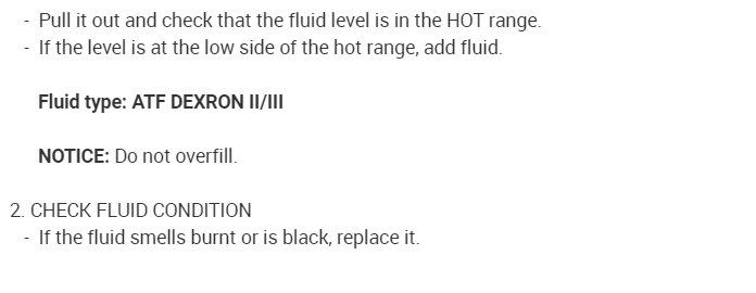

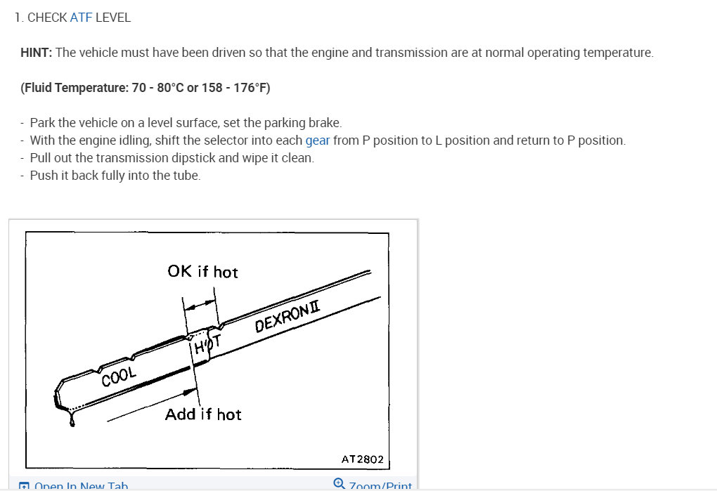

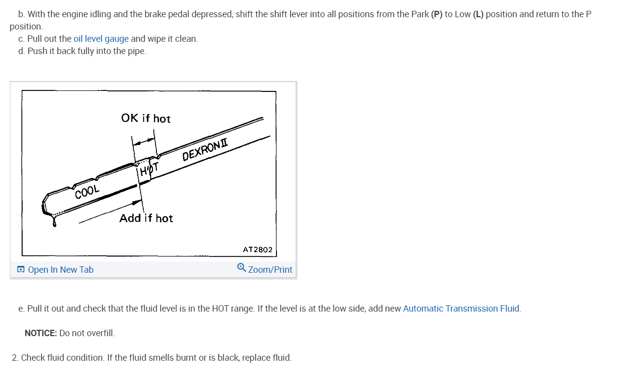

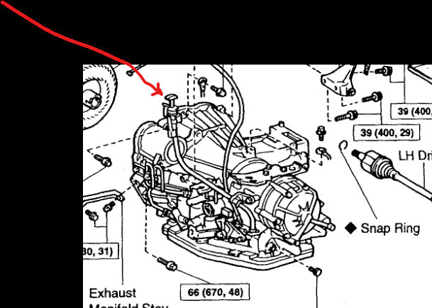

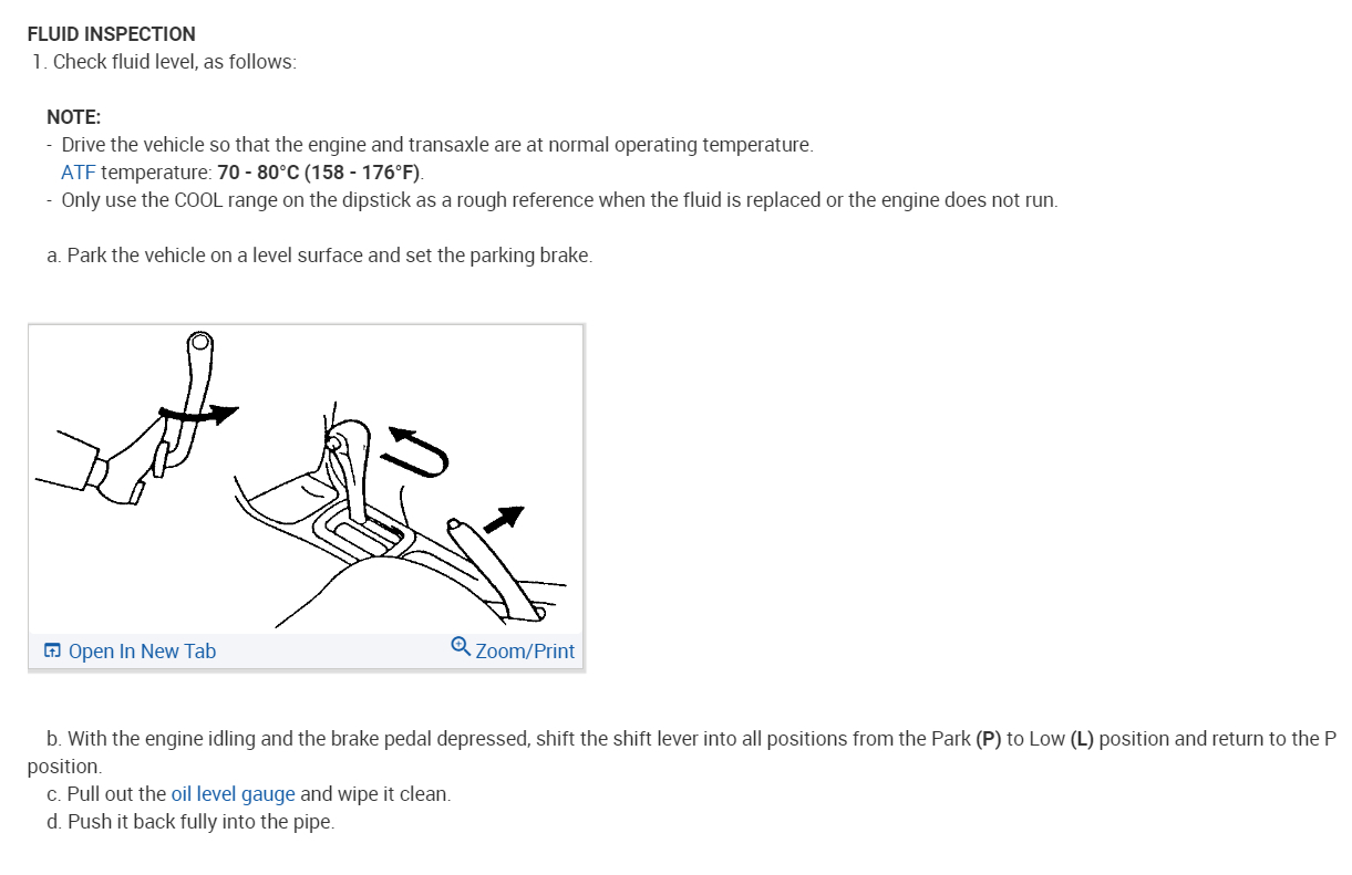

I would check the transmission fluid first here is a generic guide to help you with the steps and instructions in the images below to help you check the fluid on your car.
https://www.2carpros.com/articles/how-to-check-and-add-transmission-fluid
Fluid Types
AUTOMATIC TRANSMISSION FLUID
Fluid type: .................... ATF D-II or DEXRON III (DEXRON II (r)

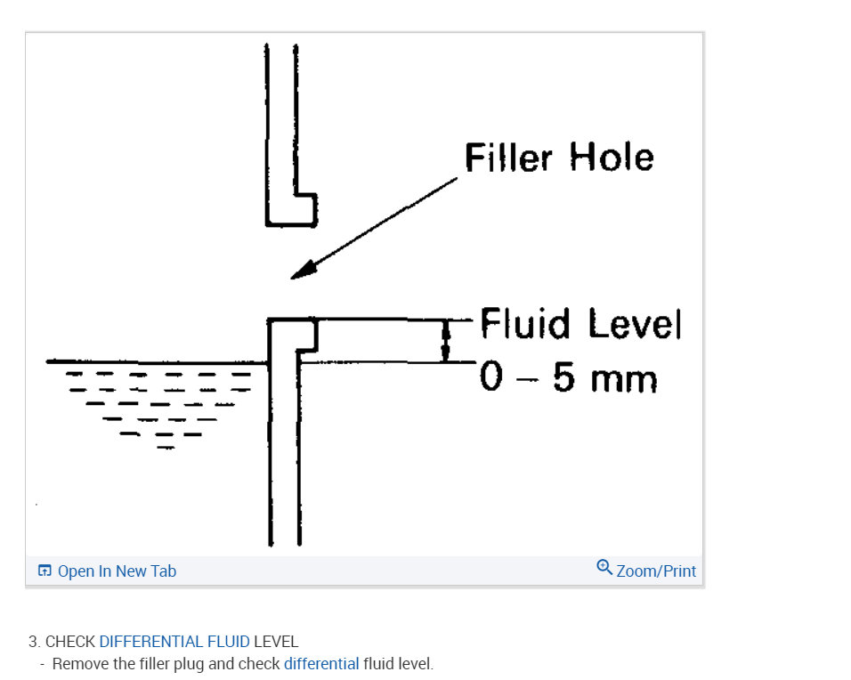

DIFFERENTIAL FLUID
Capacities
Capacity:
Dry Fill: 5.6 liters (5.9 US qts, 4.9 Imp. qts)
Drain and Refill .................... 2.5 liters (2.6 US qts, 2.2 Imp. qts)
DIFFERENTIAL FLUID
Capacity: .................... 1.6 liters (1.7 US qts, 1.4 Imp. qts)
If the fluid smells burnt, you should change the fluid out
